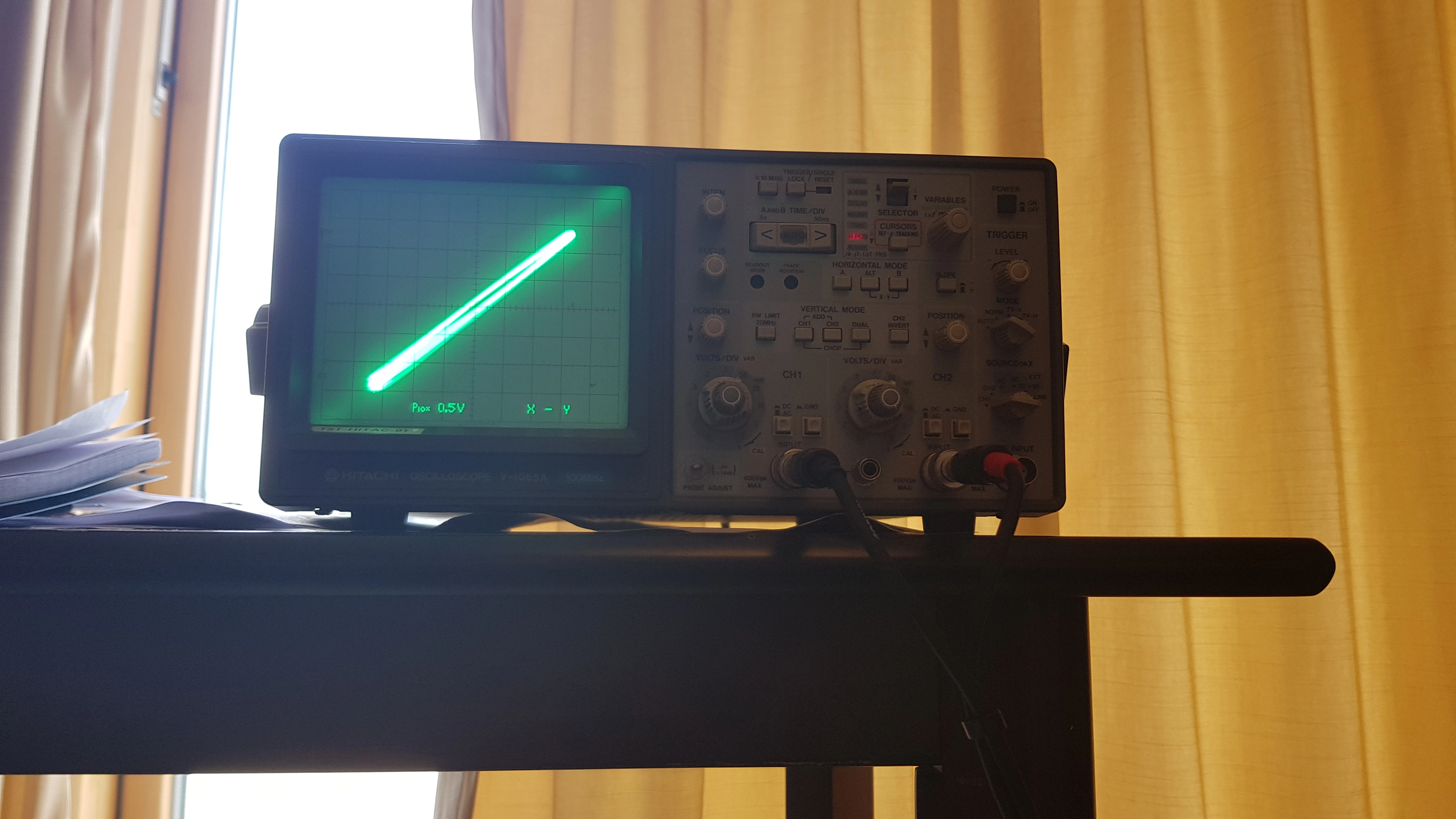

I started my calibration process today. After cleaning the tape path with IPA I spooled up the calibration tape and set the azimuth for the playback head using the scope in X-Y mode to monitor the output of both channels on the machine. Using the 10kHz and 12kHz tones I got it into pretty good alignment

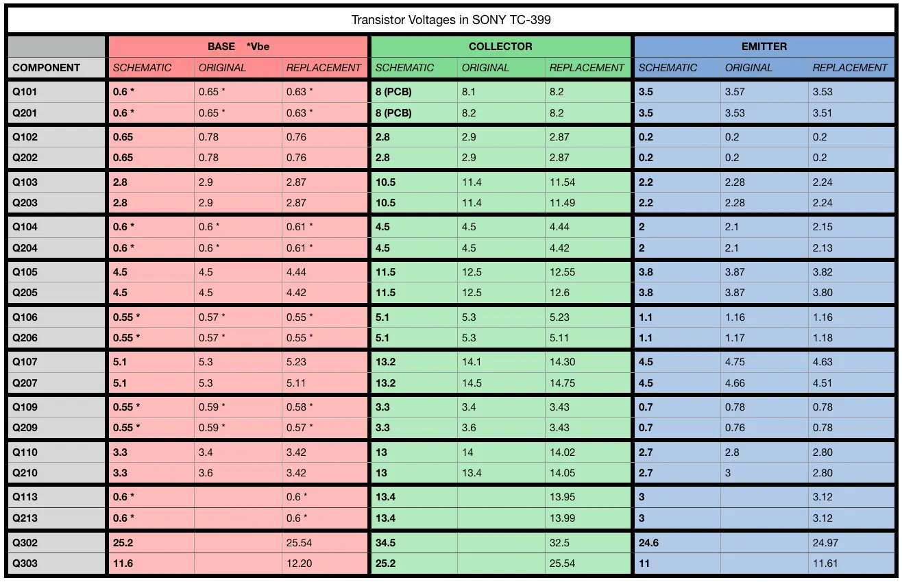

OK, here's what I've found...... The image below show's the voltages for each leg of the transistors that I've swapped out, according to the schematic, the measurement of the original transistor and the measurement of the replacement transistor
There are 4 that I don't have measurements for the original transistors that got replaced. Do you think the voltages measure within tolerance? I imagine they didn't need replacing in the first place! :facepalm:
The reason I changed them was because of reading about transistors failing in these models (TC 366, 377 and 399).
Also I do still physically have the original transistors.
What I found strange is that I have a few conflicting things going on - the schematic says that certain transistors are of a certain type (eg. it says Q104 is a 2SC458 but the electrical parts list in the service manual says Q104 is a 2SC1345 - which it physically was). The electrical parts list also has all the ones that I changed listed as 2SC1345 but some of them physically were C945. Unfortunately I didn't take note of where the C945s were removed from as I presumed the electrical parts list to be correct and proceeded to replace all of those listed as 2SC1345s with KSC1845s.
Also on the schematic it says the voltage at the collector of Q101 and Q201 should be 11V but on the actual PCB there is a print with an arrow showing it should be 8V (which it measures) so perhaps the schematic I have is from an earlier version? Maybe there was a revision? I really don't know. I'm taking what's written on the PCB to be accurate in that case.
Anyway, what do you reckon about the measurements that I've shown above......
Dan

Hi Dan, Sorry I did not get back to you after that marathon voltge table! I had to go for my monthly eye check and the drops leave me blurry after. Better now.
I WAS going to say, all those values look ok except Q113/203 where you have a 2.5ish b/e voltage differential. Cannot be, Silicon transistors have Vbe of 0.6.to 0.7V. But, you are up and running so no matter.
Treble loss: Run the test tape and yes, set the azimuth. If that does not deliver on spec treble you might have a worn head.
.....values look ok except Q113/203 where you have a 2.5ish b/e voltage differential. Cannot be, Silicon transistors have Vbe of 0.6.to 0.7V.
Thanks Dave, care to explain to me as I'm a complete newbie to this?
