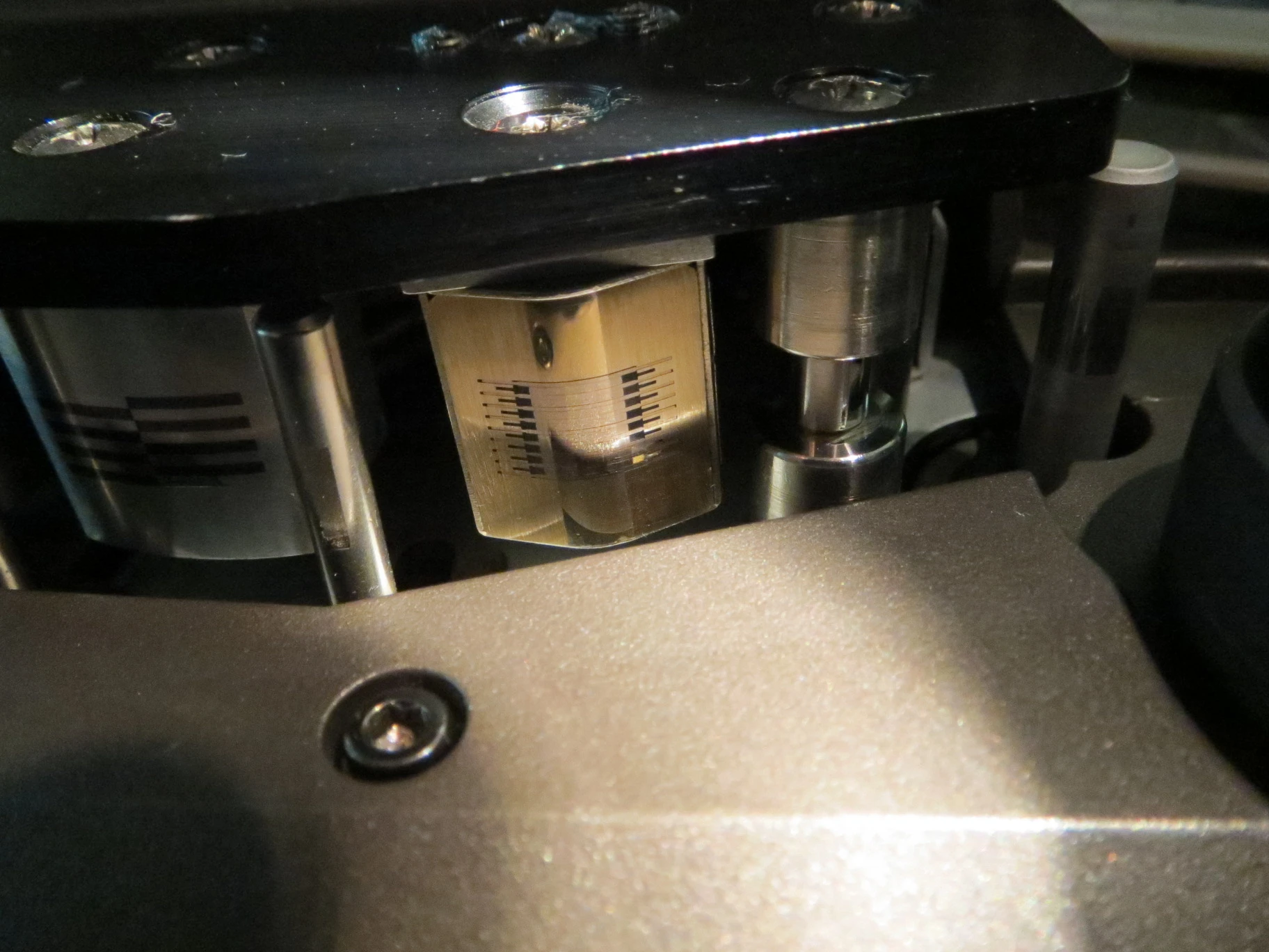

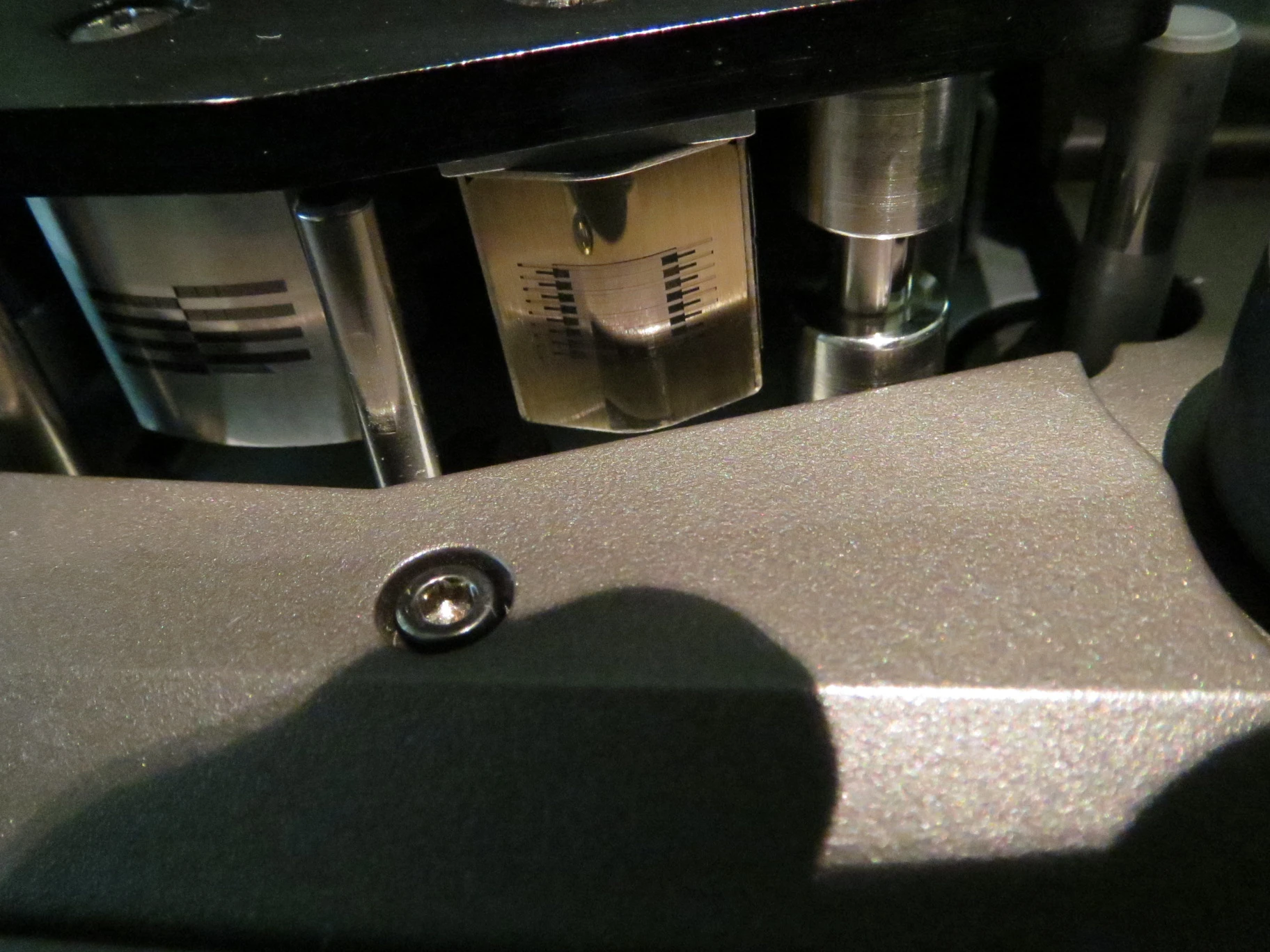

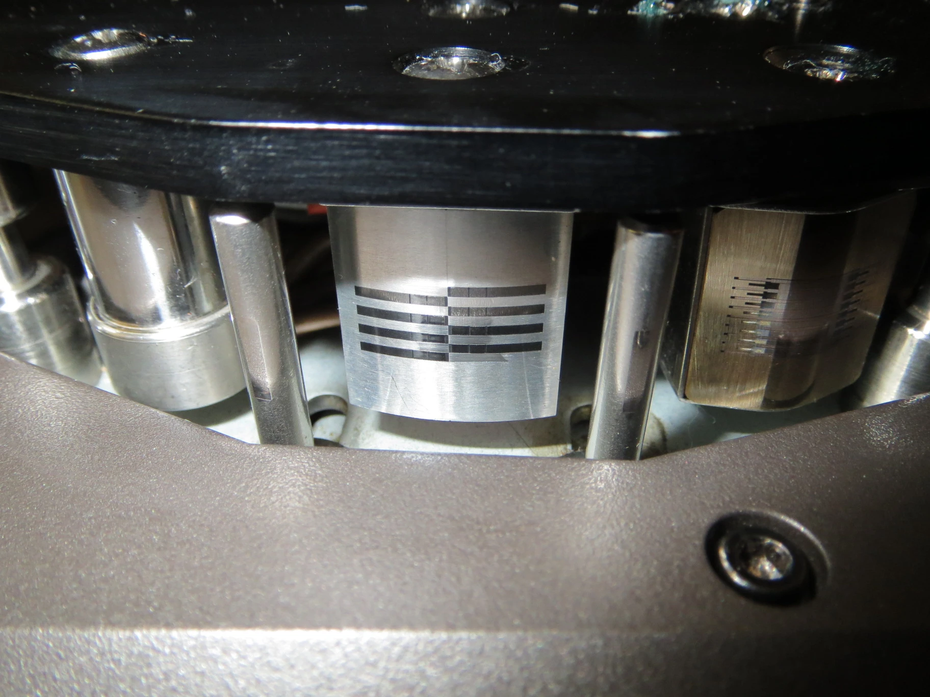

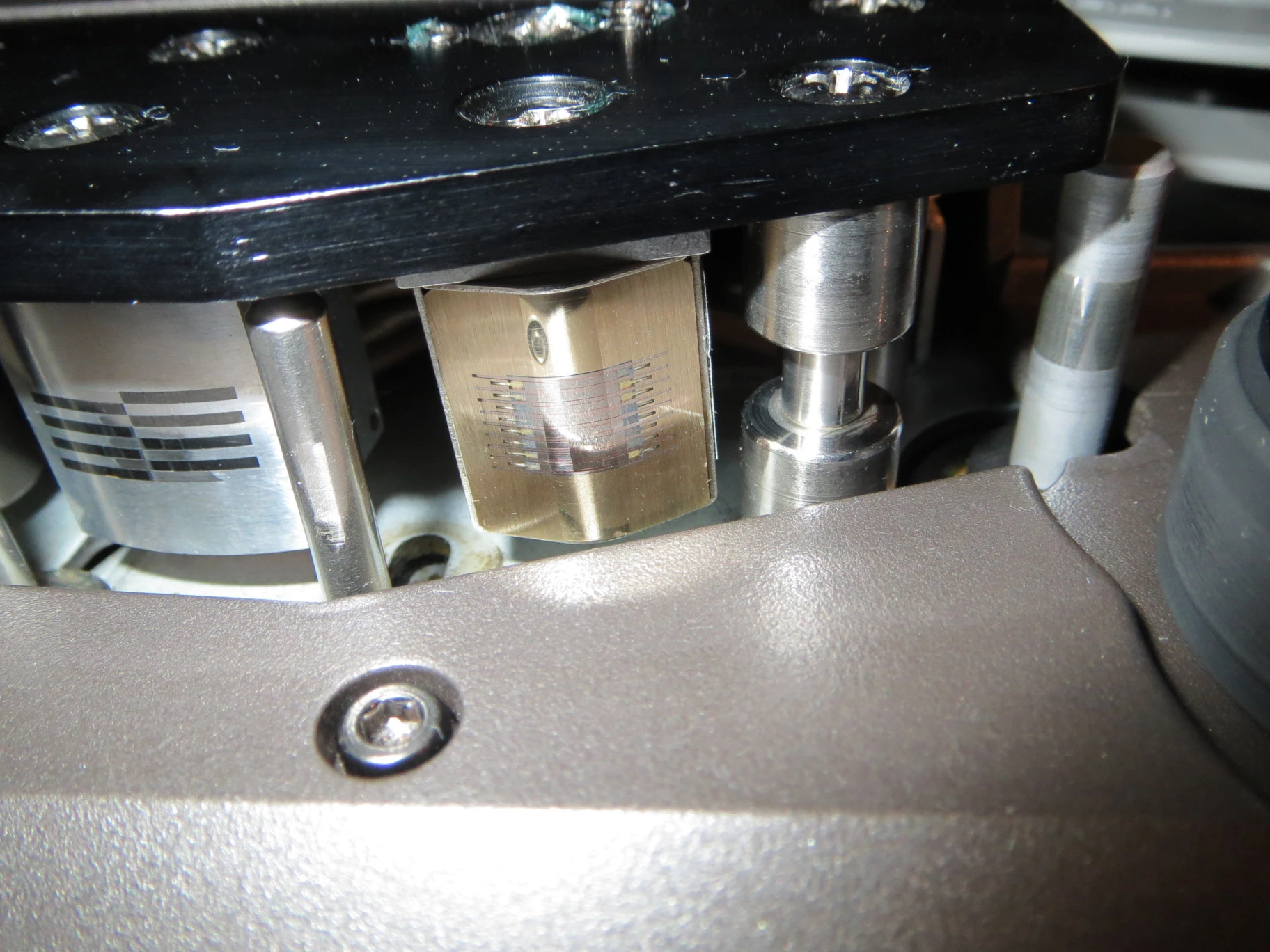

They said they did do a complete recalibration. I'm not sure about the bias traps....?They also would have to do a complete recalibration,including the bias traps, after the head was re-lapped
I do see what you mean about the fixed guides. There is a notch. Should that have been done with a recalibration normally?
Realy? Wow that sucks for me. Yea I asked the Tascam repair guy in Montebello about it today and he said "next time we get it relapped he will rotate the fixed heads".....what the?Is there a notch in the head the width of the tape?Or is it smooth from top to bottom?If the head block was removed-it had to be if the head was re-lapped-it would take maybe two minutes tops to rotate the guides.
