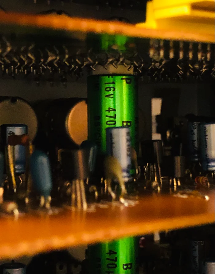

I HAVE SOLVED THE MYSTERY!!!
I think You should know this issue, because You must have definitely encountered it before. I have followed Your “Tascam 388 Story” thread some years ago and I have seen that You were using the same capacitors as me.
So, I started by following Your guidance to record a test tone to a blank section of the tape by using TEAC TO-122A to record a 400Hz signal. While reproducing the 400Hz signal, the measurement from P117 (Pin 1) was 0.280V and P217 (Pin 1) was 0.001V. To my understanding these readings were as they supposed to be.
While doing this test I have encountered the biggest clue of this whole story... During playback of the 400Hz Test tone, I have noticed that the Track 8 "OL" bulb was shining red and the Input section was set to "Mic", not "RMX". But there was nothing connected to Track 8... If I have switched it to "Line" or "RMX" the light would turn off and If I would stop the playback, the light would go out as well if it was set on "Mic".
I have plugged the headphones right away and tried to listen if there was anything audible. Yes, it was!!! During playback, even if there was nothing on the tape at all, if the Track 8 was set to "Mic" there was a very strong signal. Switch it to "Line" - much weaker one, switch it to "RMX" - nothing. If I would stop the tape - dead quiet on "Mic", "Line" and "RMX".
My immediate thought was - THE C111 CAPACITOR on the Input (8) PCB must be touching BUSS A PCB!!! Nichicon (MUSE BP) capacitors are slightly bigger than the original ones. Even tho I have used the same cover for it and to me it looked like a sufficient distance to protect it from touching the PCB above, it clearly wasn't. So I took the Input (8) PCB out, placed a proper barrier on top if and now I have all 8 Tracks working flawlessly!!!
It's definitely the only spot on the Tascam 388 that a short could happen due to the distance of the components. There's plenty of room anywhere else on the 388, but as You know - it's a pretty tight fit over there.
Now we know what EXACTLY happens if C111 is touching the BUSS A PCB.
Thank You for Your time : )
Fascinating. What exactly happens when C111 touches the BUSS A PCB would depend on exactly it is touching. In your case it propagated the pre dbx processing track 1 reproduce signal to the track 3 channel. C111 is the repro level trimmer output coupling capacitor. From there the signal goes to the dbx assembly. So, depending on how and with what the cap comes in contact, in your case the post-repro level trimmer signal contact something that is in the track 3 reproduce channel path, and early enough the signal could feed back to where the signal branches to the input section and TAPE OUT jack. I expect that if you used noise reduction on your track 1 recording, the signal bridged to the track 3 channel would have healthy signal level but would be noisier as the dbx decode operation would not be applied.
Yes. It is important that stuff that wasn’t touching other stuff continues to not touch other stuff after we work on it. Consider yourself lucky. The outcome could have been much, much worse. I might be speaking from direct experience.
