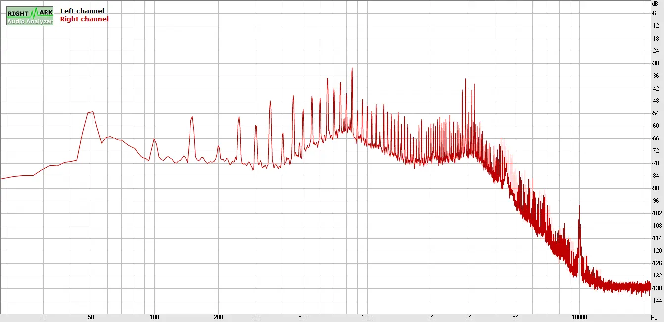

If you post a 10 second clip of the noise (JUST the noise, playing critique is another dept!) I can run it through Right Mark Audio analyser and find the actual frequency. Of course you could download the free app' and do the same.

Nizhny, why did you say "60Hz hum" in your first post? *
The attached spectrum clearly shows a dominant 50Hz component then 100Hz then a mid band mess. The latter is due to the fact that amp sims can use enormous DIGTAL gains without the constraints of hiss and microphony associated with analogue electronics.
No free lunch though because it still amplifies all the crap from the guitar that it picks up from the 'ether' !
Re the hand, hum string thing? I would intuitively think a properly shielded guitar WITH the strings bonded to the bridge AND the bridge bonded to jack earth would not hum differently whether touched or no. IF this is the case I would be suspicious of the quality of the equipment or/and mains earthing?
In the annyloggy amp world you can have an amplifier that has a very respectable signal to noise ration of 50dB below full power (that's bloody good for a valve gitamp!) but switch in the OD channel, if it has one, and this can degrade hugely to worse than 20dB below FP. Fact of electronic life I am afraid. Plug in a guitar and things all go to H in a pram!
I said 60Hz hum because it's a well known problem guitars with single coils have. But in my case I don't think it is, because switching to the "humbucking" in-between position doesn't solve it (although ashcat pointed out that the middle pu could not be RWRP).

Geographically. You can only get SIXTY Hz hum and its harmonics in US (and a surprisingly few other places in the world) . Your noise, as you can see, has 50Hz hum.
