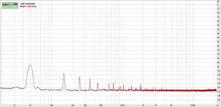

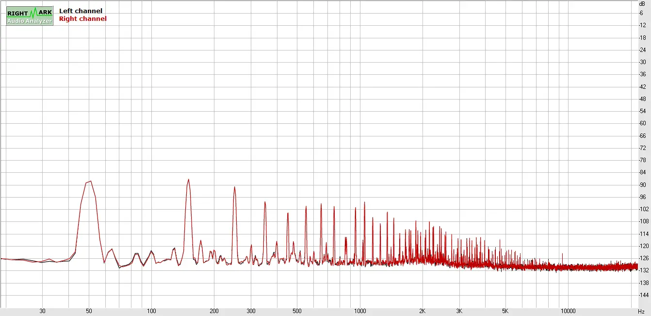

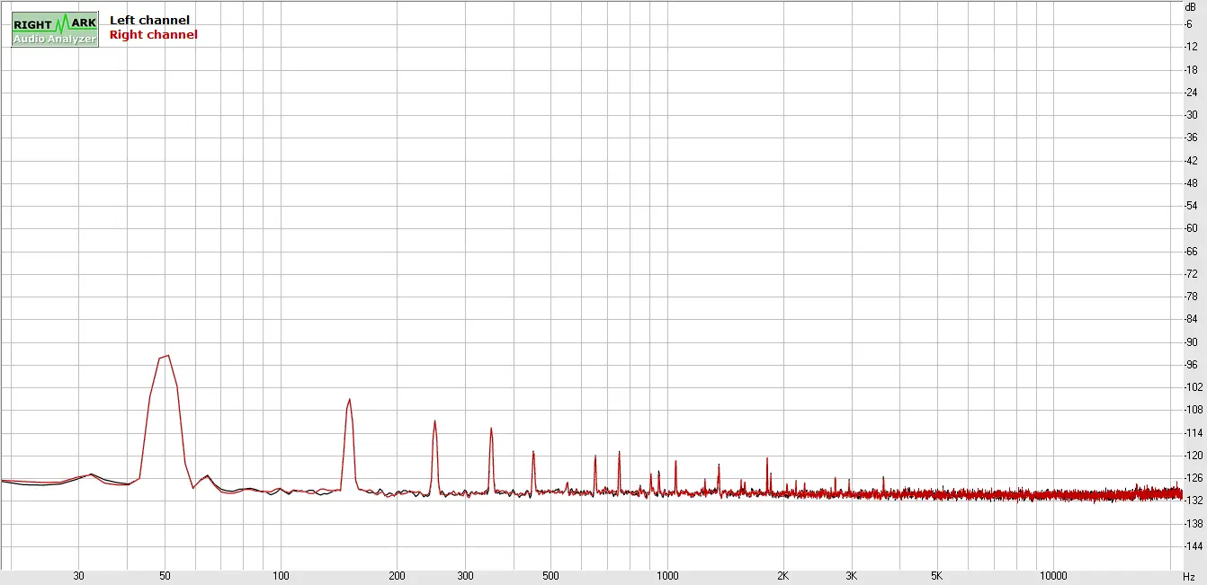

Got up early to do some tests..
Guitar, Chinese 'Fender' Tele. Kit, A&H ZED10 (HZ input) 10mtr Neutrik supplied cable with 'Silentplug. Mixer feeds balanced out 5mtr XLRs to traff box which feed a 2496.
Daw Samplitude SE8. Level best I could manage, mid neck full 'A' strum with nails set gain to peak -10 dBFS (mono mix) Git pots full, zed chan level '0' zed Main Out '0' Pulling plug from guitar (short at end of cable) -82dBFS pk -91rms.
Front pup best orientation -71pk -83rms
ctr " " -75pk -85rms
brdg pup " " -67pk -80rms
The guitar was in my hands and the chair centre some 880mm from the PC and 1400mm from the mixer. These were the only powered devices in the room.
I then parked the guitar in the porch some 5mtrs from mixer etc. -75dBFS pk -87rms. Clearly the further you can get from house 'lektrik' the better! There is also clearly some phase cancellation going on.
The spectrums show the guitar to be far 'dirtier' than the mixer baseline noise* The less than stellar hum performance of the system is a known foible, does not impinge on any 'real life' recording. 'A' weighted noise would be a good 6dB lower.
If I have a chance I shall repeat some of the tests with the KA6 and a laptop on battery power. I would not expect much improvement in guitar noise but baseline should be better.
*Do NOT think that the system noise is anywhere near -130dB ! That is a function of RightMark analyser, graphs for comparison only.

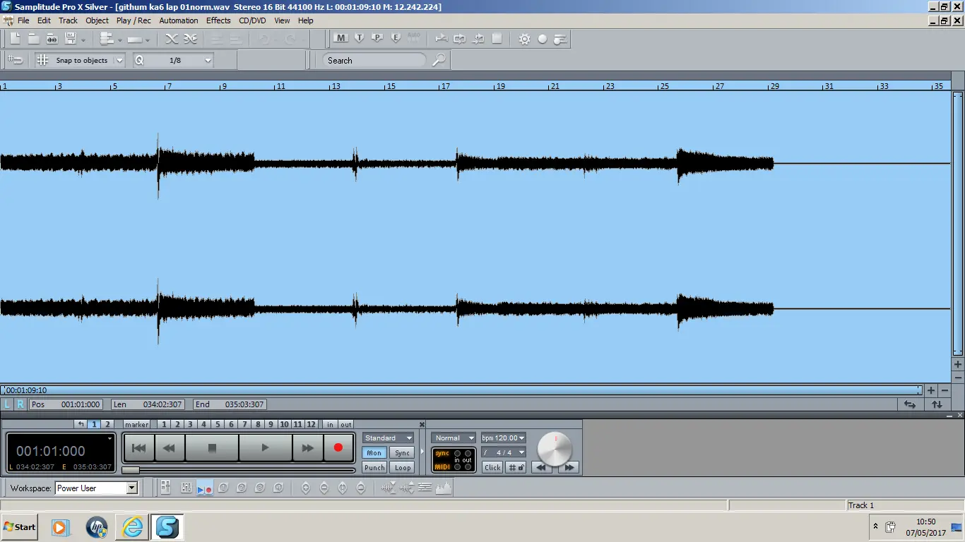

Attached are shots from my KA6.
Same baseline 'A' hitting around -10dBFS in Sam SE8. The signals have been boosted digitally by about 40dB. They progress from the neck pup, switch centre and bridge pup and finally the noise of the KA6 with the plug pulled from the guitar.
The 'clang' heard about 1/2 way through each clip is me VERY carefully putting my hand on the strings. I personally cannot hear or see any change?
OP: The harsh nature of the sounds is just what you get with an amp sim because of the massive boost. You get something similar with high gain pedals but they usually roll the HF off a bit to cut the edge.
