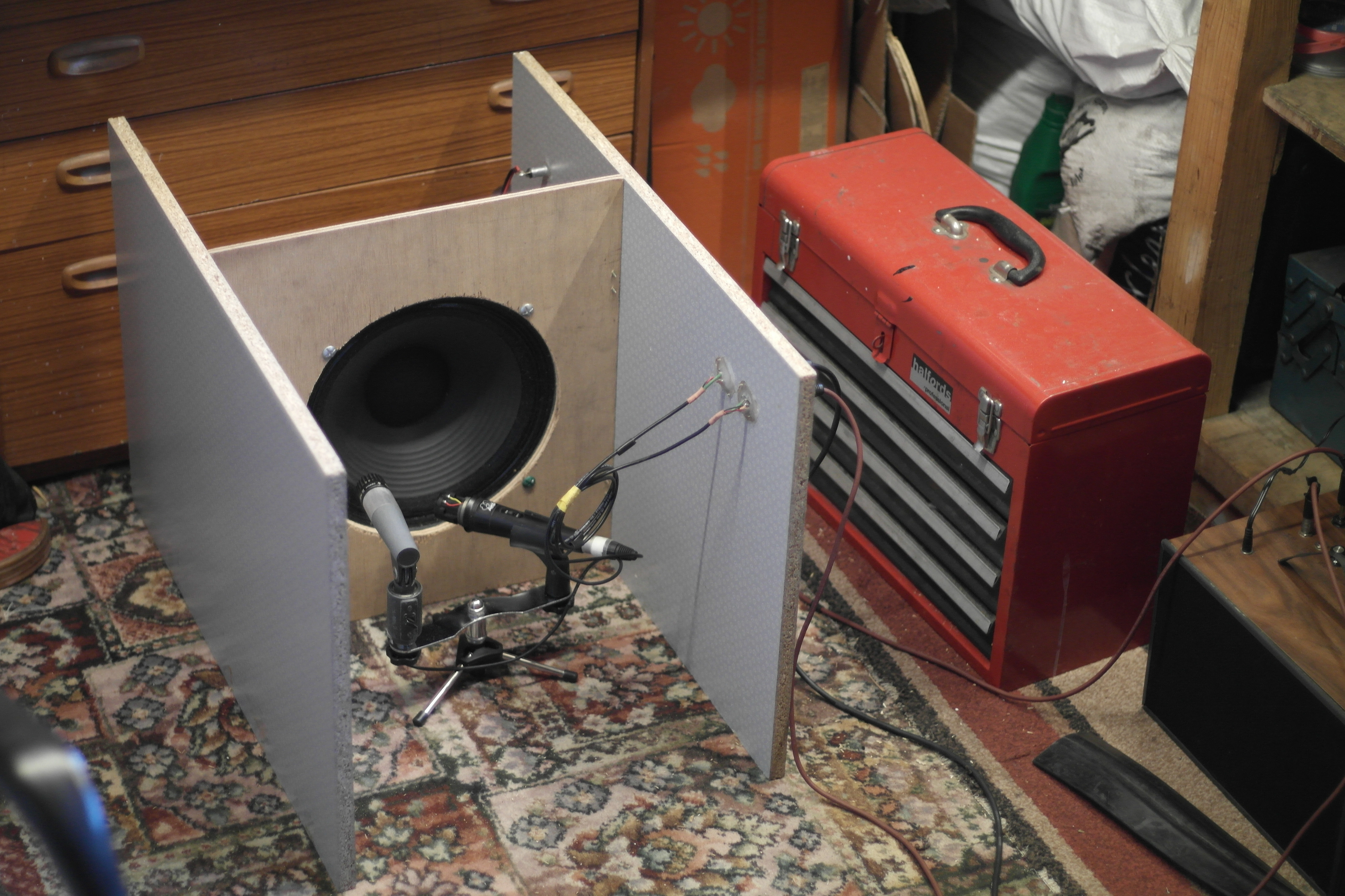

No real plan. It's just gona be a tight fitted box, siliconed along all the joins, bucked in a pit!
The pit's about 6'x6'x3' or so and the boards which cover it are about 2" thick.
I think/hope it'll be enough.

So the pit itself is actually the iso box, what you're building is a closed cab. Am I imaging that correctly?
No. In the picture (did it show up ok?) you have two sides and a divide with the speaker on it.
I'm gona put top+bottom, front+back on that, seal it up, and that's my iso cab.
The whole thing is gonna get thrown in the pit.
Right, I guess this is just semantics, but that's not really an iso cab. It's just a closed cab being placed in a pit. It's sort of like a traditional iso cab, but you haven't said if you're adding any sound control inside of the little cab. The pit itself is providing your isolation if ambient sound control is the goal. The little cab itself will still be pretty loud, it's just gonna be kind of sealed off in a pit. Theoretically, a typical iso cab wouldn't need to be put in a pit because the cab itself would provide the outside attenuation you're looking for..

I'm pretty much building the same thing as minerman did.
The mics will be contained inside one half. I'll probably line the insides with some kind of insulation if I happen to find some.
Ah, I see what you mean. That makes sense.
I'm doing what you pictured, give or take.
