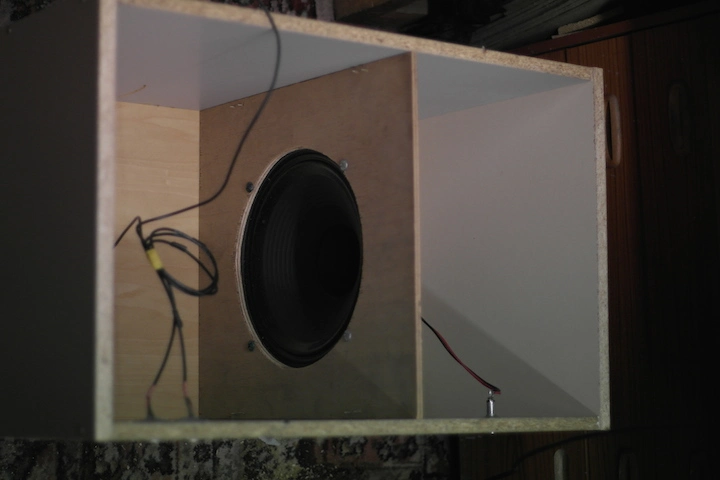

I'm not ignoring your advice but this is being made out of left over cupboard sides and scraps, so the size is predetermined. (27"x18"x18").
I'm keeping in the back of my mind that it might suck though, and if it does I'll spend money on a mkii and do some proper research into dimensions and materials.

I got the box built yesterday folks. It's doing its job....just.
It doesn't rattle or buzz which is a good start and it certainly takes the edge off.
I hit it with silicone last night which will help a bit and I'm going to order up some insulation batts soon.
I had them ordered up but, unfortunately, the place cancelled the order due to unexpected high shipping costs.
I'll just pick some up at the local hardware store.
I think once it's insulated and interred, it should be pretty useful.
If I can get it I'm going to have 4-5" batts on the inside of every surface.

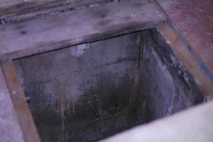

Awesome dude. Take some pics. I'm curious as to what this pit looks like.
It's carpetted over so I'll only be opening it up with everythings 100% finished.
I'll take pics though, for sure. :)

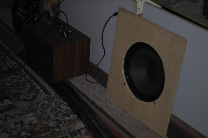

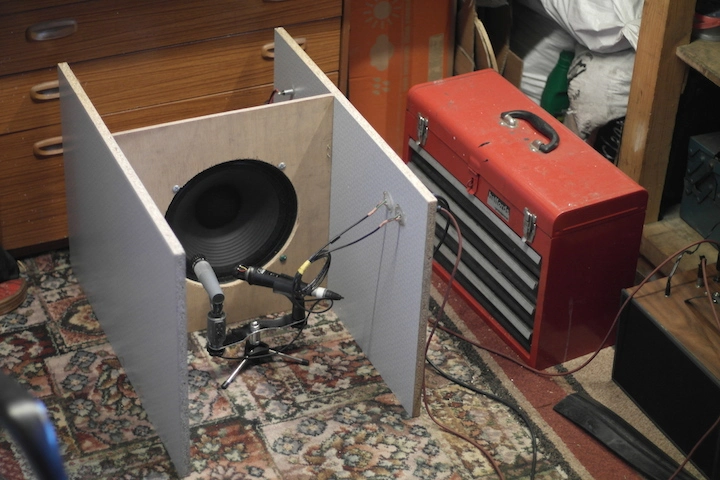

Sorry folks, I didn't get many super exciting pictures. Here's what I have anyway.
There was a bit of a wait because I ordered insulation and the company cancelled over prohibitive postage fees.
Right now there's no insulation but it's still doing a reasonable job.
I'll get some and fit it soon.
The last pic is just to satisfy Greg's curiosity about the pit! :p
It's not very good. Sorry about that.
