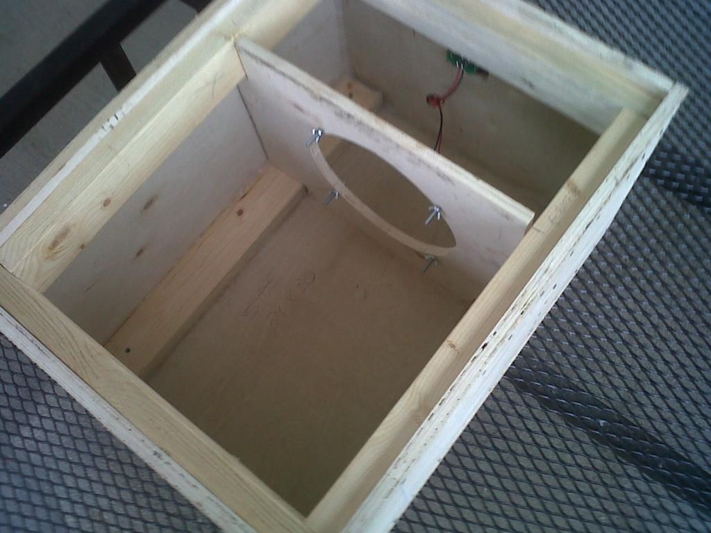

Well, I finally got around to building my inner box today, I haven't tried it out, I'm waiting for the caulk to dry, but I'm pretty confident that it's gonna cut the noise even more....I've made the baffle so I can change speakers pretty quick if I wanna, & the total cost for today's build is about $75 or so....sound clips to come....
Here's a few crappy pics:
And the best bit, any burgular trying to lift those boxes gets a slipped disc and hernia !

Yeah Grim, the bastard is heavy, it was a pain to put the inner box inside the outer, but it's there, & it did cut the noise some more, so I'm pretty happy to be honest....yeah, it looks like shit, but it was cheaper than a Randall or Jet City ISO (that would've had to be modified/worked on to be as quiet I think...), it sounds pretty good (throught the daw of course), & I can swap speakers out in a matter of minutes....

it was a pain to put the inner box inside the outer, but it's there, & it did cut the noise some more, so I'm pretty happy to be honest....yeah, it looks like shit, but it was cheaper than a Randall or Jet City ISO (that would've had to be modified/worked on to be as quiet I think...), it sounds pretty good (through the daw of course)
I'm with you on the weight thing. When I blocked and decoupled with all that foam, I got my little brother to help me lift the inner box and it felt heavier than the outer one !
As for the look, who cares ! It's there to do a job and by the sounds of it, yours is doing just that. For those that like to mic their amps but have to take into account neighbours and family, these kind of things really make a difference. I remember one of the questions that was raised when I was looking into building one was "won't it make the guitar sound boxy ?". If it has, I haven't noticed.

Yes, this home-made ISO does make a huge difference for me, without it, I'd be limitied to when I could play/record, now I can play at 3-4 a.m. & not bother anyone, which is the whole reason I built this thing....
My inner box is definitely heavier than the outer box, but it's got 2x4" bracing, it's made out of 3/4" birch ply, & is just built better/sturdier to say the least.....
