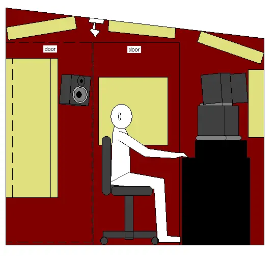

pandamonk, does the dashed line on the back of your absorber represent a wood panel? also, why aren't you covering the corners at the wall/wall junction behind your monitors. i'm just curious of your acoustic treatment ideas.

I think i definitely could make use of the 16. I was planning 32 before, but realised it was a bit much, so cut down to 16. The dashed line represents the 1"x1" wood frame. There isn't enough room to cover those corners. The room's only 6'6"x7'6". I will cover the wall/ceiling at the back, and possibly the front, if it'll fit.
This is the side view. Is there much point in the panels staddeling the wall/ceiling corners?
