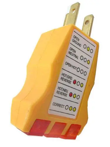

Also, have you checked your room for proper grounding and polarization of the AC outlets? AC receptacles should be checked with a tester you can get from Radio Shack or a hardware store.
That was the first thing I did last year when I bought this house. All my recording gear is on the same circuit.
