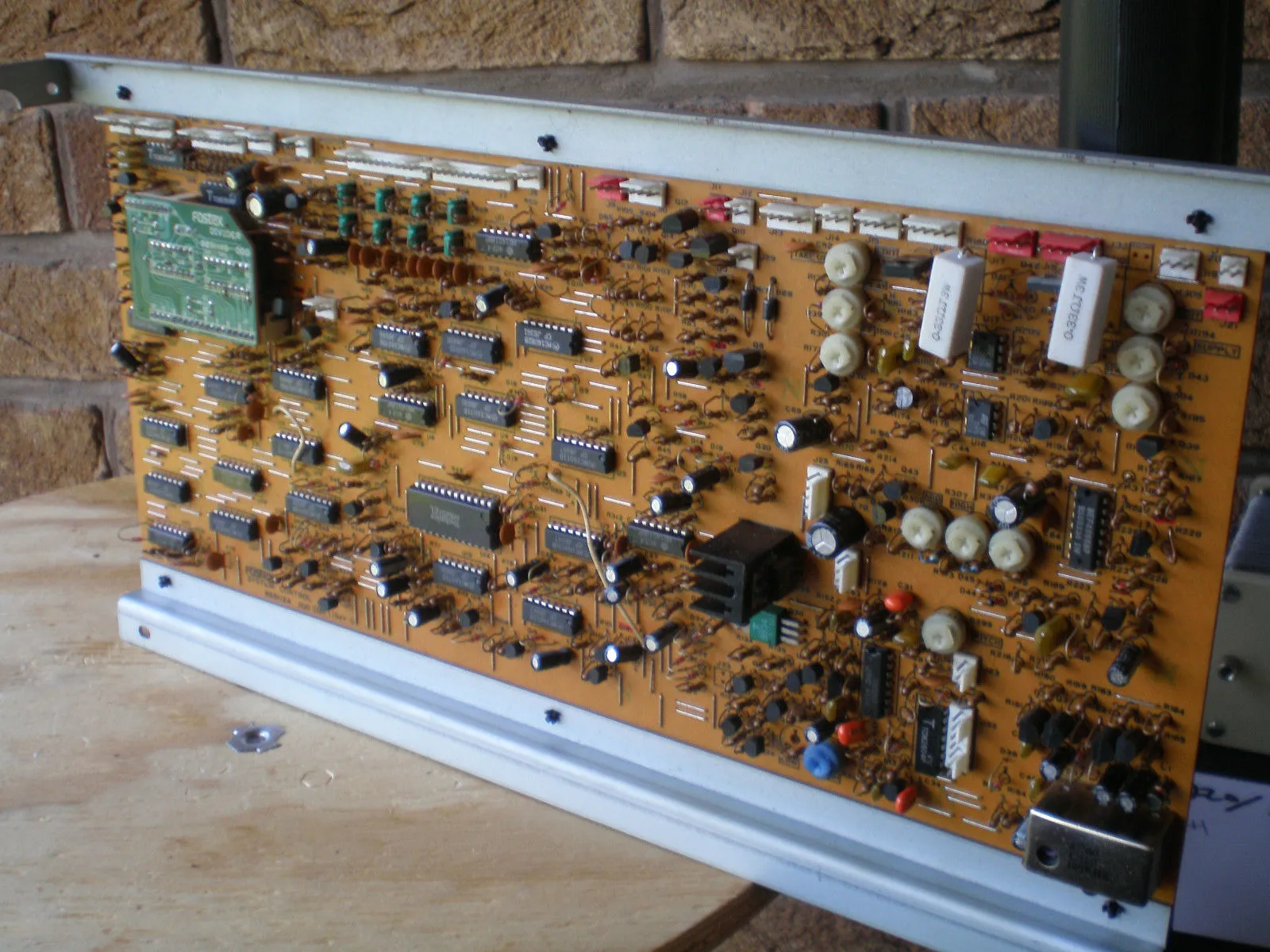

In addition the schematics don't seem to be readily available for the B16.
The closest I can find is the image of the motherboard off ebay that I'm attempting to attach. As an educated guess I'd say it was the circuit in the bottom right, with the metal can. Looking for a test point and hooking an oscilloscope up to it is where I'd start if it were my tape deck. It might even be something as simple as the capacitors having dried out.
The other candidate is the daughterboard marked 'DIVIDER' which sounds it could be some kind of clock divider, though that would be even harder to troubleshoot without schematics.
So. What can you do?
One last thing to try might be to take a quick video of you attempting to record, showing the inputs with signal and then the playback. If it is operator error hopefully someone will be able to see what you're doing wrong.
Otherwise, your options are to find an electronics tech willing to have a look at the machine - or, depending on how desperate you are, snatch up that B16 control board off ebay and pray that it fixes the problem.
(Source: Fostex B16 main control pcb part number 8251124-200 | eBay )

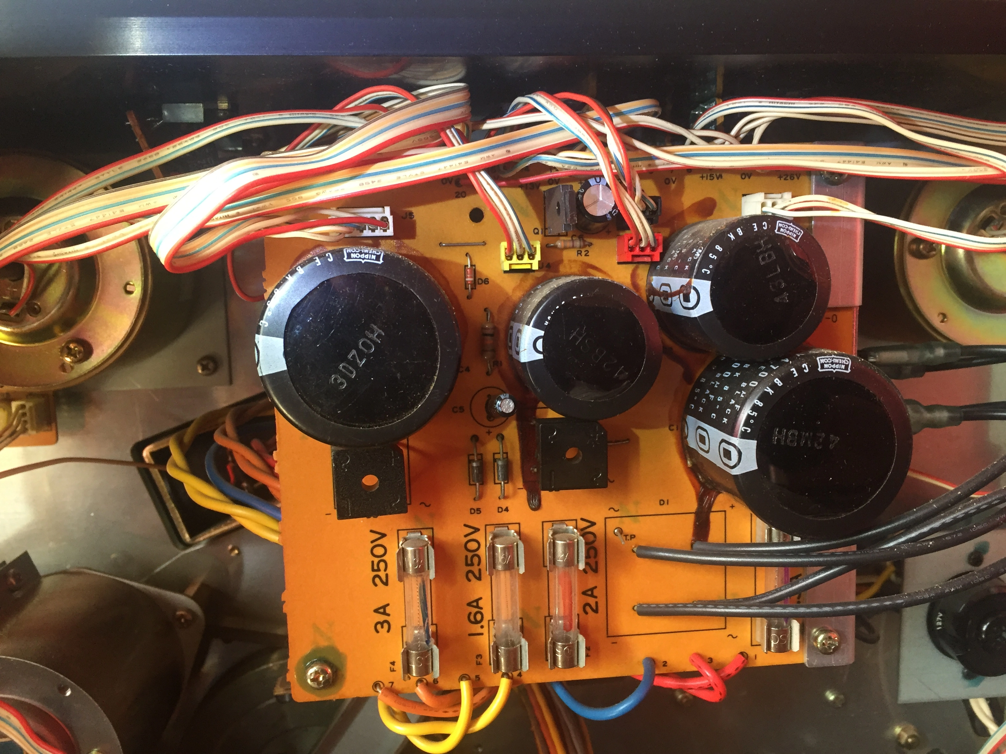

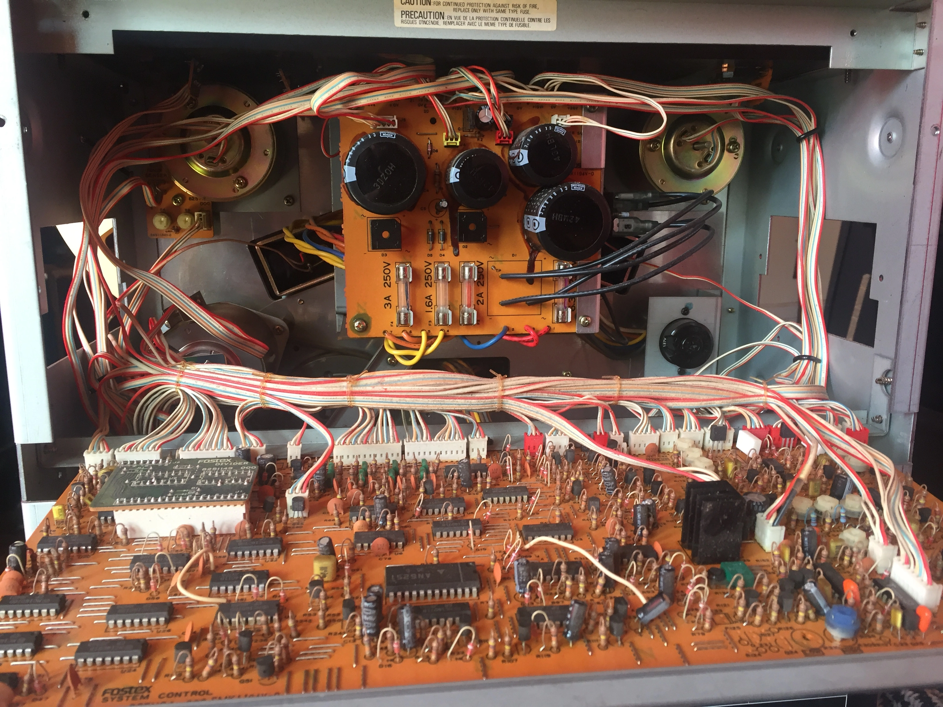

Hi , I believe I am having the same exact issue with my B16 as the person who started this thread. Everything turns on and mechanically seems to work as it should but I'm getting no audio signal running through the machine. No playback from tape, no record levels. I plugged an ipod into one of the inputs and and from the output I plugged into a mixer... when I cranked the gain I was getting a very very faint signal of what I was playing on the ipod. Could this also be the voltage regulators?? I've opened up the machine and the 4 visible fuses look ok. Can someone please point out where the V reg's are... I have no idea where they are located or what they look like. Any help would be very appreciated!
I've attached images of the inside of the b16
