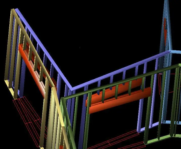

OK, so I had Electrical, Mechanical, and Framing reinspected.
The Electrical and Mechanical passed!!!
Now, to get the framing signed off, I have to install firestops between all the adjacent interior walls.
What this means, specifically, is at the top of 2 adjacent walls, (like between the CR and the Drum Room) I have to put up a nailer, and then fit in some 5/8" drywall in there. Supposedly, this keeps fire from entering the "attic" should it start between the walls.
This will "link" the 2 rooms. :(
I guess I have to do it, just to get it signed off. I suppose I could go back and cut a slit down the middle of it, after its signed off.
Seems like a lot of trouble. :mad:
Here's a pic:
Imagine fitting a piece of sheetrock, at the top of the wall, like between the blue wall, and the green wall, and the brown wall.
Its a tight, confined space to work in, but it can be done. I'm not worried about physicalyl constructing it, I just don't want to link the rooms together like that.
Any alternative ideas?

Maybe if you explain the detrimental effect that solid blocking would have on your design he might accept an alternative to solid blocking- like maybe stuffing the cavity with mineral wool blankets- not-so-solid blocking- Prob. not- but its worth askin. It'll accomplish the same thing and the spirit of the code is left in tact!
Rockwool is not fire rated to one hour. 5/8" drywall is.
I don't want to circumvent the code, and cut a slit through the drywall, so I was hoping there's an alternative.
But when its all said and done, I'll do what I think is necessary to maintain isolation.

I don't see any way that's gonna allow you to get away from coupling at least one set of walls to the roof trusses. Does it necessarily have to couple ALL of the walls in order to satify the inspector?
Maybe there's something that will allow you to drywall from the top down to NEAR the top plate of the walls, and fill in the gap with a 1 hour fire-resistant material that is flexible, providing at least some de-coupling while complying with the inspector's wishes.

Michael Jones said:
Here's a pic:
If you have the studs fastened to the floor/concrete then you have already linked the rooms. If your worried about the drywall transmitting in plane with the drywall its not going to be as bad because the limited thickness only allows a small vibration path, fractions of a db verse 5 or 6 db. If your really concerned you can use grommets in the dry wall so that there is a slip joint and you can purchase fire retardent flexible eurethane to make bulb seals. I had to design a smoke and fire barrier that also attenuated 73 db on an airplane. I'm pretty sure the FAA is more stringent on fire in the sky. If you could find a dealer that sells rolls of the flexible eurethane you could drap it between the walls and still meet code.
SoMm
C7 - I don't know why the inspector wants this. Apparently its a code requirement, but its a new one on me too.
I've seen firestops before, but inside a wall? Only if the wall is 12' high or more, or its a 2-story house.
Typically, firestops between rooms are done in apartments, and usually in the attic, across the trusses. During the planning and review portion of this project, I had an ingress/egress assesment done by the fire department. As long as there's 2 ways out, they were fine with it.
SoMm - The walls are attached to the floor, but there's a sheet of 1/4" neoprene under the bottom; which... flattened out to near nothing.
The Drum, Vocal, and Live room walls go all the way up to the trusses. But again, there's a cushion in there.
The CR is completely isolated from the rest of the structure. This firestop would connect it to the other rooms.
Right now, as it stands, I can put my ear against the CR framing, and have someone tap on the DR wall, and not hear anything as far as sound transference.
Attach a single 2x4 across the two walls, and you can definately hear the sound through the CR wall.
I guess I could run some neoprene along the length of the nailer, but.... man, what a pain in the nalgitas!
OK, I just called my inspector. (He's really not a bad guy, and he's willing to help out with alternatives.)
Rockwool, as a firestop, does NOT meet the Local Amendments to the UBC.
But what I can do, is cut a slit down the middle of the drywall, and caulk it with a fire rated caulk. He even told me what kind to get, and where to get it.
So: 5/8" drywall with a 1/4" bead of fire rated caulk between them it is!

So he will allow you to essentially use two pieces of drywall with a bead of firestop between them to fill the gap? One piece extending from the top plate of each wall toward the center of the void, stopping just shy of the center to allow a gap for firestop goop?
Yes.
I'll put it up there as a single piece, and cut through it with a recipricating saw, then fill the gap with goop.

Michael, you might want to use something that will make a wider kerf than a recip saw - if you have ANY sway in your walls you could negate your isolation. Plus, the narrow kerf of a recip saw wouldn't give you a wide enough space to get caulking to reliably penetrate well enough to make a full bead.
OTOH, if you cut a wide kerf for a full bead of fire caulk, it will be a MAJOR mess to clean up - you might find it easier to do separate pieces and use 3/16" shims between strips of drywall when fastening the second parallel piece... Steve
I was gonna make 2 cuts to get a wide enough gap.
Trying to do 2 pieces, on angled walls, with limited work space, and a 1/4" gap... well, I'm not buidling a watch.
"Trying to do 2 pieces, on angled walls, with limited work space, and a 1/4" gap... well, I'm not buidling a watch"
True, and I'm not trying to make it harder for you - that's a lot of mess to clean up, even a thin cut makes everything white for 10 feet.
How about cutting the two pieces you need, then taping 1/4" spacers to the edge of one every couple feet, fastening the OTHER piece in place, then pulling the spacers and caulking?
Or, if you REALLY like messes, mount a dado blade in your circular saw and make one cut... :=)
