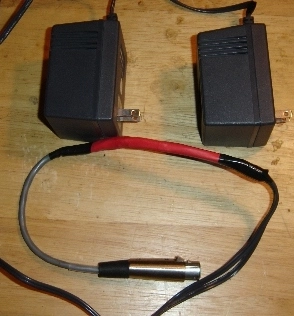

Here are my power supplies. A problem I was having with the Symetrix units was their power cords would pull out from the unit easily when I would adjust the cables in the rack. Since the power supplies used a pair of wires, I cut the ends off and replaced them a four pin XLR cable. You can see the silver connection in picture of my post above. I used the end I cut off to route the power from the chassis plug to the PCB. (I left the original power connectors on the PCB.) Now I have a secured plug going to the rack without me having to worry about bumping it and having it fall out.

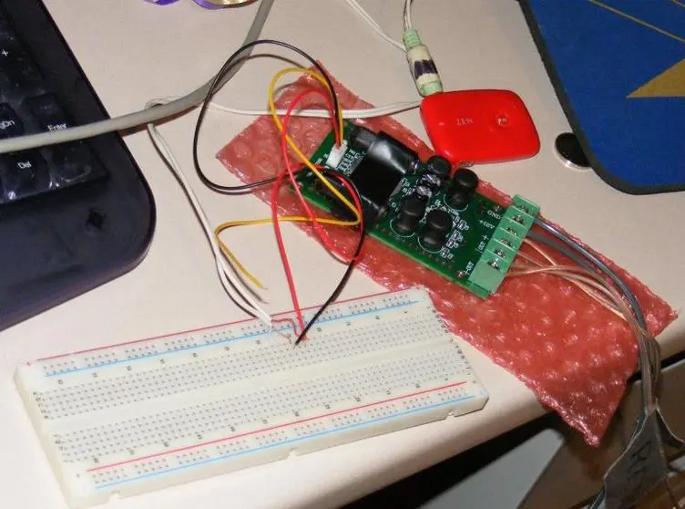

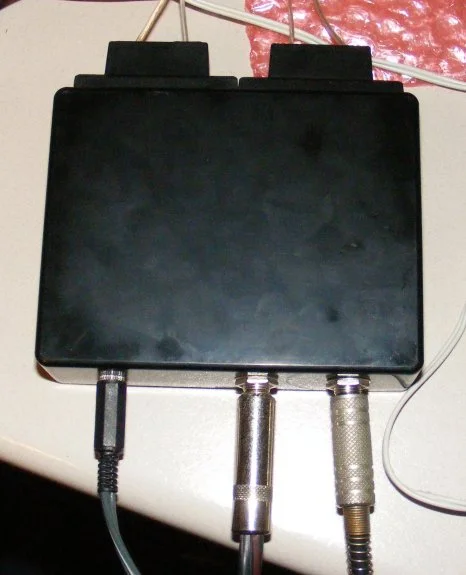

D-Class Amplifier
I put together a D-Class amp based on a Tripath TA-2024 board I picked up from a DIY'er in China. I'm using the amp to power my "monitors" (3-way home stereo speakers). Has no volume control since I connect it directly to my control room outs on my mixer. Runs on 12v power supply.
The amplifier board:
attachment.php
The enclosure:
attachment.php

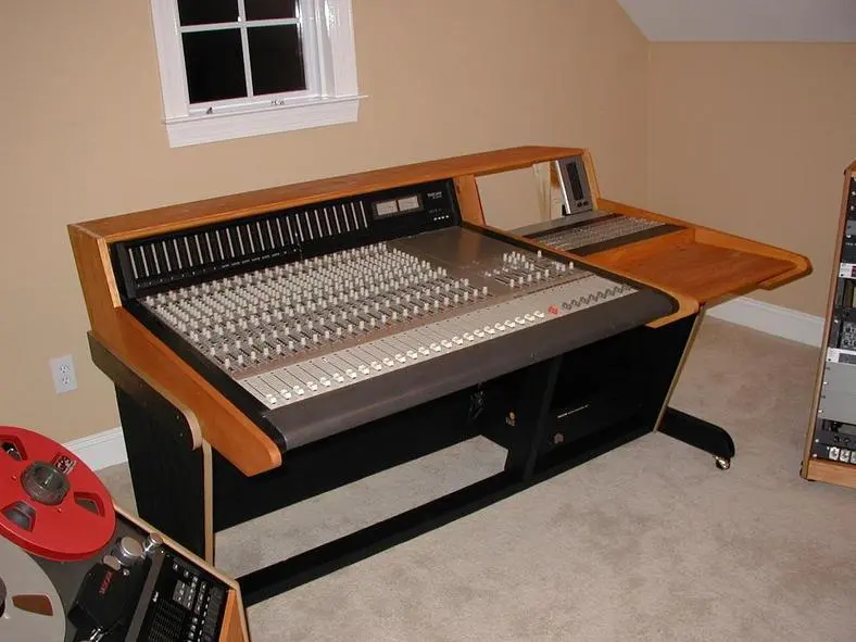

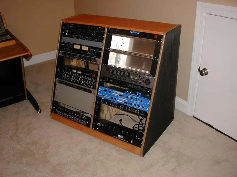

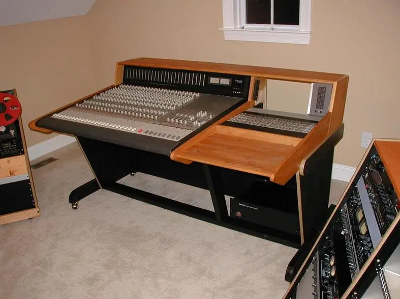

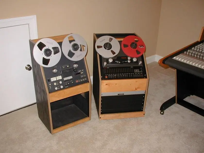

Real close. Just need some small trim parts, minor woodwork, and a panel but for the most part it's compleat just aiting on 2 more patchbays for the desk. I think I could have done better if I just took my time.

gerard - that looks incredible! And the little window and doors give the impression that you have oompa loompas working for you
Thanks for comment! (cleans coffee off keyboard from laughing) It's been a long month!
Very nice Gerard!!! :)

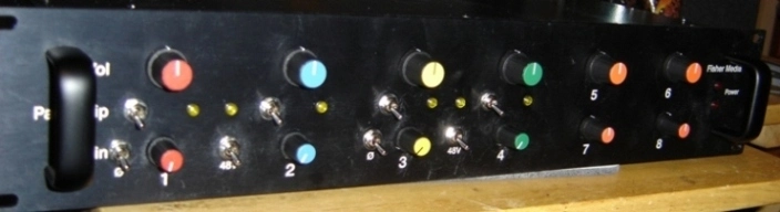

Ok I am done with mine. :D
Impressive. Looks very clean.
