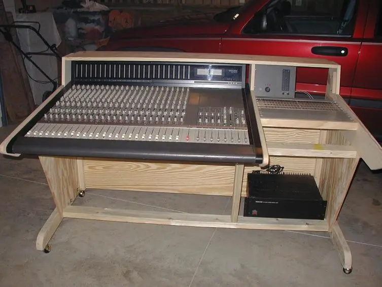

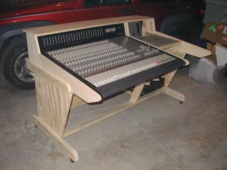

Foward motion on #1
Got out of work early, the weather was nice so out came the saw and drill. It's just "tacked" together with screws for now and still needs alot of work but it's getting closer for paint and stain.
Beautiful!!!
That's seriously impressive.

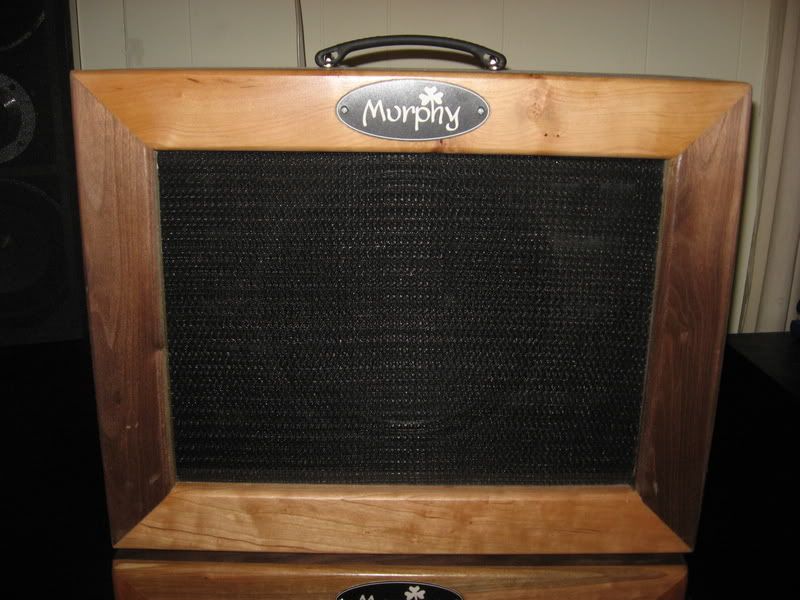

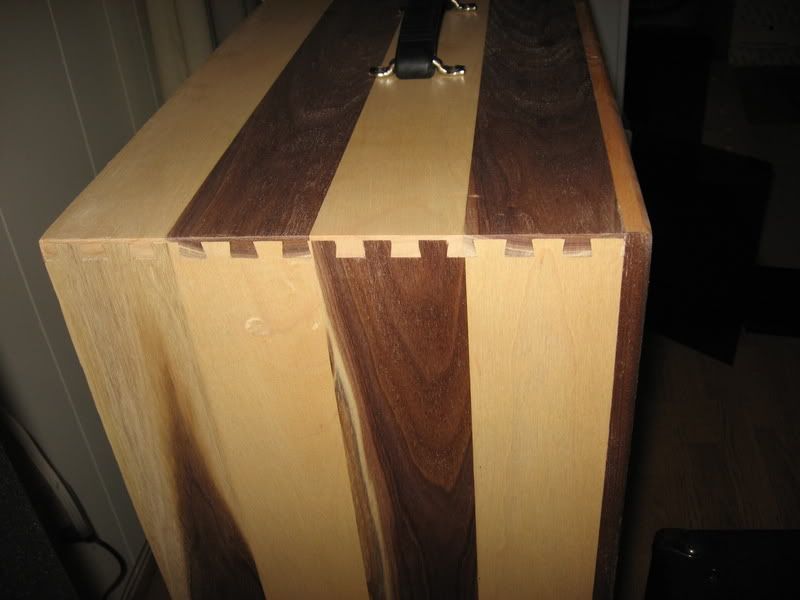

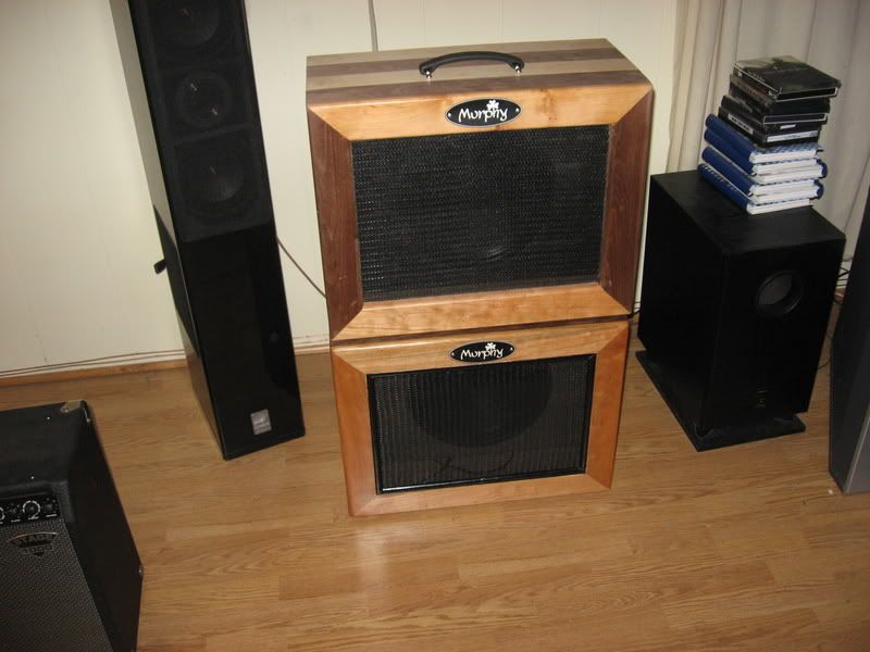

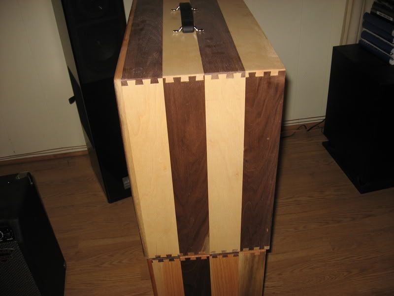

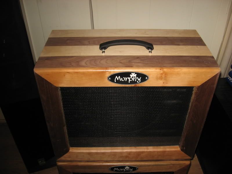

I just finished Two 1-12 extention cabinets. I've been threatening to do it forever and finally got off my duff.
Walnut & Oak, I used Cherry on the backs of both and cherry on one front and cherry/walnut on the other. One is "classic openback" the other is slightly different but still an open back.
I guess I'm not totally finished, I still need to wire the second on, but that'll just take a few minutes.
Plates are from amplates.com, the rest is misc. stuff from parts express and MF.com
Wow Creamyapples1! Great looking cab... Congratulations!
