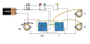

Heres the wiring diagram i used for the switches.
The buffer is wired in series with the input jack
So that means to say the buffer input wire comes from the guitar input jsck tip and the out put of the buffer pcb goes to the top left hand lug of the left hand 3pdt switch (A/B switch)
I hope this makes sense
