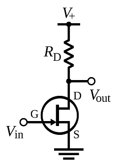

But wait! We're talking about Voltage Dividers, meaning attenuation, so how the hell do we ever amplify anything? Well, transformers can do it passively by converting current to voltage and stuff, but we're not going there today either. The thing about an active amplifier is that it actually divides a seperate supply voltage proportional to the original input signal voltage. That is, we build a voltage divider across the supply rail and vary one of the Zs dependent on the input signal. For these purposes, transistors and tubes work about the same, so let's look at a simple transistor amplifier stage:
In order to understand things, first we have to understand just a little bit about how the transistor works, but we're not going to get too far into it. Let's just suffice for now to say that as the voltage at G goes up, the resistance between D and S goes down. The divider we're looking at has RD as Z1, and the equivalent resistance from D to S as Z2 and is dividing down the power supply to create our output. So as the input voltage goes up, the D>S resistance goes down, and so does the output. As the input swings down, Z2 gets bigger, and the output swings up. Now, maybe that sounds like attneuation, but it's actually inverted amplification.
(Gonna blur some stuff here, folks who actually understand this might cringe, just understand this is sort of how it works, but not exactly)
Let's just say that an input of 0V is enough to make the transistor go to infinite resistance, and 1V is enough to make it go to 0 resistance. We have an input signal that is swinging from 0V to 1V and back. When it swings up to 1V, Z2 is 0, so the output is 9V * 0 = 0V. When it swings down to 0V, Z2 becomes huge with respect to Z1, to the point where we can say that Z1 doesn't really matter, so we've got 9V * 1 for output. As the input swings down from 1V to 0V, the output goes from 0V to 9V. It swings 9 times as far, but in the opposite direction. You can do the same thing with the transistor as Z1 instead and it will not invert, but it's far less common for a number of reasons, so let's leave that.
In fact, there's no transistor in the pedal we're supposed to be talking about anyway, so why do we care? Just so you can see that amplification comes from essentially modulating the power supply in response to the input signal. The opamp in your pedal is a collection of several transistors and some other components that do more or less this for us, and kind of hides that particular version of voltage division inside it's little black box.
