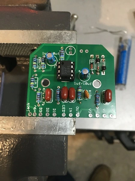

Cool deal. And yes, there were 1M resistors but they are now on the PCB. My lack of patience had me soldering up the components on the PCB tonight so I can finish it up tomorrow when the paint dries on the case.
I went with the MXR dist+ build and that left me with 2 x 20k resistors and a 47k resistor that went to the DOD build option. The 1Ms are right here:

I see the IC is pluggable in that PCB picky? Best idea and here are couple of checks you can do to save time after construction in fault tracing or might even save an IC's pretty A!
Once soldered up, leave out the chip and connect a DMMeter neg probe to the -ve battery supply (no battery at this stage) Now using the Ohms setting and looking at the schematic. probe each pin of the IC and note the resistance reading. Some readings will not make a lot of sense but if for instance the non-inverting pin read dead short to -ve and there should be a resistor in the way...You have blobbed or forgotten to cut a track if using stripboard.
If the R test looks ok, power up the PCB (still no chip!) and again, meter on -ve, check the voltage at each pin again looking for something silly or weird, e.g. if the output had volts on it, something is probably wrong.
If all good, power off, fit chip, juice up. In almost all cases the output of an OP AMP is at 1/2 the supply rail, if not close to this and the circuit does not work look at bias and feedback Rs or maybe an electro cap in the wrong way round.
