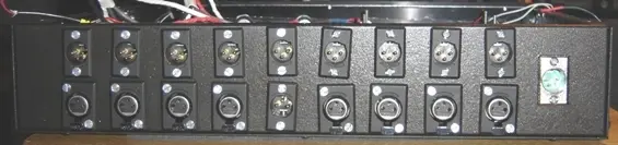

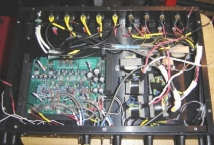

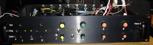

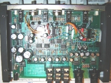

Update
I am now a little half way done with my project of the month.
Again, I am taking two (mod'ed) Symetrix SX202 mic pres and racking them into a 2 unit case. I am replacing the 1/4" outputs with XLR and adding output transformers. I have also added a trim pot between the pres and transformers for a little db reduction when needed. (I do mean a little). Since the SX202 units have a sum output, I am giving it an XLR out too, but it will not be going through any transformers. This will give me the option to record transformerless if I choose.
The other feature I am including on this box is four channels of transformers for other outboard gear that do not have their own transformers. These four channels have their own attenuators for limited db reduction.
