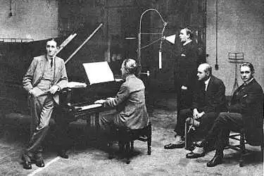

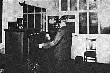

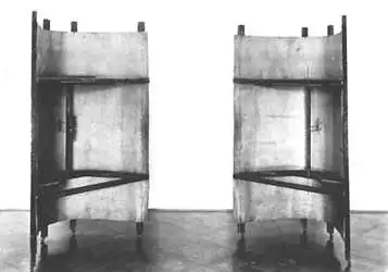

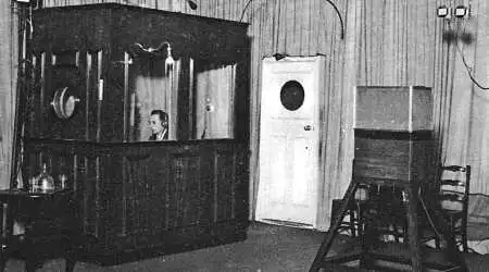

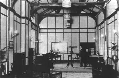

I couldn't bite my tongue any longer.
Then I guess it is safe to assume that the very old studios had acoustic treatment designed into them as well?
DUH!!. From the early 1900's.
Note the use of a various techniques and devices such as:
small rug in the musicians area to reduce reflections from the floor.
Curtains to reduce comb filtering
gobos
multiple mic's(yes this is recording acoustic technique)
diffusers(furniture and other architectural protrusions)
absorbers(wall and curtain)
Not only that, but there is something that newbies to audio engineering don't understand. What if YOU had to design and build the equipment to record. My friend, you havn't got a clue. Where did you think the term Audio "Engineer" came from? Turning knobs? Ha!! The fact is, early engineers were EXACTLY that. Electrical and mechanical engineers who happened to be involved in the broadcast and recording ENGINEERING field, had to design and build most of the equipment they used. Like in RCA, BBC and other great studios, the engineers were constantly engineering, building and repairing the equipment of the era. BTW, if it hadn't been for Marconi, you wouldn't even have a mic!! That is AUDIO ENGINEERING!!!(see the last pic for true audio engineering-
:rolleyes: Modern recording enthusiasts who think that all they have to do to be an audio engineer is buy a PC and a couple of mic's and VOILA!! are an insult to the term. So is this thread. Most homerecording "engineers" don't even know comb filtering exists. Let alone what a standing wave is. Thats why when I read a newbie describe himself as a "recording engineer", I just have to laugh.
