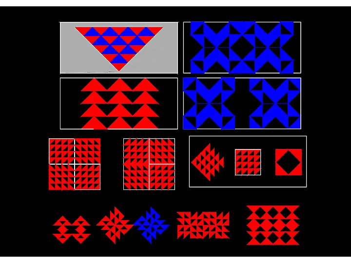

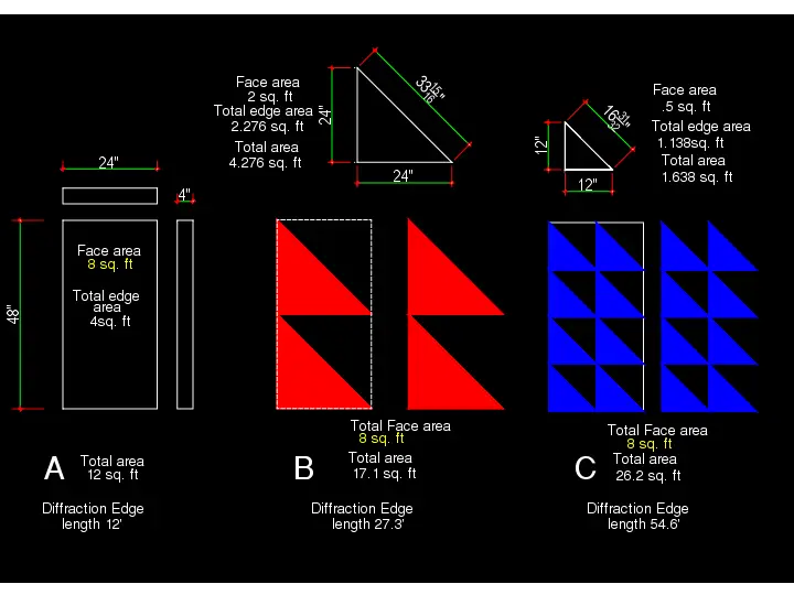

Ok, maybe this will work for you. I believe it will "conserve precious sound energy, while adding to the overall absorption via MORE square footage WITHOUT increasing the FACE square footage. I believe this will also add to diffusion in the room as the geometry adds more LINEAR edge CORNER LENGTH, which adds more edge to diffract around the edge. At least thats the theory. There is much debate regarding the so called "edge effect". Regardless, more edge equals more diffraction AND edge FACE AREA. At least from my understanding, this translates into more absorption without increasing the face square footage. This is all based on "Diamond Theory", or TILING concepts.
The black is wall, the red or blue is 4" 703. Color can enhance the Diamonds, by paint on the wall and or fabrics. You could even fasten these diamonds to full sheets of 1/8" masonite or ply, fasten the assembly to the wall, fur out some 2x2 strips around the perimeter of the whole assembly and cover it with fabric, thereby eliminating covering each diamond. You wouldn't get the visual effect but the absorption/diffusion. should remain as planned.
fitZ :)

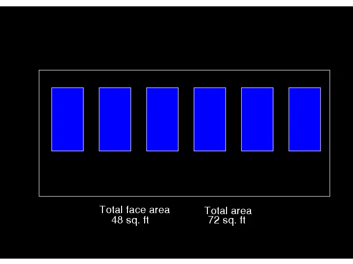

Here is a standard typical homestudio application of 703 panels. Look at the overall sq. footage and compare with the following pics.

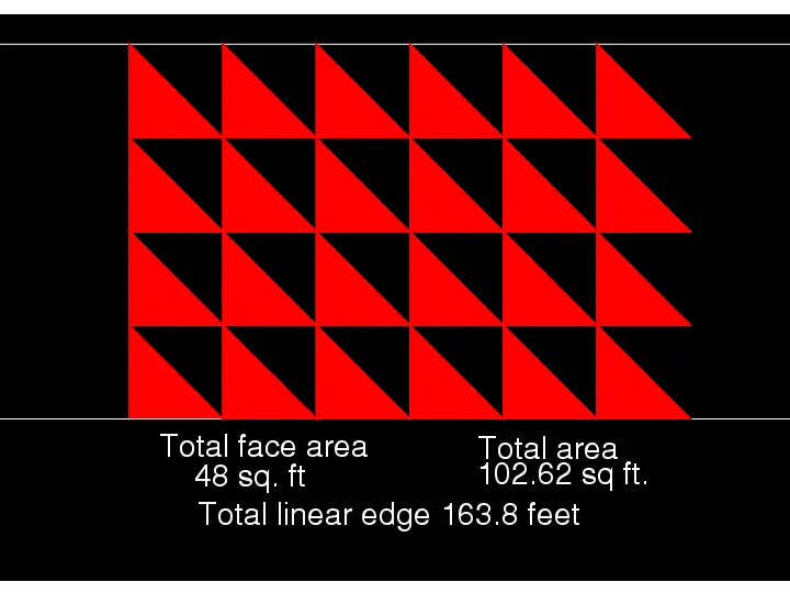

Now here is a pattern using 24"x24" diagonals.

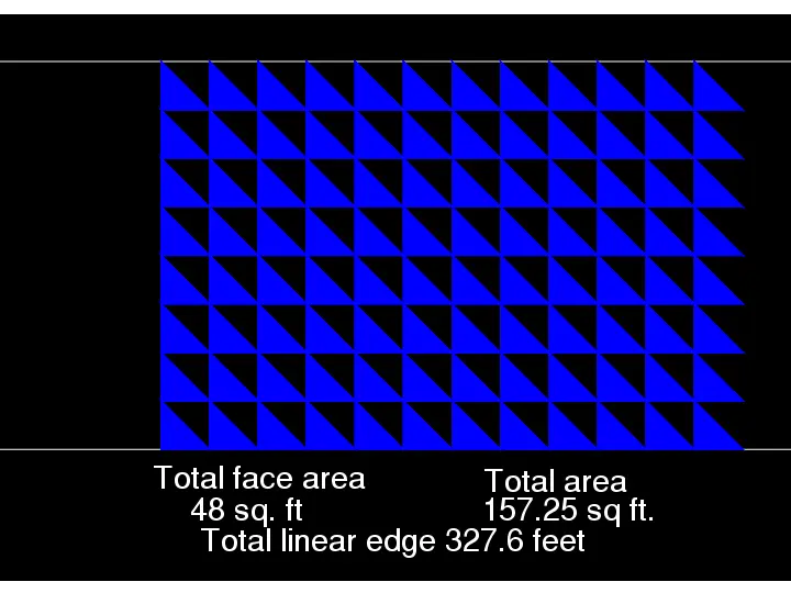

Here is one using 12"x12" diagonals. 16 from 1 sheet of 2'x4' 703.
