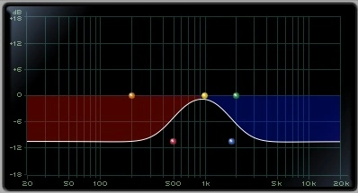

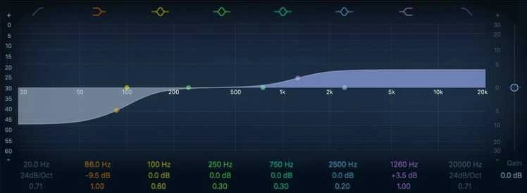

The attached image shows a shelf used to cut low frequencies,
and another shelf used to boost higher frequencies.
The gain setting determines the level of the flat part and the Q setting, if you have one, will determine the steepness of the slope.
You can effectively use a shelf as a high pass or low pass filter by pulling the gain of your shelf as far negative as it goes.

My picture has a high shelf boosting frequencies above X,
and a low shelf cutting frequencies below X.
That's two of the four possible shelf options.
I could have shown a high shelf cutting and a low shelf boosting.
High shelf turns up, or down, everything above X by the same amount.
Low shelf turns up, or down, everything below X by the same amount.
They put a bit of a gradient/taper in there to make it sound more musical but, other than that, it's that simple. (y)

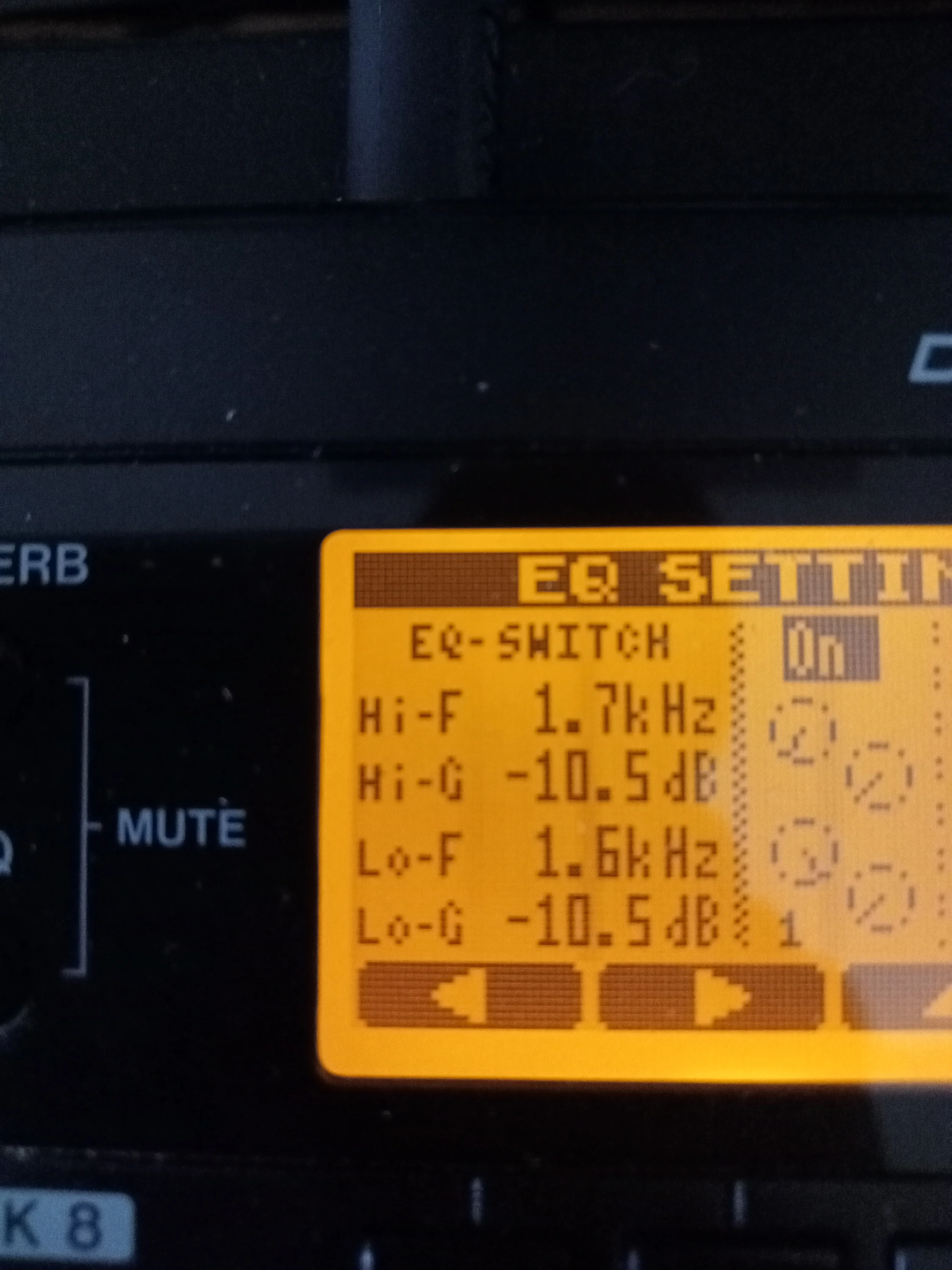

I'm not in daw for this so there's no graphic representation as such. Can you interepret what the machine might be doing here
Ie does the high band at 1.7 mean ONLY 1.7 or some arbitrary tascam range beyond that number
Basically I just need some broad brushstroke idea of what the machine thinks it's doing in principle ie ONLY 1.7 or a range
I don't know that unit so I'm making an educated guess, but those look like controls for two shelves,
or a two band shelf.
Hi-F would be high shelf frequency - the point above which everything is turned up or down.
Hi-G would be high shelf gain - how much it's turned up or down.
Lo-F would be low shelf frequency - the point below which everything is turned up or down.
Lo-G would be low shelf gain - how much it's turned up or down.
If I'm correct then my picture, as an example, would equate to approximately
Hi-F : 1k
Hi-G : 5dB
Lo-F : 200
Lo-G : -45dB
I'm heavily rounding but you get the idea, I'm sure.

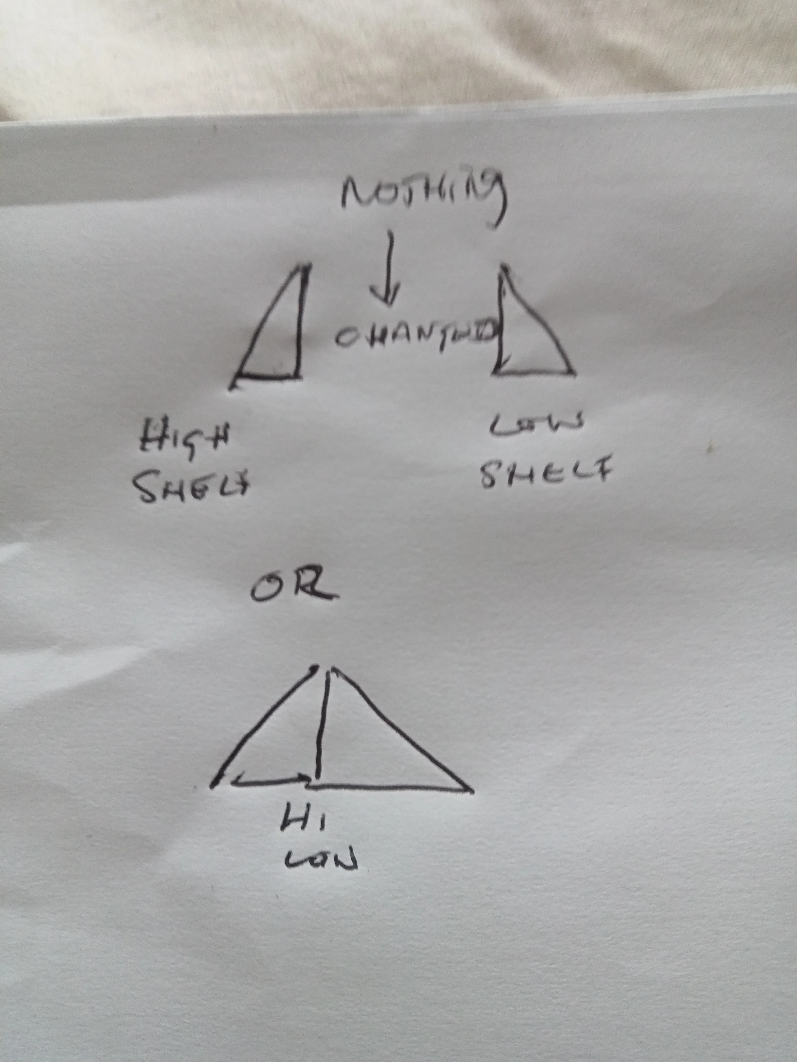

Ok so in both case it cuts the value chosen and a cut (to a lesser amount )above the stated frequency. I'm presuming you mean minus 5db there ?
Apologies just read it again high shelf cuts above low shelf cuts below
So basically what I seem to have done there is chosen an almost identical frequency in both cases to get it cutting on either side . Ie I guess that would be mids and uppers mids
So you could view a shelf EQ as a right angle triangle which if butted together at the same frequency gives you a pyramid cut type effect
The EQs I'm using here don't let me have a low shelf starting at such a high frequency,
but what you have programmed in would look similar to this.
That
The low shelf (low frequency shelf) would be the one of the left.
In both my images frequency is indicated, rising, from left to right.
Yes but that's the idea I guess a kind of triangle that falls off the cliff at the chosen value then another triangle which either joins it or cuts in some other place with a non equed bit in the middle
Nothing falls off a cliff, unless you set the gain to negative infinite or as low as it goes.
All frequencies above, or below, your chosen frequency are raised, or lowered, by your gain setting.
The result is something that resembles a shelf...long, straight, flat.
It sounds like you're focussing on the transition? Ignore that. ;)
