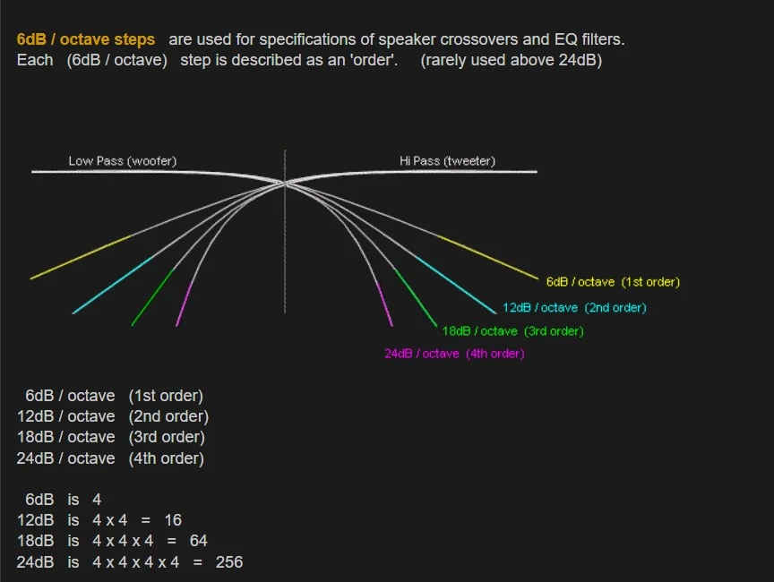

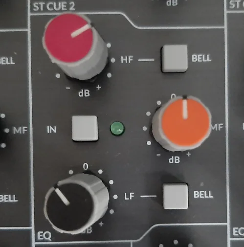

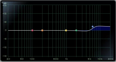

Youve got totally wrapped up in a pointless circular argument. Record some pink noise. Then use your controls to chop off the bottom, and the top wit( your phone using a free sound level app that shows energy and where it is. Remember that while one device can be set to shelve below 307.5Hz, with a 7dB per octave fall, others have a knob or two and far less precision in labelling. Almost certainly, your experiments are doing exactly what people have very carefully explained. The snag is you are expecting to hear something different. Use the pink noise and phone and you can see what the controls do. One of your diagrams shows a little triangular ramp, then a dotted line, then a descending ramp. That is exactly what the shelf filter does. Ive spent four hours trying to get a tom tom out of a drum vocal. Ive tried every filter i have. The low cut sorted the kick and nearly the snare. The tom, however, is almost on his lowest note. None of the filters is sharp enough. Not a fault, just science i guess.
