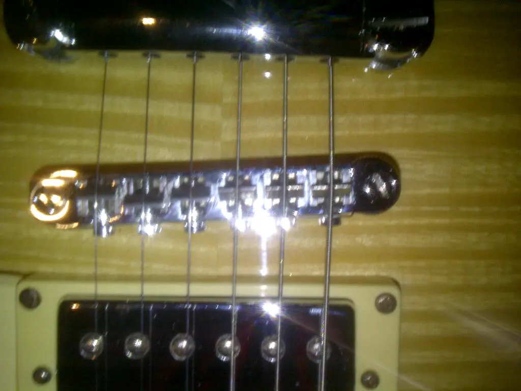

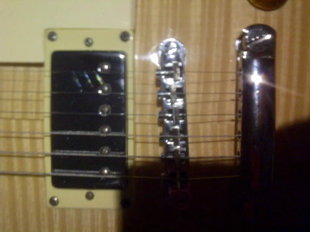

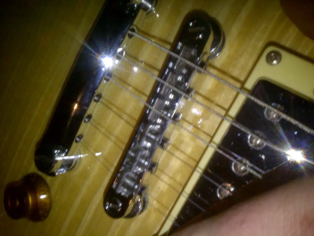

Yes, sorry Lou. Got busy with life there. I am going to try and tackle this again this weekend and see if i can't get it figured out. I will attach a few pictures. Not entirely sure how much good they will do. The flash and overhead light made it hard for my little phone to do it's thing.
Here's hoping we can figure something out. I just can't see how this is possible? I tried it again on Tuesday night and same thing. I move the thing back and forth and the pitch change is nil. I will try and see if i can get pictures of the tuner and saddle together to prove i am not crazy or making it up.
Thanks for waiting, albeit idly :(

The pictures aren't helping me - not clear enough and a bad angle. Can you take a couple across the bridge from deck level?

Hey there Lou. I got some more pictures. They are too big to upload into this forum so i will give you a dropbox link:
https://www.dropbox.com/sh/nxhraogx35w8lt8/tsGl6w5BsV
They are actually pretty cool pictures i took with my fiances Canon. HaHa, i may have to print them and frame them.
I played around with it a bit more today and some of the strings can intonate a little better. they aren't perfect but they do make the magic green LED light up. That is a good sign. However the B - string is still acting like a jerk and defying all logic? Not entirely sure what is going on. I literally have done nothing with it since my original post last weekend or whenever? I may have to try and get a video of what is going on to show you if these pictures turn up nothing obvious.
I am going to order some new saddles anyways i think they are in rough shape as it. This was my stage guitar back in the day and it has seen a lot of blood sweat and whiskey. HaHa!
1) its on the wrong way round
and looks like
2) the saddles have been mixed up,they should form a curve matching the radius of the neck

I am confident that it is on the bolts the right way around. If it isn't, someone should call Epiphone and tell them all their photos and literature are incorrect.
I can't say 100% if the saddles are in the correct place? I didn't do the last setup on this so the guy may have got one or two crossed? I did investigate the gauge of the slots in the saddles and they seem to be in a logical progression from what my eyeball says. Doesn't mean they are right, it just means that the slots seem to go from big to small as they should.

its hard to tell even on those better quality pics,right or wrong way round,saddles mixed up or not i cannot see any reason on that bridge why it cant be intonated ... unless its always been out
The only thing I can see is that the G, B and E slots look a bit deep. Maybe there is too much surface contact and the contact point shifts - thus changing the length - as the saddle is adjusted? That's a wild-assed guess but all I have.
