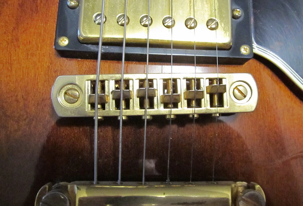

I have two guitars with tune-o-matic type bridges which I had set the intonation after going to a lighter gauge string. Not sure, but I think the lighter gauge was more sensitive to fret height and were more prone to sounding off as they got more of a stretch when pushed over a high fret. FWIW both have the bridge pieces that are staggered like my Epi shown below and seems consistent with some images I've seen online. Is yours similar?
It is similar.
