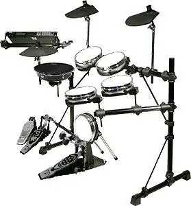

Ohh, I'm thinking of getting this e-drumkit with this e-snare and using the snare of the kit as a tom. I'm sure this will work, but gotta be sure. Think it's a good idea. The e-snare comes with triggered rims too, and wudnt want triggered rims on toms anyway, lol.
It should look a little something like this
