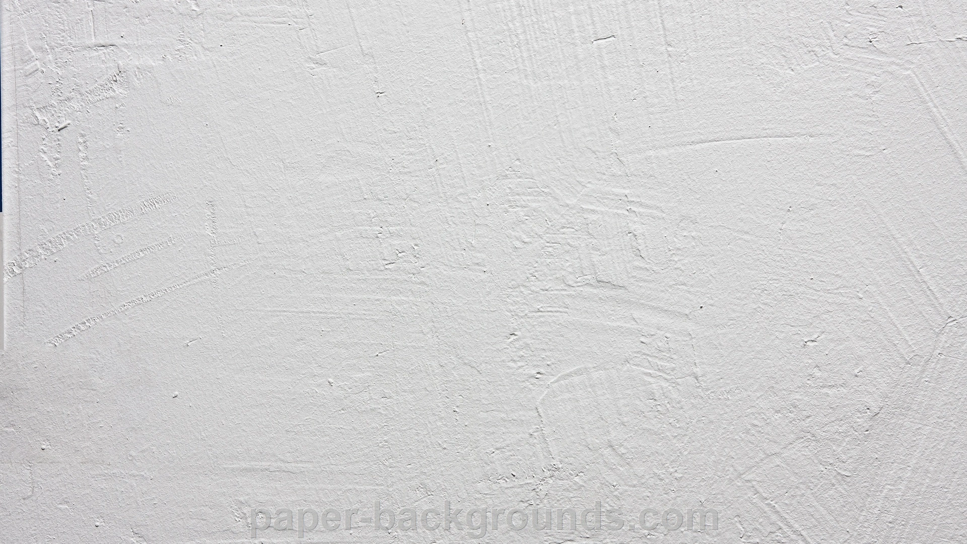

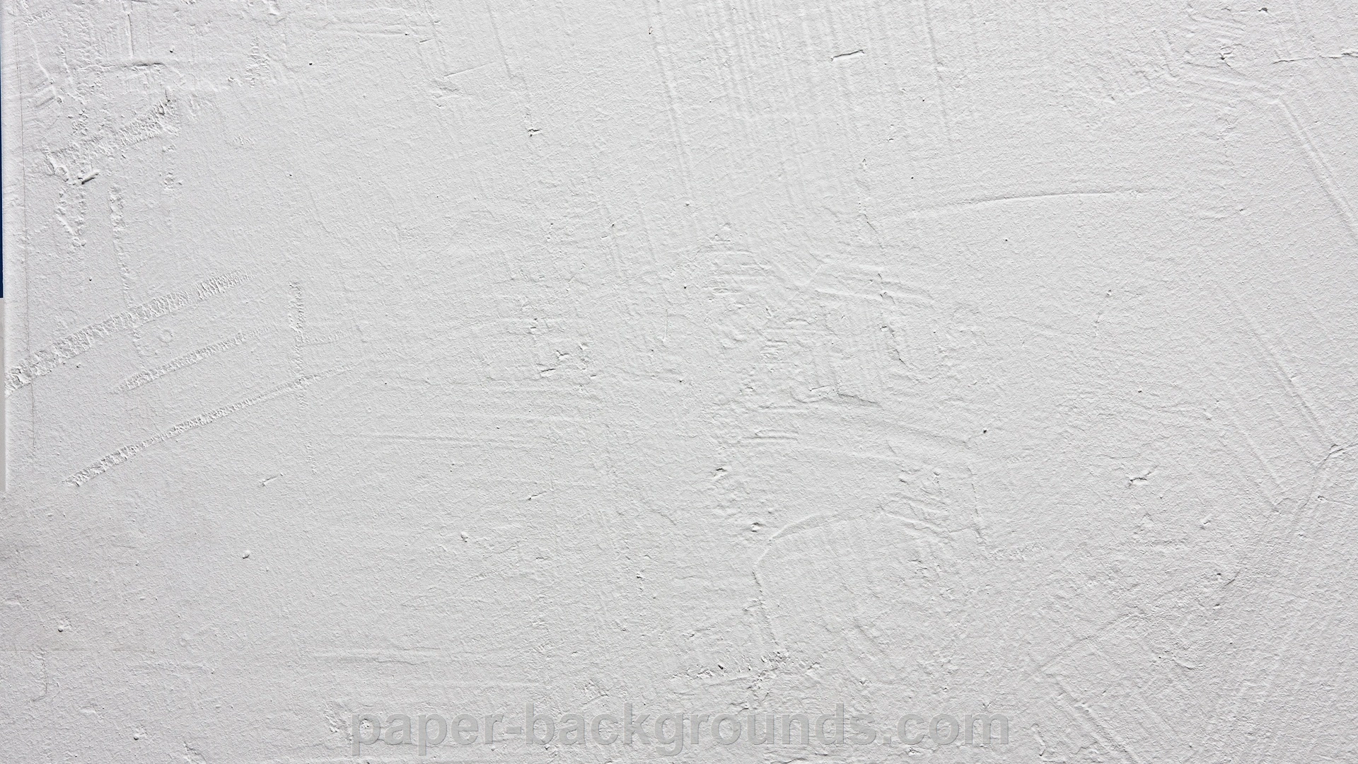

Plaster concrete looks like this:
Can we?
Can we even agree that these surfaces have very different reflective properties?
