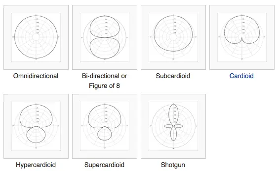

My thinking is the hypercardioid has a sizable rear lobe that could be picking up a lot of room noise. A cardioid has no rear lobe, and although it does have a wider front lobe I have curtains in those directions which I'm hoping will help.
It is the opposite - Hypercardiod has no rear lobe - cardiod has a small rear lobe -doesn't pick up a lot.

Honestly the hyoercardiod won't pickup anything behind - you better off damping what's behind you.
It's entirely likely that I am mistaken on either the terminology and/or how to read these pattern charts.
The pickup pattern of a supercardiod from my experience is quite different than the picture - and the Cardiod is bigger in my experience -

Polar patterns for all directional mics vary with frequency. They trend toward omnidirectional at lower frequencies.
