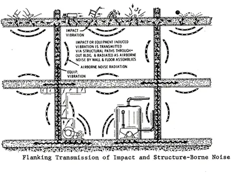

I was looking for transition loss for typical building materials, thinking with a 'brick wall much of the low freq leakage could just as easily be through the ceilings, but no luck, gave up.
But did come across this.. pg 11
As noted, any gap in an acoustical structure that leaks air
will also leak sound. Sound leaks are flanking paths that can
render useless an otherwise effective sound barrier. Typical
flanking paths include joints between walls and ceilings,
floors, or other walls; poorly fitted, unsealed, or undercut
doors and windows; and mechanical or electrical service
fittings and openings. The following suggestions will help
reduce flanking sound paths.
https://www.certainteed.com/resources/30-29-121.pdf
