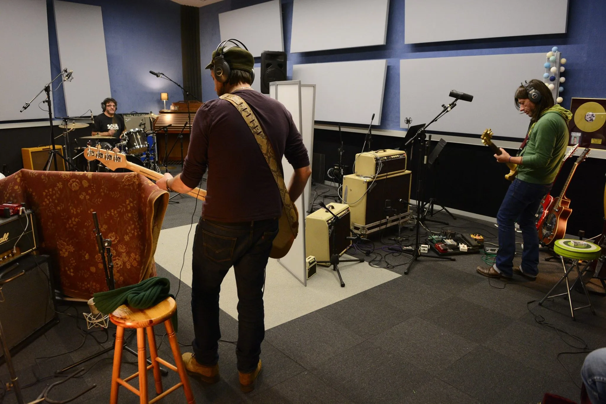

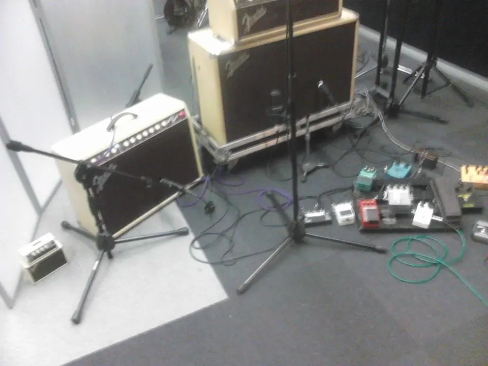

I love to do that when recording live, with bass and drums, you have some more options without recording (sometimes) a useless wall of guitars...
my setup last time, it is funny: 10273218_785280218184262_4229823624363522614_o.webp1972542_712960218735792_1483667404_n.webp
