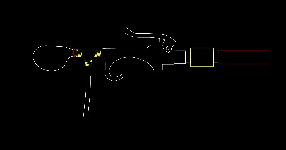

Hey frederic, if you EVER need hi vacume for soldering, I use compressed air. On the end of my levervalve(at the end of the hose) I have a 1/4" metal "T" threaded fitting. On the T leg, I have a small 1/4" x 3" piece of Teflon tubing stuffed into the end with a compression fitting. This is the "SUCKER". On the right end of the T is an adaptor to a standard male air fitting. On the other end(straight through from the air line) I tied a small cloth bag. Hit the lever for air, and "VOILA"......vacume....strong vacume!! Sucks the shit out of solder :D

That's actually known as a venturi pump. They sell them through a lot of woodworking catalogs. We do a lot of vacuum clamping around the shop for jigs and the like, and we used a venturi pump before we bought a real vacuum pump. They are unbearably noisy though, or at least that is what we thought.

Hey Rick.......what program are you using for that illustration?

Rick, liking self-torture, uses autocad :) But the drawings are pretty for sure.

Hello thane, well, as frederic told you, I punish myself with Autocad2002 :p Actually, I am a CAD detailer, so it is really easy for me. However, I took a CAD test for Verizon the other day and they were using a program called Microstation. Never heard of it before the test. They gave me 77 minutes to do 10 things. Write my name in a block, draw 2 lines, one straight, one angled. Move a line. Measure it. Draw a circle. Stretch a rectangle and a few other simple commands. Took me a whopping 3 minutes and I'd never used the program :D I couldn't believe this was thier test, which accounted for 90% of my total test score. The week before was another story altogether. Took a series of apptitude tests :rolleyes: HOLY SHIT.......I failed miserably :confused: :eek:(I think) Some of that stuff I hadn't seen or used in 40 yrs! It sure confirmed my age :o :( :D As far as Autocad is concerned, I love it. Does everything "I" need. And it is intuitive...at least compared to some other programs I've tried.

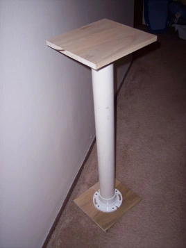

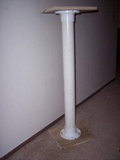

Update

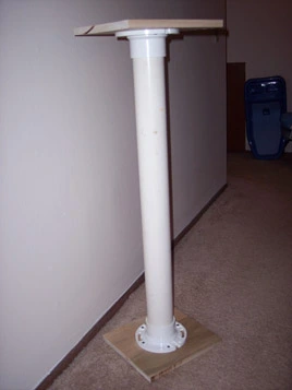

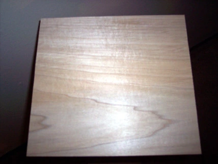

Update on the PVC monitor stands that I'm building.....
I got some Maple at HomeDepot for (check this!) 4 square feet for $0.51!
I'm planning on staingint the tops, and painting the base and body matt black. Here are some pics.

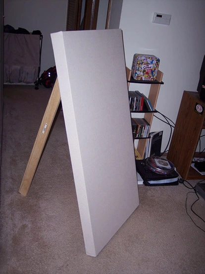

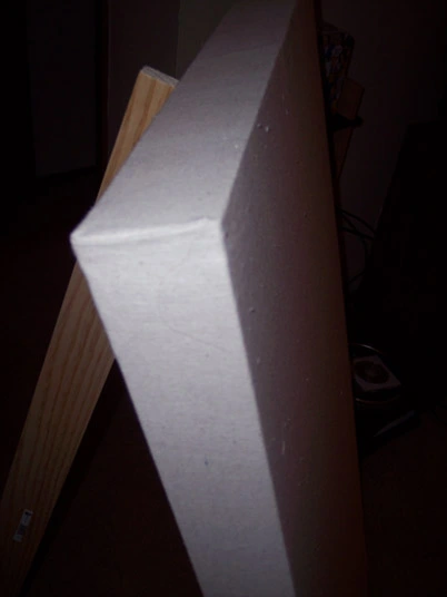

acoustic panels

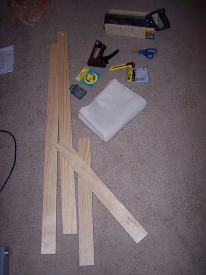

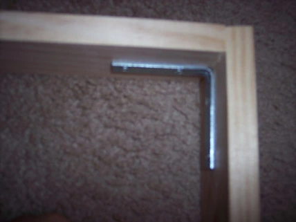

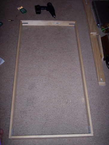

I've started building a few rigid fiberglass panels for my studio space. They are 2ftX4ftX3in wrapped in two layers of loose-weave cotton fabric. Doubled up the fabric still passes air freely. These are pictures of the frame and fabric only, I'm going to buy the 703 tomorrow. I plan on using 3in thick fiberglass.

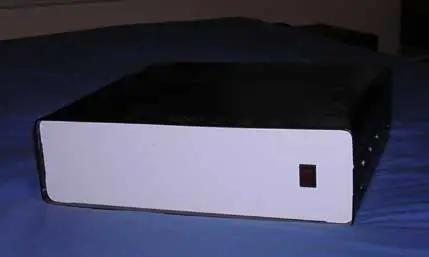

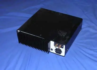

Homemade power amp. It's only mono, but that might change on day. Still 200ish watts into 4 ohms isn't too bad for running vocals though for practice etc. Actually a couple of the transisters are blown, so need to replace them.
