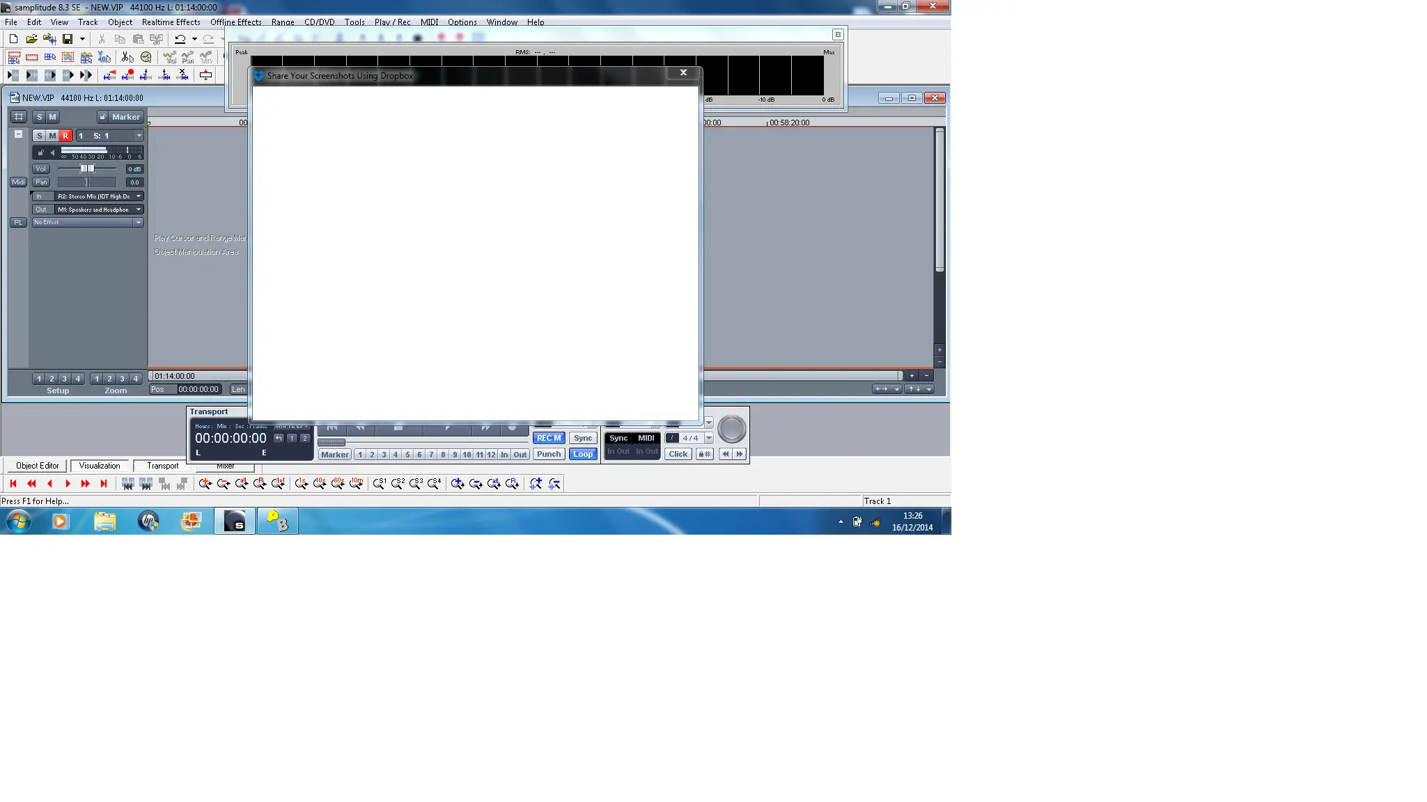

I have attached the settings in samplitude from my laptop playing sounds from another program (could be radio) .
You can see the meters moving and the input set for "stereo Mix" If you have Win 7, even XP you can do this.
