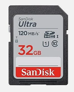

Wow, thats the first time I've ever heard anything like that from a Zoom recorder. If it was an audio interface then I would say that it was a buffer overrun. The only thing that comes from the top of my head is what is the speed of your SD card? It sounds as if the card can't take the audio fast enough.
If you have older Class 4 cards, it may not be able to write data fast enough. I use Sandisk Class 10 / UHD1 cards in my Zoom. This is what I got for my last batch of 10 cards. They work for both my R24 and my Sanyo HD camera doing 1920x1080 at 60FPS.
The card I'm using is Verbatium UHS-1 SDXC 64GB 600X Speed.

I haven't used any 64GB cards in my system. I wonder if that's the problem. I don't know the exact spec differences between SDXC and SDHC, but there may be a difference in how the data is written. Its something to look at. Try an SDHC card. 16GB would be plenty. 4 hours at 24bit / 8 channels.
It may be that the Zoom operating system isn't designed to handle 64GB. I just looked on Zoom's website and I see this:
The R16 records directly to SD cards, with support for both standard SD and SDHC cards up to 32 gigabytes, for a maximum of 100 track hours. Using SD media for recording ensures increased reliability and means that you never have to be concerned about hard drive failure.
There is no sense whatsoever troubleshooting any further unless the card being used is of the correct specifications that the manufacturer recommends or requires.
R16 manual page 12:
• The R16 can use 16 MB – 2 GB SD cards and 4–32 GB SDHC cards
Specifications, Page 95:
Recording media SD card (16MB-2GB), SDHC card (4-32GB)
I'm not saying "this is the problem". But I would eliminate this as a possibility.
OK. I have replaced the card with a 32Gb SDHC one and changed the sample rate to 16bit. I then recorded a mechanical clock ticking for 30 minutes. I could not hear any drop outs in the first 8 minutes, so it looks like we might have found it! Next recording session last Sunday of March, so here's hoping. You can hear some of or work on Soundcloud.com. Search for BM RadioPlayers.
