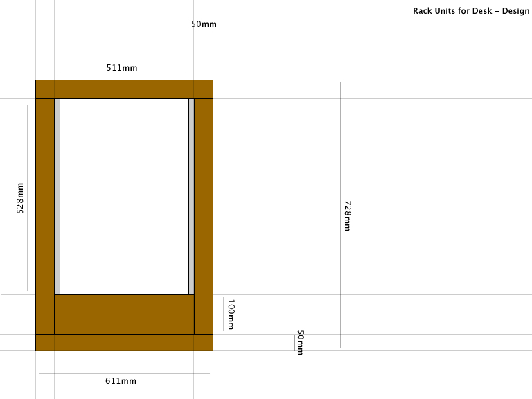

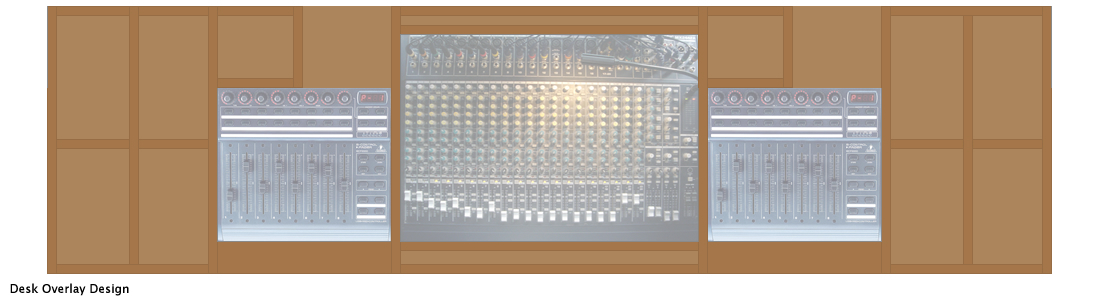

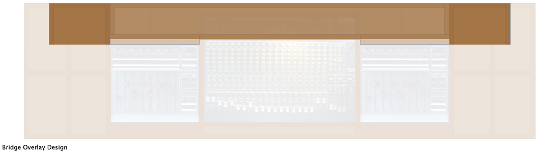

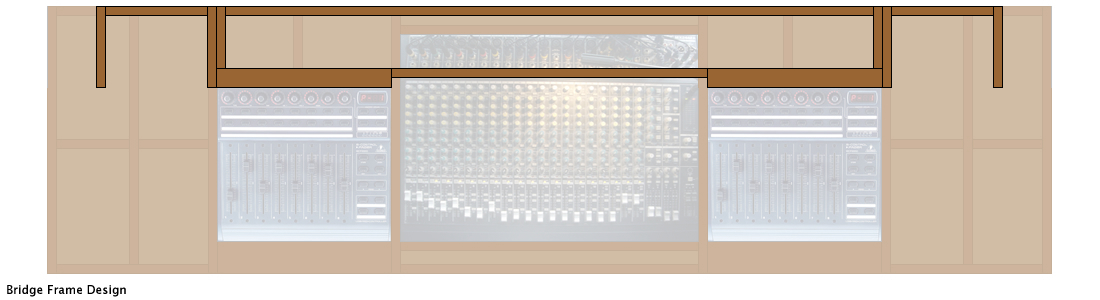

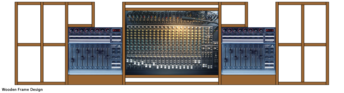

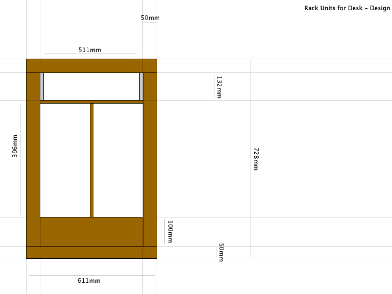

Got round to getting some line drawings down today, only the rack units have mesurements on. Nothing is to scale.
Let me know what you think...
Just a suggestion. I see in your plan view frame drawings, the "partitions" run through the front and back stringers. Do the opposite. Make your stringers continuous. Depending on your final finish, you won't have "end grains" to deal with on the front if you paint. If you are laminating a material over the front stringers, then it doesn't matter, but generally speaking, stringers are usually continuous for strength. However, untill you post some vertical sections, I can't tell if these are narrow stringers or full height panels in some places. It depends on your design which without sections is impossible to see. Nice drawings btw.
fitZ
The reason i didnt bother drawing the other views was because everything is on the same level. As it is a desk I want everything to remain one flat surface. Might make me seem stupid, but I dont know what stringers are?

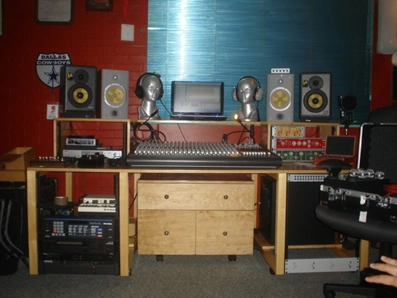

yeah looks nice, i design my desk, and have 14 spaces on bottom sides and 6 rack spaces.
