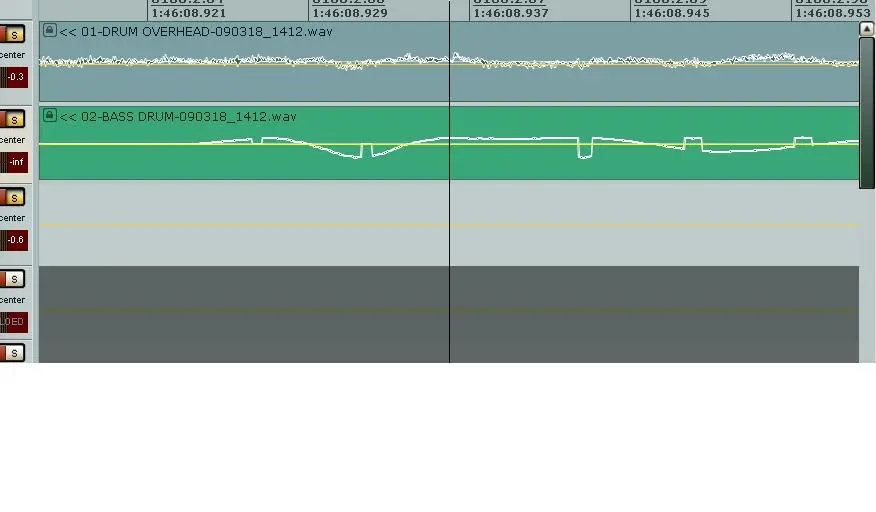

Thanks. Checked the cables already, am looking forward to being able to test the preamp alone later this week. It's all a fresh install. It also sounded like it could be software - sounded almost like playing a 48khz sample rate on a 44.1 project.
Here's a pic of what the audio looks like. It's stuttery with digital distortion. I wonder if it was a buffer size problem...

Why don't you check all your buffer and bit rate settings and all that?
ps....do you like your Gold? I have one too.
I did, made playback MUCH smoother. Set buffer to 512. I just haven't had the time to test yet since the session is over.
