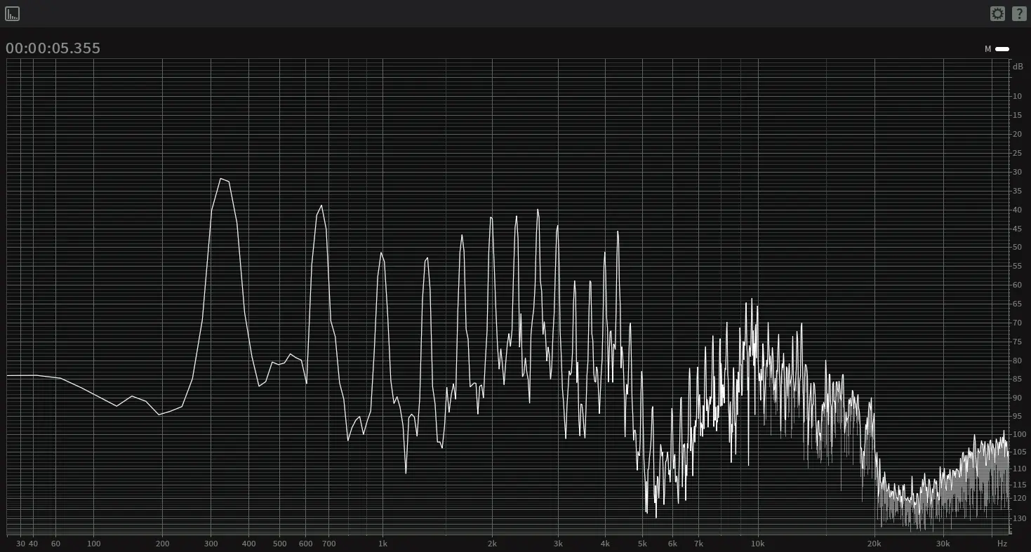

There's a lot of resonance in something there. See attached spectrum plot. (woman-unpadded) I don't know how that's getting in the recording, but I didn't see it in the short clips, and I didn't look at others. The one I did look at was recorded a little hot perhaps.
Ok, so I should chase those ressonances instead of thinking my microphone is broken, right ?
Well, *maybe*. That was a very small bit of the entire file, and I'm not really hearing what I would call distortion, resonances or not. Like I said, it does sound a bit "hot" and maybe backing off from the mic, dialing the gain down a little, both might clean it up. But, what's your space like, and can you still get a good recording if the room is part of what you're tracking?
