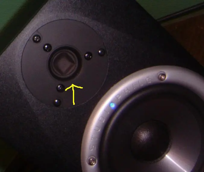

just bought a used pair of M- Audio BX5s for 199$ USD..... thing is though, the tweeter on the right speaker is pushed in..... i dont know how much this effects the sound but i still want it fixed....
where can i get this fixed? how much? etc... im in colonia nj 07067
pic :

I would think M-Audio would offer replacement tweeters. That'd be the best way to go, rather than trying to repair a fragile piece like that.
any idea where? i cant seem to find anything on the site, nor ebay ......
I fix those with PostIt notes. No big deal. If the PostIt doesn't grab enough, use a little Scotch tape on the end of an eraser. Touch the tape with your fingers first so it's not as tacky.
The key is removing it carefully.
it wont effect the sound ?
Not if don't leave it on there. Just use it to pull the dome back out.
Let me clarify - The key is removing the TAPE carefully so the dome doesn't get damaged.
