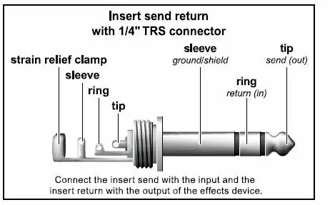

"I've used one of the MG consoles quite a bit for some live stuff. To get 4 seperate outs from the mixer you can use the track inserts and insert a trs cable until you hear the first click (ie. not all the way in)."
sorry to jump in on this, but can you explain this a little better? what exactly is a trs cable? my cheap mixer looks a lot like the yamaha MG10 (behringer ub1202 - picture is here: http://www.casalibertella.com.ar/behringer_ub1202_gde.jpg)
can i do the same thing with mine? i'm kind of in the same boat as this dude, and i just got the mixer so maybe i should take it back and get an MG?
oh and regarding firewire - firewire allows you to record all your inputs separately. there's a thing called a firepod which is basically 8 XPR inputs + preamps, and then the other side connects to your laptop via firewire. so you can record your 8 inputs separately through the laptop, no PCI expansion needed. it looks really simple.
firewire is cheap to install in a laptop if you don't have it already. the firepod is just a bit out of your price-range, though, at about $700-$800. i'm saving up for one right now, unless i can find something better.
oh, and lastly, firewire allows you to bypass your soundcard entirely, so you aren't relying on it anymore, and don't have to worry about spending money to get a half-decent one. this is always pretty good for laptops.
dave123454321 said:
" what exactly is a trs cable?
TRS stands for Tip-Ring-Sleeve. It's a 3-conductor connector (like a stereo headphone plug), which, in an Insert jack, breaks out the signal into send and return. An insert cable will have the TRS connector on one end and will split into 2 cables, each with a TS (tip-sleeve) connector. One will carry the signal to the external processor (like a compressor) and the other will carry the signal return from the external processor, thus "inserting" the external processor into the circuit.
Hope this helps.
Jeff
Good explanation there, they're both 1/4" jack plugs so at a glance they look the same but trs have two black stripes on them (like in the pic below) and ts have just one (because there's no 'ring').
It doesn't look like that mixer has inserts, unless there are some more sockets on the back?
I've not used the 'Big ringer' mixers myself but they don't have a great rep anyway. I can vouch for the yammie though and it has inserts so if you can take the behri back I'd do so and swap it for the Yammie MG.
