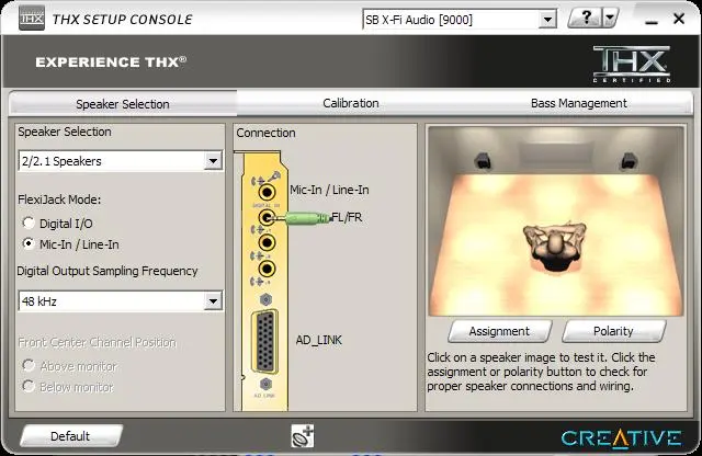

The Mic. In and Line In ports on the sound card are the same. I thought it strange, but that's how Creative has it set up. (View the attachment to see how they have it.)

Roger that, everything's up in both. It works fine when I plug in my gaming mic, but when I hook up the amp, nothing. I've tried it in both Line In and Microphone mode.
Could it possibly be a problem with the adapter? I don't know if I need a transformer or if a normal $3/$4 adapter will work.
