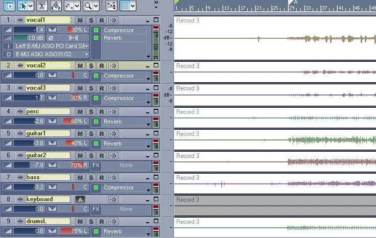

I stand corrected !! It's the 1212M . And everything I said is a fact .
The Patchbay is capable of 32 odd inputs . The daw software and the card are not . Trust me , it will tell you as soon as you go to route it . You can record in one track in stereo with a left and right channel from separate sources in the two 1/4 jacks but you CAN NOT split them into 2 separate mono tracks .
I'm 1000% positive of this . It doesn't work with the DAW software that comes with it , Cakewalk Home Studio or Cool Edit Pro v 1.2a
I just read thru the manual on their site that combines all the cards and can't find the footnote about this , nor does it say you can do it either .
I will scan a copy of the one my brother in law has and show you in black and white .
If I'm wrong about this , please tell me how to get around this .
Sorry Mike, still wrong.
I now have purchased the 1212m and 3 days ago I recorded 10 INDIVIDUAL MONO TRACKS all at once with Cakewalk Sonar!!!
Believe me, the 1212m is capable of recording separate tracks, from 1 to 12 of them. The first day I got it I was recording 2 individual mono tracks WITHIN AN HOUR OF OPENING THE BOX!
Maybe if you post some more info about your problem, I could try to help, but I've only had the 1212M for a week now, so I don't know...
:confused:
Post your computer specs?
:confused:
