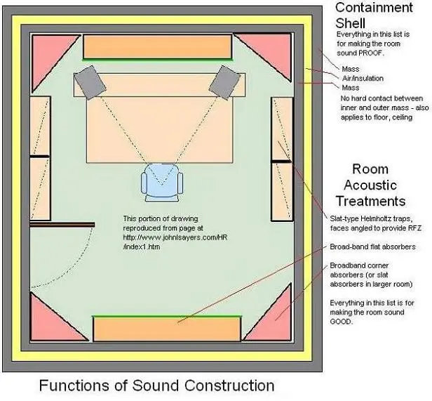

Bricks, mortar and plaster are all good sources of the mass we need for soundproof construction, but what about roofing?
For walls, you can build two brick walls about a foot apart and that will give you a good soundproof wall, especially if they are built each on its own concrete footing; this technique is referred to in acoustics as mass-air-mass construction, and works really well.
For a roof/ceiling, if you could build the same thing in steel reinforced concrete, you would have good results. All this construction needs to be tightly sealed, with double doors and double window glass.
Here is a basic drawing of what I'm talking about - this would also apply to the ceiling if you want a soundproof room; it too would need to be double, with the inner mass NOT in contact with the outer mass... Steve
