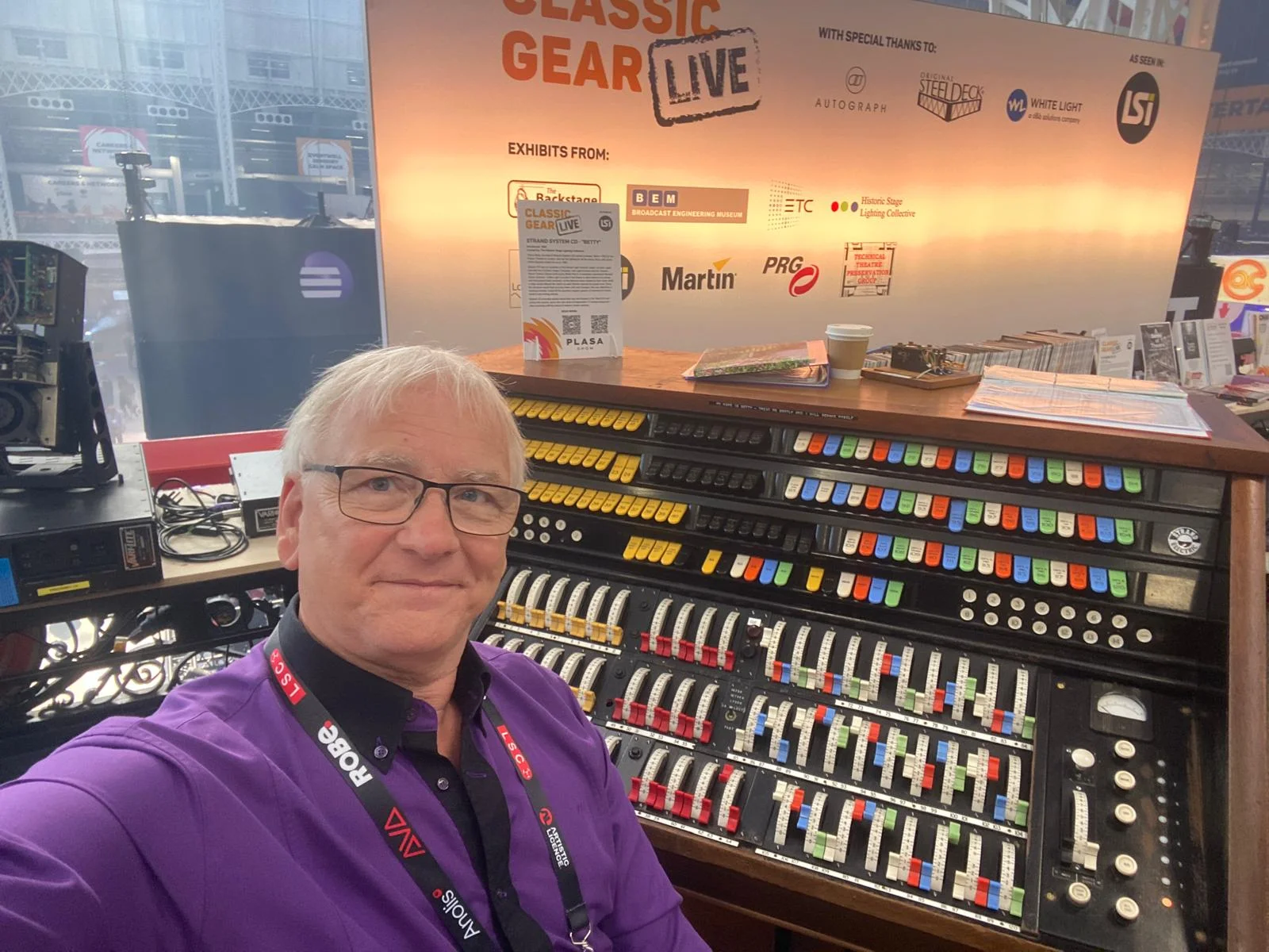

This amazing thing is NOT an organ - it is a lighting controller!
I'll explain.
In 1956, in England, Strand Electric, produced this control. It does look like a theatre or church organ. That is because Compton - the British firm who were sort of the fathers of 'modern' organs had a system the lighting folk could grab straight away.
I've spent three non-stop days explaining how it works. Organ folk need combinations of pipe ranks, lighting folk wanted combinations of lights.
The best bit is that there are 14 mechanical memories. It can remember the tabs that are down and recall these positions. To do this requires your right foot and a left or right hand. Prod the tabs you want to have working, prod the stud near your right foot, select the numbered piston, and job done.
Oddly though, how it works is quite unusual. Both lighting and sound people are used to the method of operation where shoving a fader makes audio louder, or lights brighter. This control does not work like this at all. Pushing a fader to .5 (out of 10) does nothing at all until it is 'activated' by selecting the same number on the tabs, and then prodding a button marked 'raise'. At this point a dimmer is connected to a motorised shaft, and it raises to .5 - half brightness! Actually, at this point EVERY activated tab will also change to whatever level is set on it's fader. Got it?
The speed of the motor doing the raise (or fade) is set by what would have been the organ swell pedal! No facility to do it instantly - you must stay within the range of around 2 secs to 30 secs.
The control was named Betty and went into the Palace Theatre in London's West End. In 1972 - it began operating Jesus Christ Superstar - and it did that until the show closed in 1980 - so 8 years. Betty was then retired, and is in our collection. She now has her memory restored and buttons make things happen! Sadly, I doubt she will never work lights again in anger as the only set of dimmers is in a TV studio, scheduled for demolition. We estimate removal would require 7.5 tons to be craned out, and frankly, where would we put it?
This was just one item in the exhibition at PLASA in London - and I did not expect to be sitting there explaining her for 3 days solid. The most popular thing we have ever showed. Betty is actually called a CD120 - 120 channels of CLUTCH dimmers. the motor shafts in the dimmers spin, and a clutch grabs the shaft for each dimmer that needs to go up, and another grabs the shaft for a fade. One person told us he was a day electrician for the show. He was given an asbestos glove that went to the elbow and had a spanner covered in tape. He then stuck his arm into the live works, turned a nut until the slipping clutch suddenly bit again, and then pulled his arm out quickly! That, apparently, was every day maintenance.
Jesus Christ Superstar had just over 90 cues - but that kept 2 operators quite busy!

90 Cues? I take it there wasn’t better solutions of the lights in 1972?
Betty would be a good subject for a YouTube video Rob.
That 90 cues took TWO operators. 90 cues is going some for a show that totals about 100 mins, I think? Now I might have dozens of cues in one song, but in the pre-moving light days, it just wasn't like that when all they did was went up or down. In fact Jesus Christ Superstar also had an illuminated floor that needed a separate control with an operator - just coloured tubes. I have to digitise and scan the hand written cue sheet - when I have done it I'll stick a page up here.
JCS also had performer mics with cables, and the choreography had to keep them untangled!
I saw Superstar on what was probably it's first run in Los Angeles. It makes me wonder how they managed to get a similar effect with a presumably entirely different lighting system.
In the original, London had an illuminated floor. As in when Herod did the deed, it went blood red - but that control could not do flashing. It has no way of going white-red-white in time with music or the script - that involved another operator and a separate control. Nowadays they can do anything, multiple ways. Back then it was "you want to do what?"

Nowadays we are so used to things like qlab not just running sound, but also lights that you can have a lighting change on every beat of a bar if you want - from 1956, through to 1980 is a huge amount of time for an essential manual system to have worked. Very operator intensive.120 faders, each one preset from a cue sheet, 1@.5, 2@F, 3@.8 through to 120@.3 - AND each running cue selected to run at a specific speed. amazing what the old controls could actually do.
