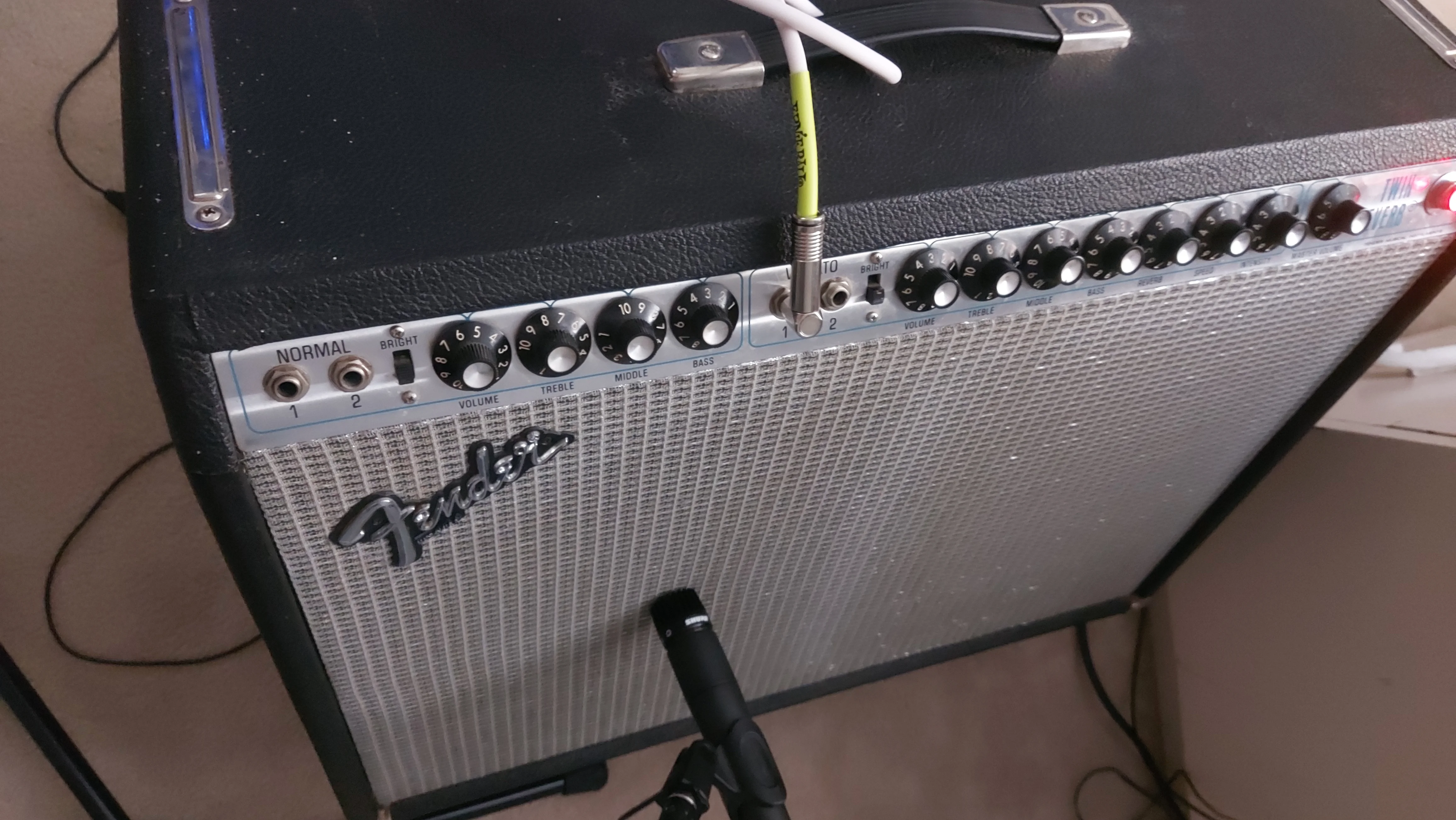

Twin Reverb On its 'Back Legs' so its angled towards the ceiling/wall and (Amp is facing the wall because I heard that creates more lowends)
Guitar straight into the Twin without any pedals.
Single SM57 going into the Scarlett.
This was also recorded using an Fender Strat with a 59n in the bridge.

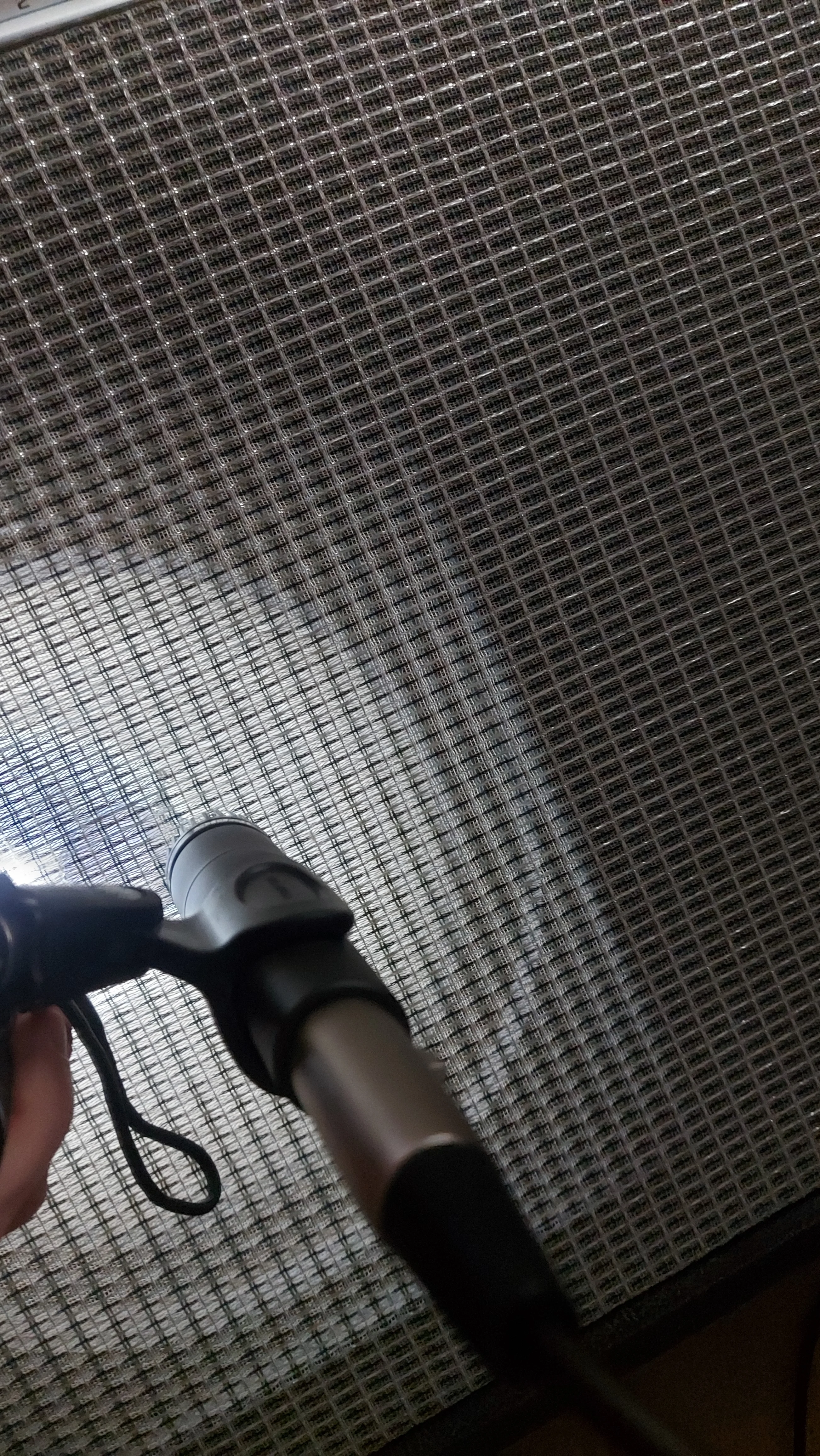

Just off Dust Cap I tried my best to show in the picture.

Aim the speaker at your face. If it's not pointing right at your head, you aren't hearing the actual tone coming from the speaker.

The tip about tilting the amp is a good one. We don't listen to amps on us hands and knees! Guitar speakers are also very directional past about 3kHz. Another trick is to listen to the mic on headphones. And, there was mention of cheap mics? The Behringer XM8500 is really very good for about US$30 comes in a nice, strong plastic case with a clip. Slightly more sensitive than an SM57.

It's still painful. ALL the energy is in the mid and HF - there IS low frequency stuff there, but it's more percussive than 'note'.
I think nobody has mentioned (forgive me if I missed in it so many pages) that TWO mics interfere with each other - hence why there is a polarity reversal button on mixers and DAWs - the little phase symbol. One way it's thin and weedy with no bass, and the other way they blend nicely. You need to forget recording and concentrate on learning how to EQ your guitar and make playing sound better. Recording only works when you have mastered the sound and created something positive.

I still feel there was some fundamental problem at the start - Not just preference...a fault.
That may have been solved by now, I'm not sure.
My gut says that either one of OPs tracks was a sum (at the desk) two signals of opposite polarity,
or that the incredibly weak recording out of the original two was the result of running the mic into line input.
I'm not totally convinced of the latter.
Either way, my advice would be in line with what a lot of the people here are saying.
1: For now, keep the setup as simple as possible.
2: Angle the guitar amplifier up so the driver is pointing at or near your head (be careful to protect your hearing, of course).
3: Dial in the controls on the amp so that you are happy with the sound in the room.
If you never achieve this ^^, come back and tell us...There's no point recording if that's the case.
4: Proceed with one mic on one driver with one XLR to XLR cable into one preamp.
My suggestion would be to pick a mic position and stick with it, for now anyway, and record.
Do several short takes, each time making an adjustment at the amp (or pedal if applicable).
More gain, less gain, more treble, less treble, etc
Note your changes as you go and listen carefully to the differences in the recordings as you go.
If you feel you're getting somewhere and it's working out then keep all the settings on the amp/pedal the same,
but repeat the process making only minor changes to the mic position.
Nearer the edge of the cone, nearer the centre, head-on, tilted 45 degrees, etc.
Once again, record, note changes, listen + repeat.
Throughout all of this make sure there are no processes or effects enabled in your recording software,
and make certain that your focusrite interface is not peaking/clipping when recording.
I believe it indicates with a green/red ring around the gain knob? If that's ever red stop..turn the interface gain down a little bit, and start again.
It's the only way to get really familiar with your setup and the differences that subtle changes make.
Until you're comfortable with all the above I'd strongly recommend forgetting about back mics, or two mics, or any additional effects or processes.
