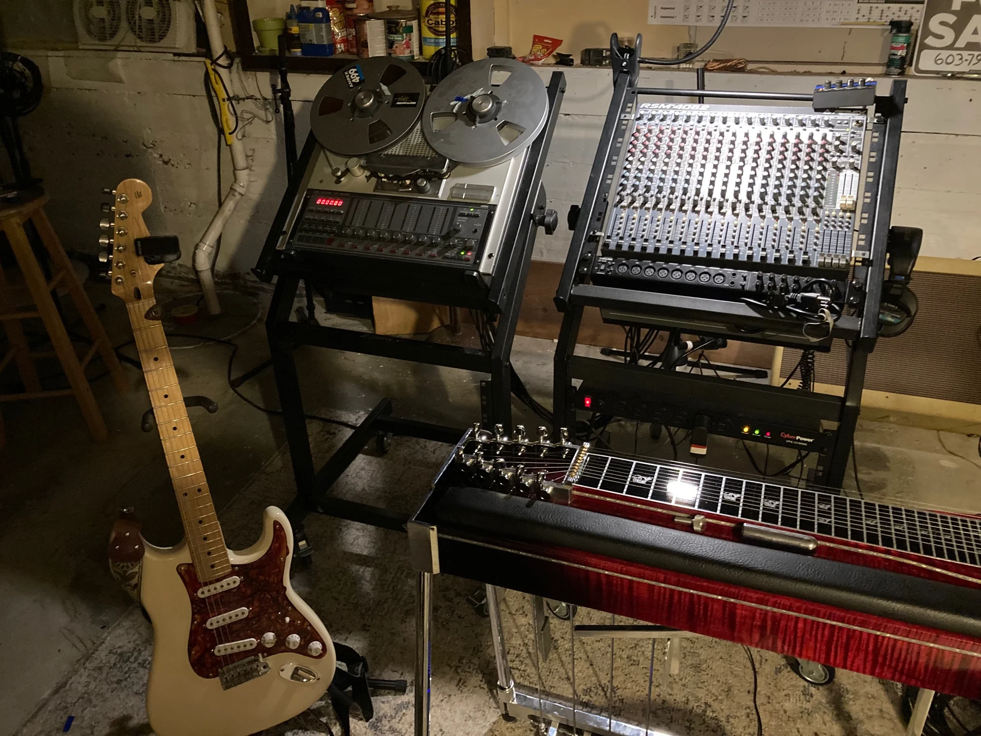

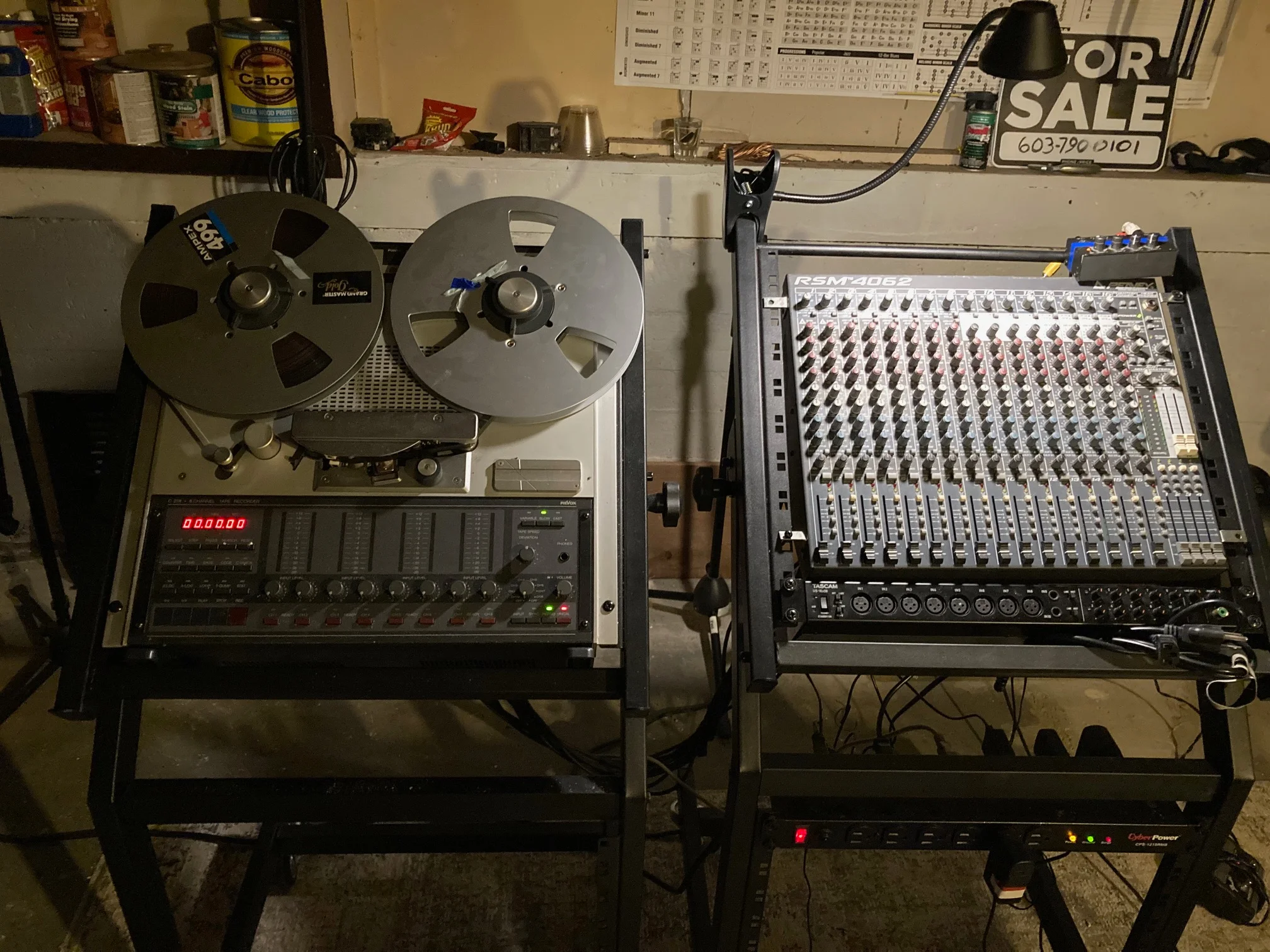

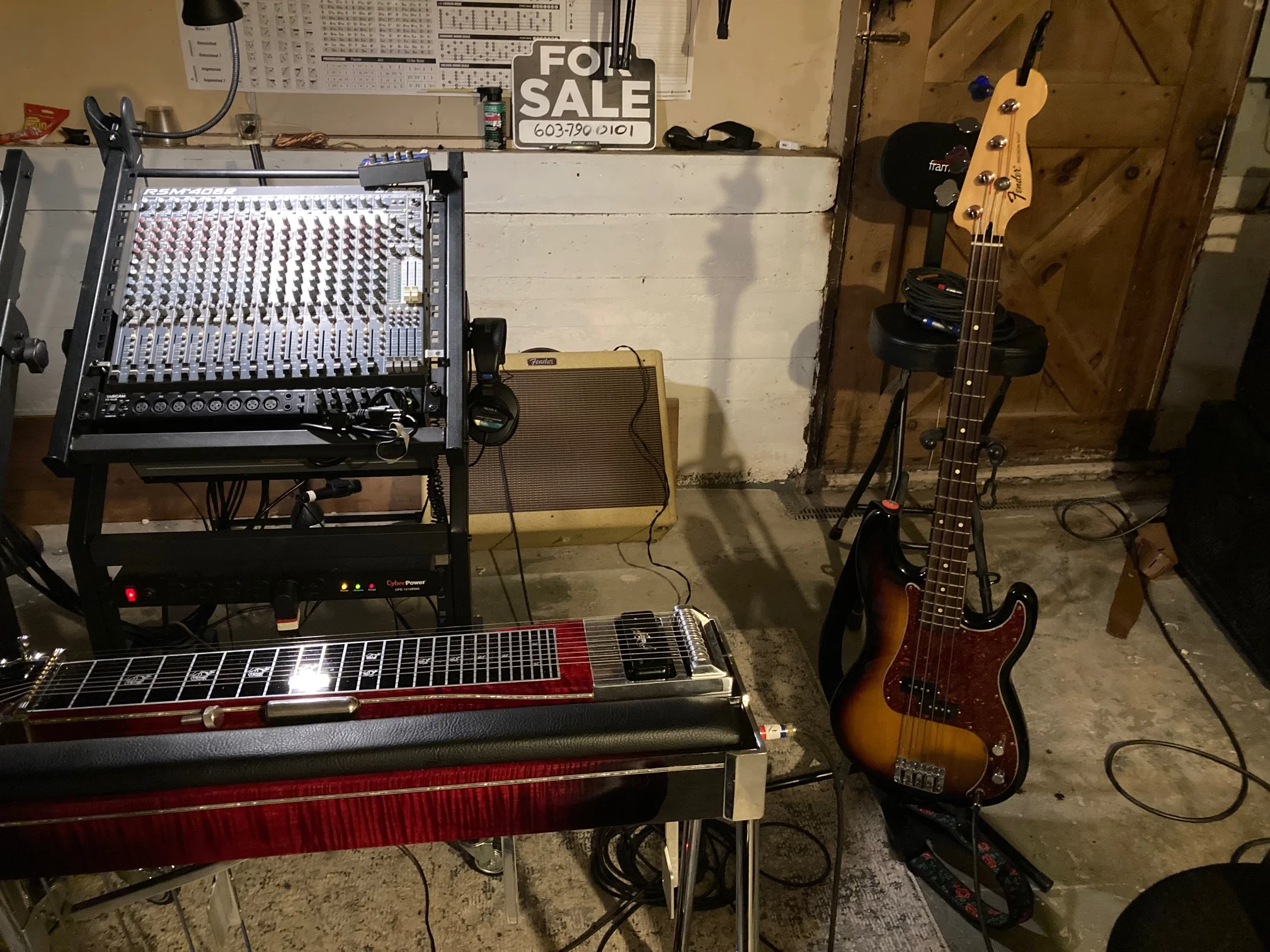

I have to post this. I've had no troubles recording with this setup. (BTW: This is my analog side.)
On the right is a Peavey RSM 4026 and below it on the rack is a TASCAM 16X08. I use the TASCAM mic preamps to condition the signal to the Peavey. Why? Because the preamps in the TASCAM are superb, and extremely quiet. Moreover, it gives me a significant amount of gain, with a S/N ratio >60dB, (and a Line Out if I want it. It also gives me the option of using a mic for the amp, preamp from the amp and/or both. I can monitor the output of the unit with headphones at this gain stage.
From the TASCAM I run the Line Outs to the Peavey's Mic inputs. This gives me another gain stage. This allows me to essentially fix the levels where I want them without having to worry about the S/N ratio. (I know this sounds redundant, but it really keeps the noise floor very low). The Peavey has a channel strip, pans, 6 AUX channels and 6 Groups. There are also Inserts for each channel so if I choose, I can send any or none of 6 channel to the dbx 266xl compressors. I purposely leave 2 channels "raw". I can also monitor the signal at that point. Even with LED meters, It's good to hear. (I wish they never did away with VU meters ☹️)
The Peavey has Direct Outs and Tape Returns which I send to the REVOX C 278. The REVOX pretty much takes care of itself. The inputs have a "CALIBRATED" setting which sets all 8 channels inputs to a fixed reference (meter) setting of 0dB. There is also an "UNCALIBRATED" function with allows for individual input adjustment. If I need to use that, I did something wrong early on in the gain staging. There is also a headphone output there to monitor the signal at the recorder.
The Peavey has Master outs, which is self explanatory.
I showed just three guitars. Each present different challenges for recording. However, if it's taken step by step, good things result.
No, I will not be posting any recordings, and don't call the number on the For Sale sign. It's not mine and the person on the end of that line is ... Well, just don't call.
