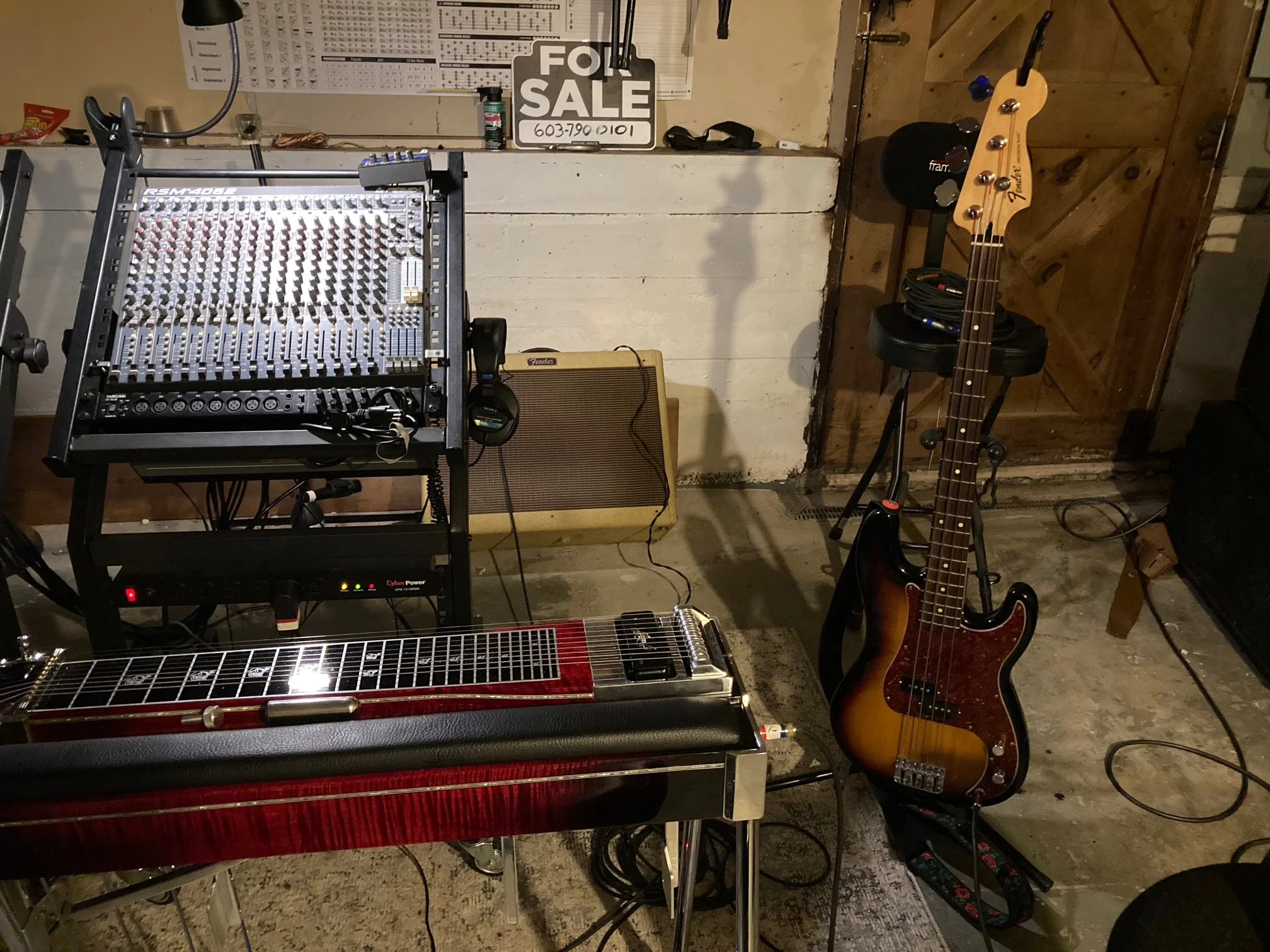

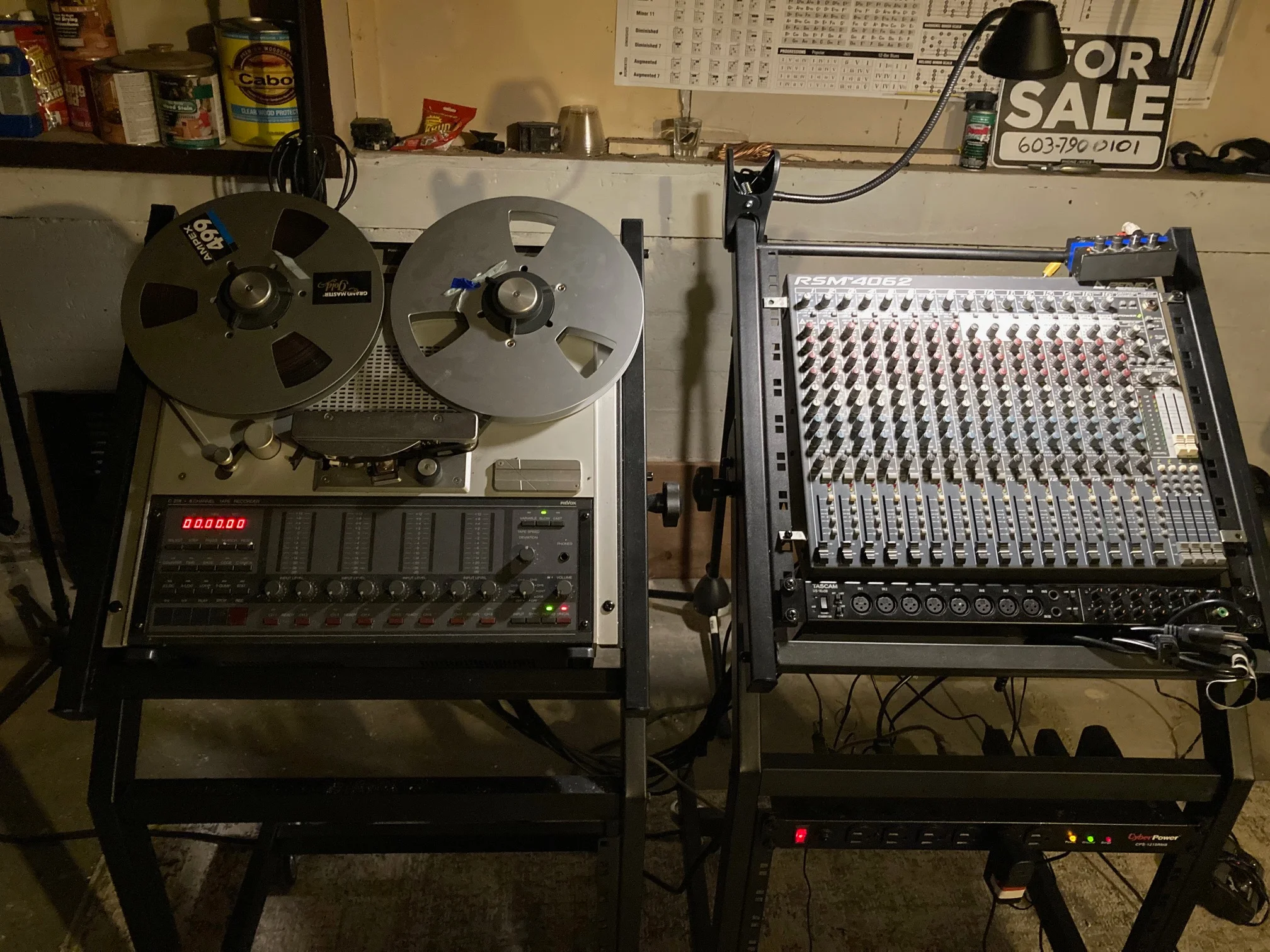

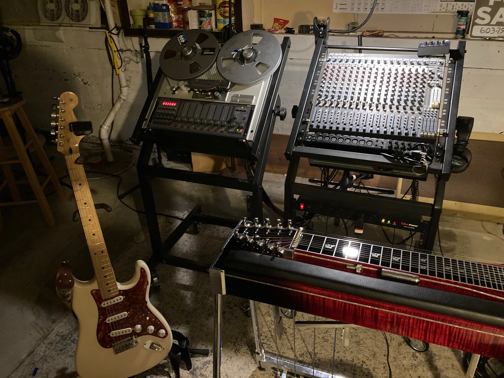

I have to post this. I've had no troubles recording with this setup. (BTW: This is my analog side.)
On the right is a Peavey RSM 4026 and below it on the rack is a TASCAM 16X08. I use the TASCAM mic preamps to condition the signal to the Peavey. Why? Because the preamps in the TASCAM are superb, and extremely quiet. Moreover, it gives me a significant amount of gain, with a S/N ratio >60dB, (and a Line Out if I want it. It also gives me the option of using a mic for the amp, preamp from the amp and/or both. I can monitor the output of the unit with headphones at this gain stage.
From the TASCAM I run the Line Outs to the Peavey's Mic inputs. This gives me another gain stage. This allows me to essentially fix the levels where I want them without having to worry about the S/N ratio. (I know this sounds redundant, but it really keeps the noise floor very low). The Peavey has a channel strip, pans, 6 AUX channels and 6 Groups. There are also Inserts for each channel so if I choose, I can send any or none of 6 channel to the dbx 266xl compressors. I purposely leave 2 channels "raw". I can also monitor the signal at that point. Even with LED meters, It's good to hear. (I wish they never did away with VU meters ☹️)
The Peavey has Direct Outs and Tape Returns which I send to the REVOX C 278. The REVOX pretty much takes care of itself. The inputs have a "CALIBRATED" setting which sets all 8 channels inputs to a fixed reference (meter) setting of 0dB. There is also an "UNCALIBRATED" function with allows for individual input adjustment. If I need to use that, I did something wrong early on in the gain staging. There is also a headphone output there to monitor the signal at the recorder.
The Peavey has Master outs, which is self explanatory.
I showed just three guitars. Each present different challenges for recording. However, if it's taken step by step, good things result.
No, I will not be posting any recordings, and don't call the number on the For Sale sign. It's not mine and the person on the end of that line is ... Well, just don't call.

That equipment is really awesome! I bet it sounds awesome when you record to a tape like that!
Thanks. Me and my friends use it to flesh out ideas. Some good, some not so good.
My comment about no samples was because, I haven't spoken to my band mates about it. And none of it is mixed. It's easier to record on tape than into a DAW.

That's interesting.. So you record to tape then playback the tape into a audio interface into daw? I heard recording to tapes cause some cool effects to the audio that can't be done digitally. Well of course like amp sims you can always add in a tape effect to your track but not the same.
Analog has always been my choice. I find that a tape recorder is much easier to manipulate than a DAW: FF, REV, RECORD and PLAY. Overdubbing can be a challenge when I'm by myself, but, hey...
If there's something we agree on, I can bring the PC over to the TASCAM and send it to the DAW. Then the mix.
I also have a DAW/MIDI setup for a few keyboards that I can throw in pasta ideas. Some stick, most don't.
On the flip, no matter how cool that stuff looks, GIGO. "Garbage In, Garbage Out". You should concentrate on getting your thing together. Find your sound. Find your stage. I have 14 guitars, and each one speaks to me differently. I've modified the ones that didn't speak to me out of the box. Some I won't touch. I know what I want, I know which guitar I'll use, and know how to use it. You should spend more time loving your Strat and hearing what he/she has to say, and then give it a voice. That's your JOB! Lean in to it,
Well, my DAW has FF, RW, STOP, PAUSE, PLAY and RECORD buttons? The only thing missing is rotating spools, alcohol and buds, screwdrivers and hiss.

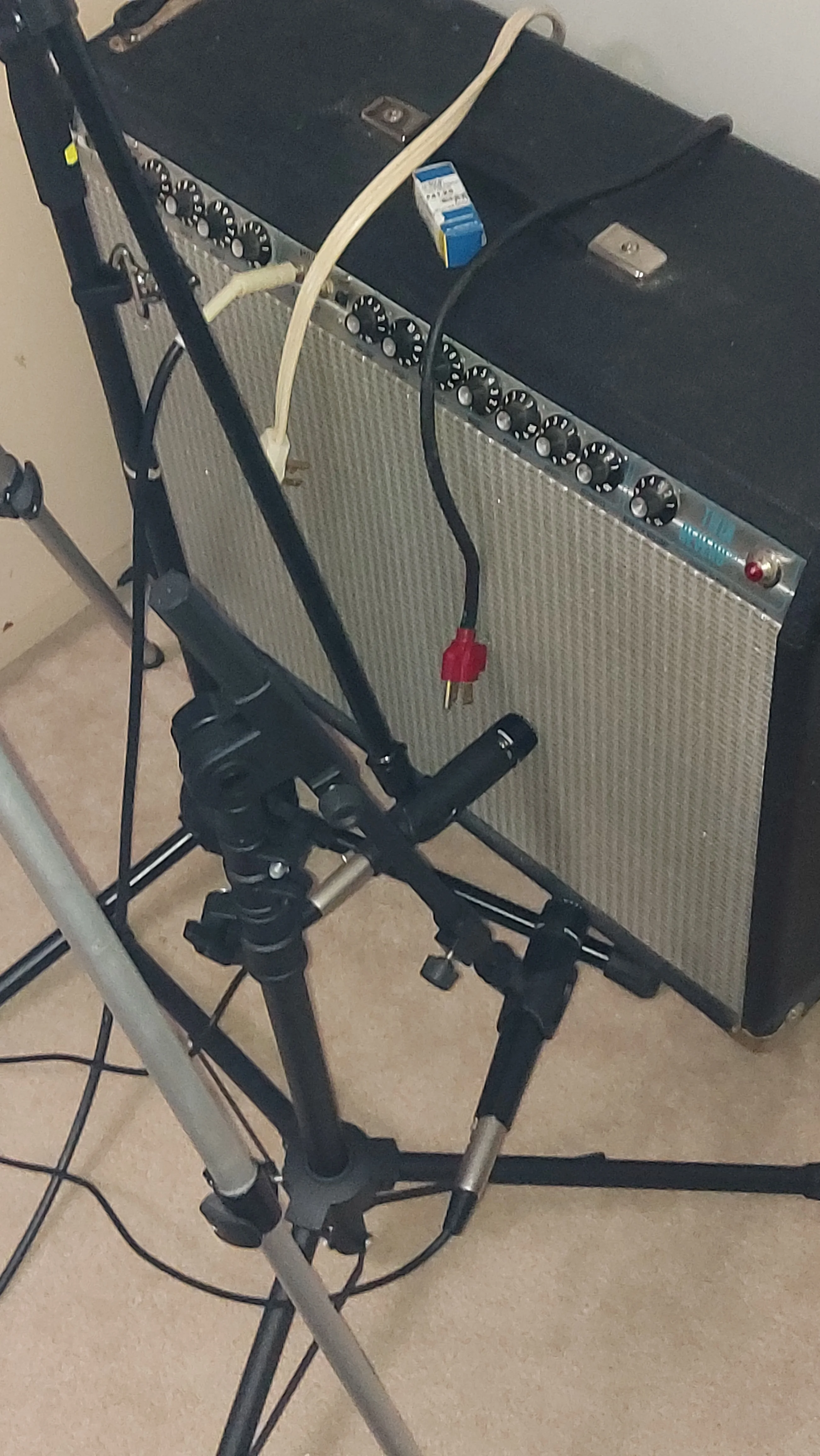

Here is me trying to recreate the "Live at the Paramount" Lithium. Which I believe from what I saw online it has a lot of highend in his guitar
This was recorded with three mics
-Two SM57 (Off Dust Cap + 45o pointing towards dust cap)
-One At2020 as the room Mic
Amp
1980 Twin Reverb

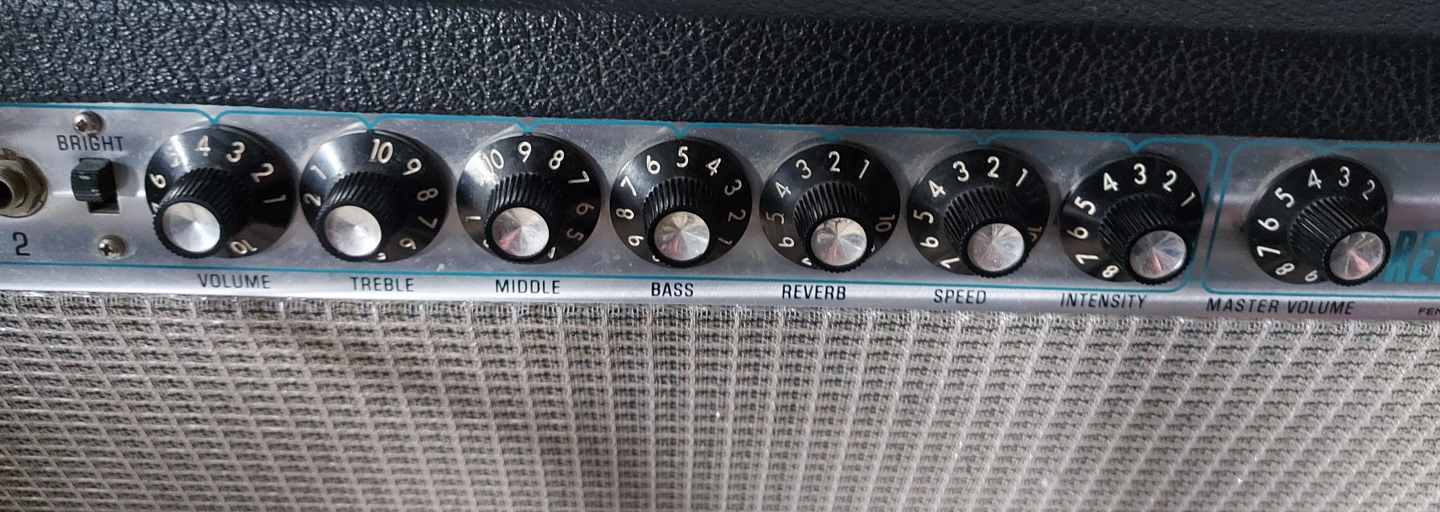

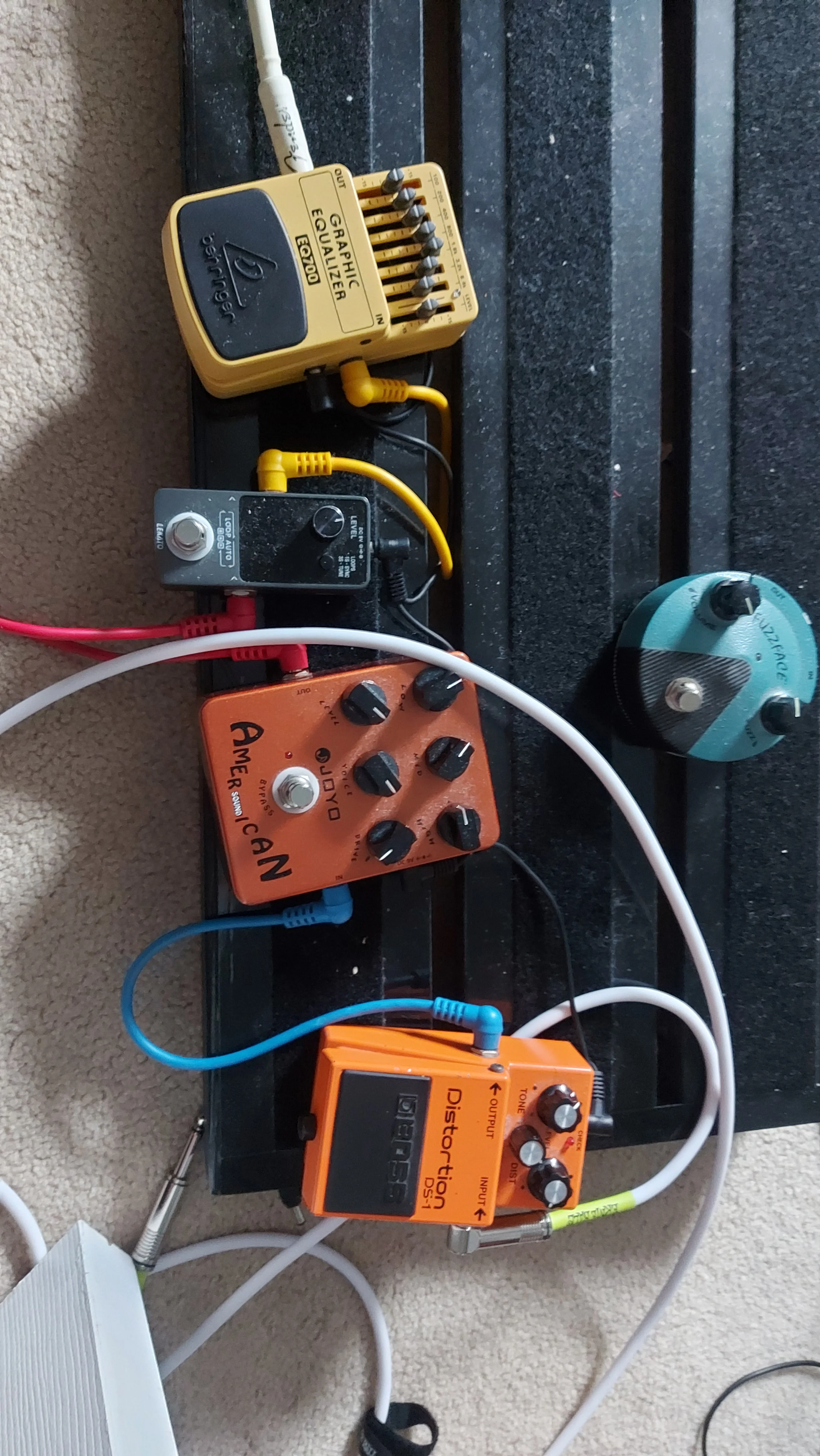

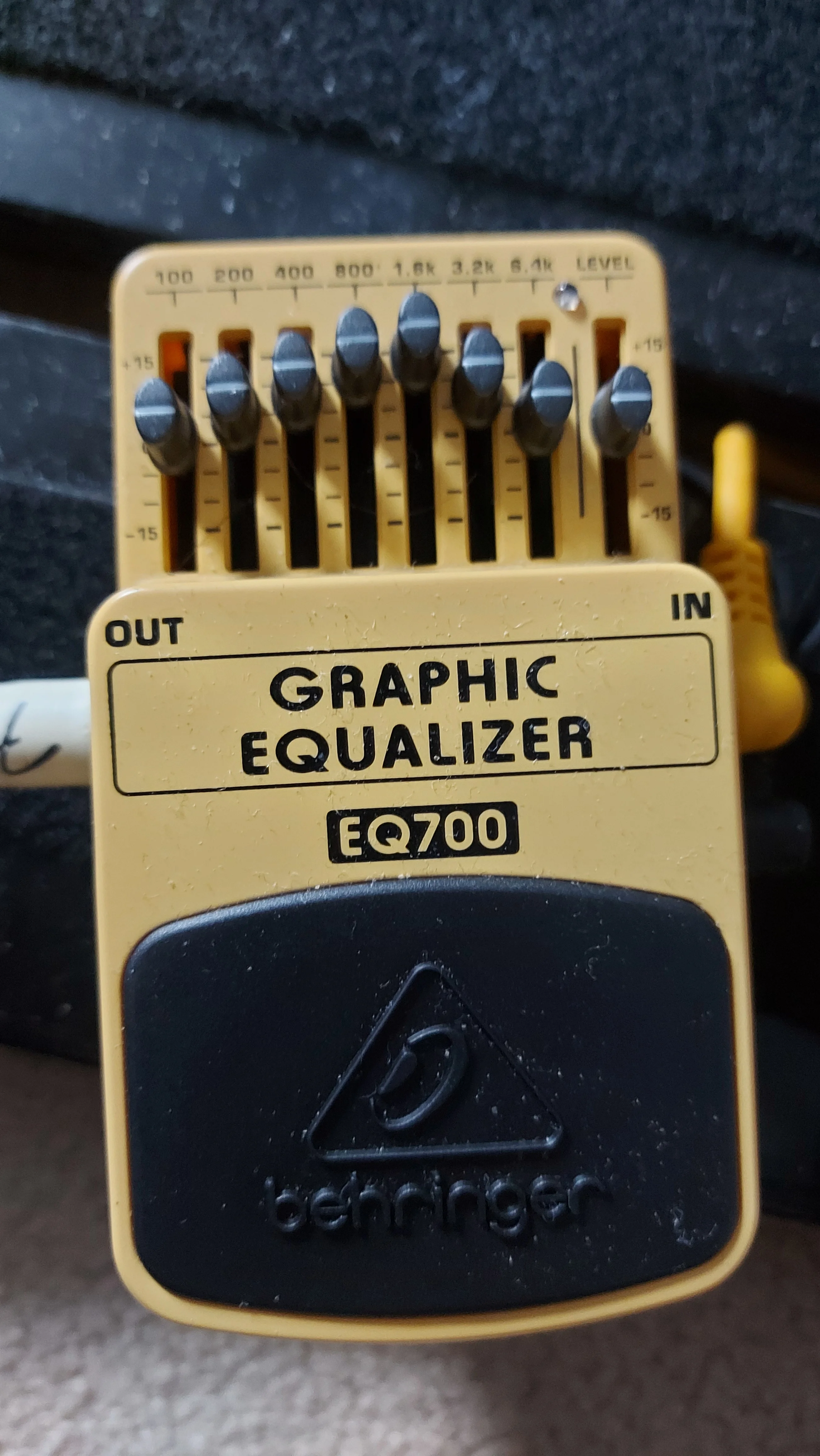

Here are my settings. Then the guitar volume is turned to maybe about 8ish. I know that the playing isn't the best but I just grabbed it quickly before running to work. I followed some of Aaron rash videos + nirvanaguitars. If I was to describe where the microphone postion is right now i would say about 1 inch away from the dust cap as I heard it can be a bit harsh sounding center. Just out of curiosity what's a good level to record the mic gain st? I heard -6 and -12 and also heard anywhere in between. Is it also better to record all mics at the same volume to start off with? I assume depending on the final results you want is how loud the other teo mics should be. So not really a right answer to that.
So if you have any suggestions on any adjustments then I can try it. I could try turning up the bass a bit or turning down the mids / trebble.
Thanks

What are the odds the amp is still pointing at his calves? (I was already writing this when that last post showed up.)

In the meantime.....ditch the pedals.
No disrespect intended, but I hear lots of stuttering/hesitation at the very beginning which leads me think that you were wearing headphones listening to a tune and attempting to play along with it, but lagging a bit behind.
Is that what you were doing?
Clean playing reveals a lot in technique (or lack of). Kicking in lots of distortion covers a myriad of sins. At the same time, if you really want to do Nirvana, you need both clean and extreme fuzz, like the SD1 or RAT set full blown. It's just a continuation of the the Fuzz Face or Big Muff that we had back "in the day".
So I changed up a lot of things now I have the amp sitting on a cabinet above 3 feet off the ground I would guess.
I lowered the "Volume 2" on the amp and just raised the "Mastervolume 4" see if that would help clean up the clean tones a bit.
In my opinion from listening to both the one posted earlier and now side by side I do like the one attached to this comment now much better.
Mic1 SM57 is about right off the center edge of the dust cap.
Mic2 SM57 (China copy) is like center between the edge of the speaker and the edge of the dust cap
Mic3 I have about 6 feet away from the amp and about 3 feet higher than the amp.
Thanks for all your help guys! I don't really know what I'm doing and just learning as I go I guess everyone has been there at one time or another.
