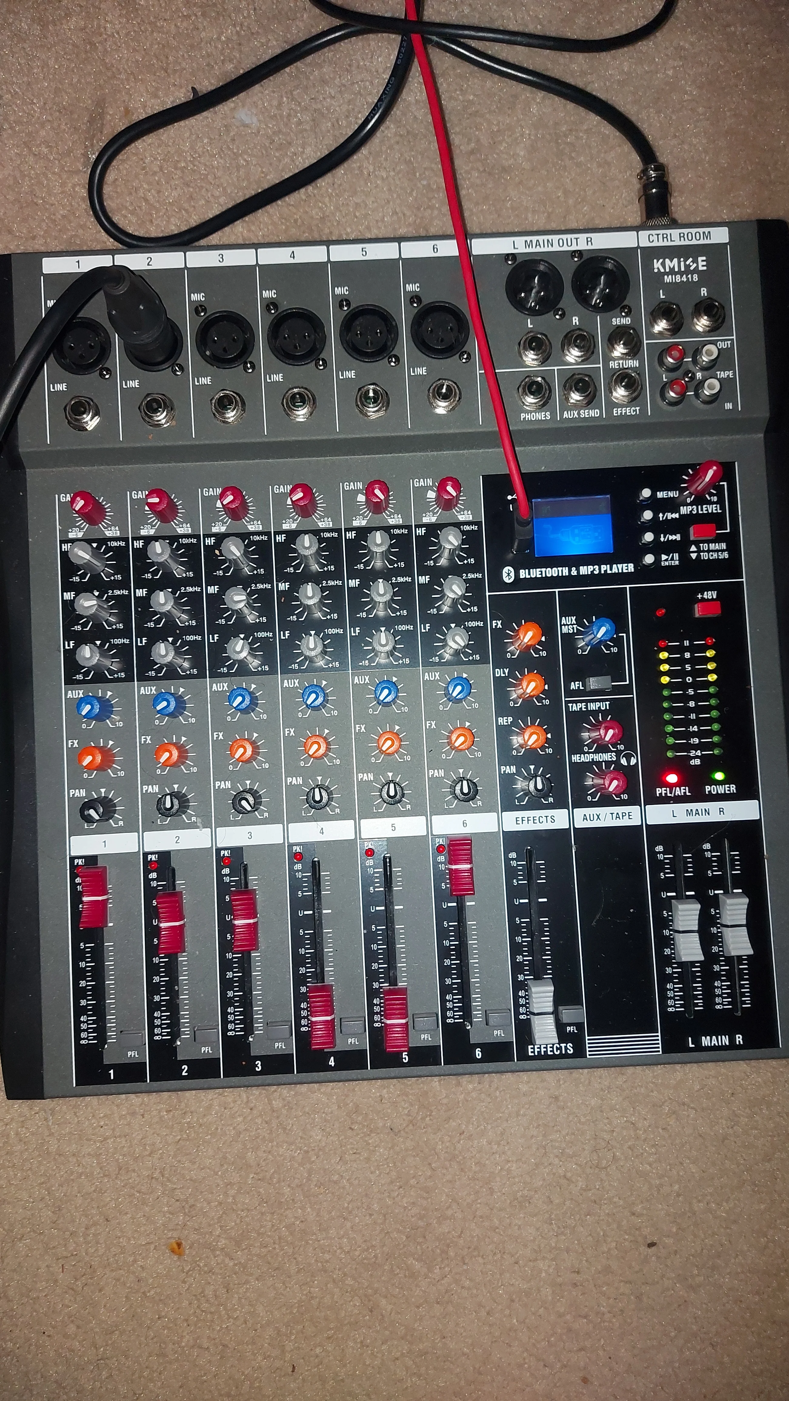

Ok so i was messing around some more and here is some pictures of my setup. Micd to my other speaker the vintage 30. Could that cause any phasing issues vintage 30 + celestion 75?

If the distances of the two microphones from their respective drivers are around the same then, no, you won't have phase issues.
The polarity can be reversed between the two chains at multiple points, though.
The speakers can be wired in reverse, as can the microphones or even the cables.
As I said before, thankfully that can be undone in software and it's very easy to tell if that's what's happening.
Take your two recorded tracks and put a plugin with polarity flip button on one of them.
Play back both tracks together, with both panned centre, and toggle the polarity button a few times.
The combination should sound nice and full one way and very thin and empty the other.

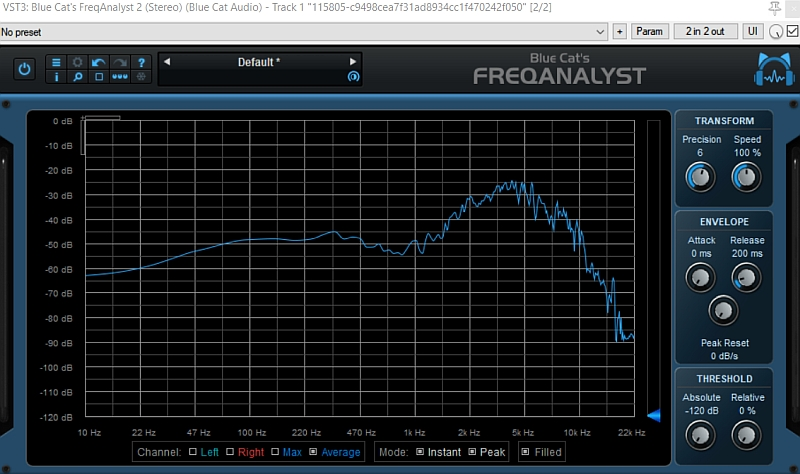

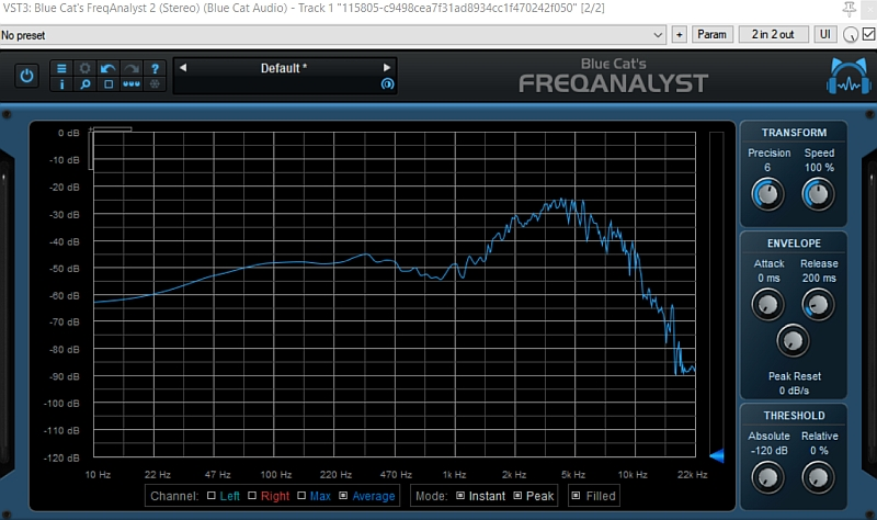

I don't think I've ever gotten a recording that shrill. Barring broken microphones, it sounds like an out of phase situation. You've basically lost everything below around 1kHz! Your sound is centered around 5k, which on a Vintage 30 is where the speaker rolls off about 20dB.
Try one microphone, or if you are sending the two mics to different channels, just turn off the other channel. Pan the two mics to opposite sides. That will easily tell you if there is phase cancellation happening.
