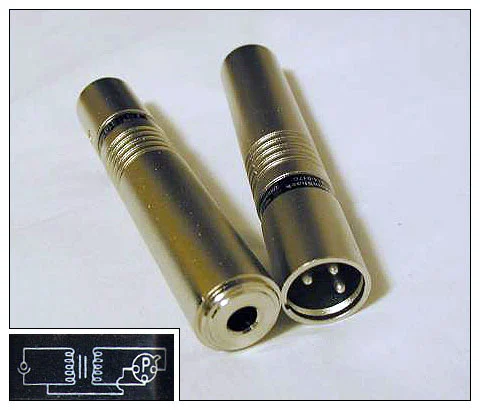

Hello all,
I have toyed with the notion of reamping, but have never actually kept the results in a mix; I simply routed the signal out, miked the amp, then sent it back in. This was a while back that I even tried it, I have a new interface now and a much better ear for subtle nuances in the recording process. What I did before with the previous interface I was using (Tascam US-800) was simply running the signal out of the headphone jack and directly into a miked amp. Again, this was all experimental, non-keeper tracks, and I didn't pay close attention to see if the results sounded natural. I have since been reading up on the importance of matching impedance when reamping, so I did a little research that suggested a piece from Radio Shack to take care of this. Then I realized that I have one of these (pic attached) laying around the studio, I think it was my wife's for some reason. Is this what I need? Would it take the place of one of a Reamp box? And also, should I be going out a different output than the headphone jack? My new (well it's used, new to me though) interface has several 1/4" jacks in the back (pic also attached). Would one of these be the better choice? Thanks in advance.

What are those adapters..?
You basically need to go from line level to instrument level....and match the impedance....for best results.

The problem with your adapters is you will need another adapter to get from 1/4 it female xlr. What you need is a cable with 1/4 TRS on one side and female XLR on the other. Plug that into a line output on the interface and the other end into your adapter. Then use a normal guitar cable to come out of the adapter you have and plug into the amp.
Cool, sounds simple enough…Luckily, I have a cable just like you described, so if it comes down to it, I can easily set that up.

Those Radio Shaft adapters are pretty nasty. Cheap, dirty transformers crammed in there. They "work" to the extent that the give the expected voltage stepping and impedance conversion, but they also add all of the coloration and distortion expected from a cheap and dirty transformer. Any passive DI box would do a better job, but it's completely unnecessary.
