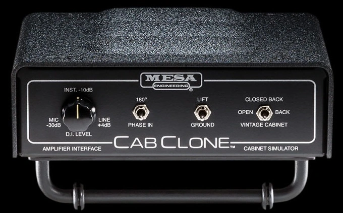

Got one for my birthday/Christmas. Let's me play with headphones with a decent tone.
The line out is pretty decent sounding. Not super loud - almost like It has a limiter. But I'm getting a pretty round tone in my headphones - doing line out to my mixer to test the line outs. Have to record with it still to see how that sounds. It gets warm but not hot and has no apparent affect on my amp head after two hours. Surprisingly the open back setting is my favorite with my LP (I use a 1960 cab). The closed back and vintage have a sort of "blanket" over the highs as compared.
So I cranked the amp up to 11 to see what it sounded like....
I wish it had switchable ohms settings. I'd buy one.
Have you tried the balanced XLR out?
My Marshall has 4/16 and 8 ohm outputs so this one is the 4ohm model. Yeah you have to pick a specific ohm model which sucks if you have different amps.
The XLR and 1/4 line outs work good. The XLR is not as loud but only a few dbs but it is still hot - I had to turn my input gain and fader on the mixer down.
This is way better sounding than my Compensated Line Out on the back of my amp.

I thought you were going line out from the amp. So you're going speaker out, to the cab clone, then from the cab clone to interface. Okay. Yeah your signal is going through the whole amp. So I have to assume that the line out from the Cab Clone is the fizz. I mean I've heard your recordings like a hundred times and I don't ever remember your guitar tones being fizzy. Are you using the XLR balanced line out? Check the manual. One of those line outs might be a speaker emulated out, which is what you'd want to use, and the other might be a straight line out, which is straight fizz.
Just looked it up...the 1/4" line out is NOT speaker emulated.
"Independent 1/4" +4 Line Level “Slave” Output Jack (exact signal from amp's speaker output, non-simulated)"
So I'd suppose you have to use the XLR out for a speaker emulated sound.
There's some sort of level knob on the left hand front too - maybe that needs to be fiddled with to see what happens it only works with the XLR:
D.I. LEVEL This rotary center-detent pot determines the output signal level and provides a wide range of level strength options at the Rear Panel XLR BALANCED DIRECT OUT.
NOTE: WARNING: Playing your amplifier at very high volume (output) levels will create excess heat, produce less than optimum sound, wear your power tubes early, increase the likelihood of tube problems and possibly even damage the internal load resistor. Use the CABCLONE as you would your speaker cabinet. DO NOT USE IT IN PLACE OF A POWER ATTENUATOR (SOAK). The INTERNAL LOAD IS NOT A POWER SOAK! It is intended to allow silent recording at similar volume settings as you would use with your amp connected to a speaker cabinet. Use common sense and preserve your tubes and attain the best sound by using the CABCLONE with your amp set in its lower to medium range. You can clip the power section a little, especially in lower wattage amps, but DO NOT use the higher range of the amp’s power (MASTER) or turn your amp all the way up using the Internal Load.
