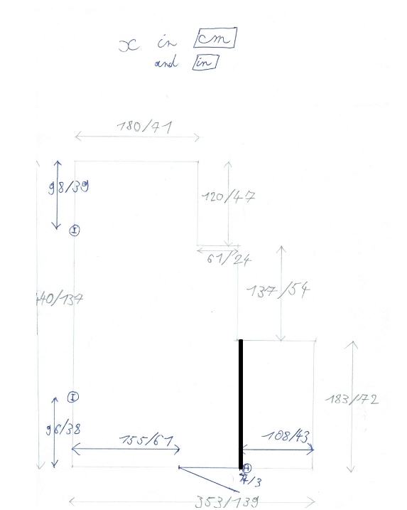

I will include (I hope) a simple plan with the dimensions of the room in 2D.
I live in Belgium (Europe) so I use the head unit for lenghts/distances (meter) but I also included my measurements in inch for all the English/American/Australian? (I don't know exactly who uses what.) people that may read this.
(Actually I'm using centimeters, not meter.)
I'm only 15 years old so don't expect to see an architect drawing. ;)
The lowest number is inch.
The small 'stripes' that are circled are the electrical outlets and the door isn't that hard to recognise I guess.
Thanks in advance. :)

Can you resize your drawing so we can see it all without having to scroll around?
Oh,
sorry. :)

Oh, man, that is NOT a good mixing space! Every internal 90 degree corner will need bass traps (I count 6 PLUS ceiling-wall corners, of course). I guess, if you HAVE to use it, put the desk on the 755cm wall, right next to the door, and try to keep your right speaker as far away from the corner as you can.

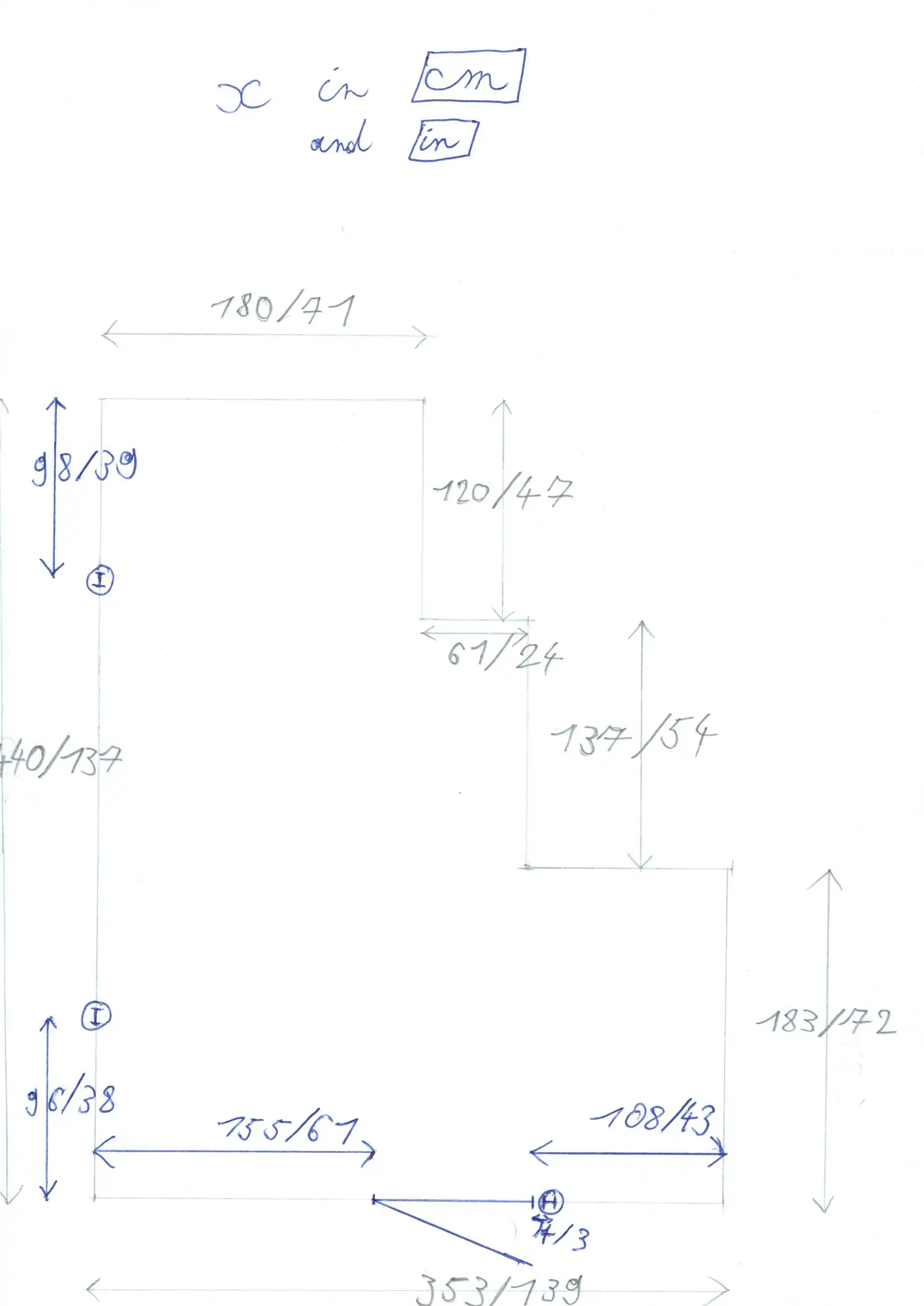

You mean the 353 cm wall I guess?
But there is maybe a possibility to put a sliding/folding door.
Could that make the situation better?
So I actually get '2' separate rooms.

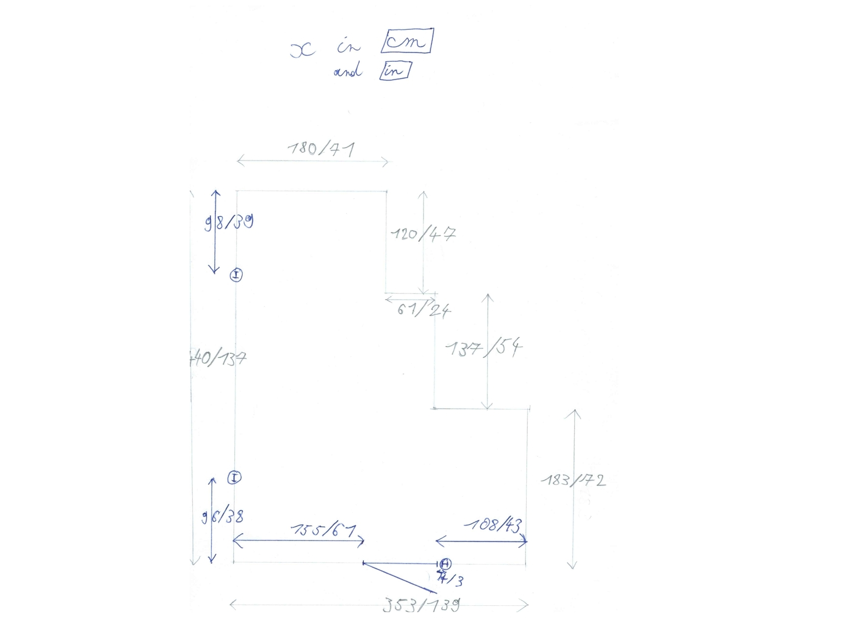

Yeah, maybe. That is a tough one all around. If it were my room, I would probably do that. You need at least symmetry at your listening position somehow. Then treat the heck out of the room. I mean massive amounts of bass traps. It gonna be a tough one dood. But you can make it work for you.
If you could move that door, or at least make the bass trap (full height) there moveable, you will be best off. You really want those corners fully trapped on each side of your desk behind your monitors, equally.
I have kind of the same issue in my studio. A door off to the right wall from my listening position in the corner. I have a 8'X2'X4" bass trap that I scoot over to get to the drum room. It sucks, but it kinda works.
