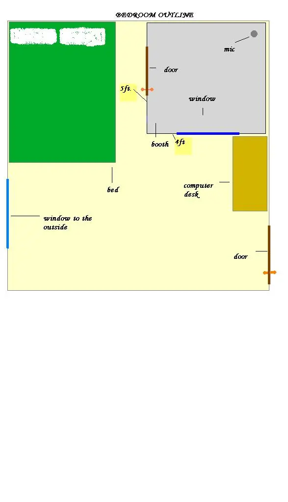

if you did want to go for a size change I could fit a 4x5 booth..If you wanna do that Ill show you a picture of how we could set it(which side can get longer) to fit in the room, just let me know and Im down for it...

so?
so now the booth is gonna be 4x5?? if so lemme know so i can tell you wich side can get longer ;)
I thought you did :confused: Look at the Plan. It shows you. :rolleyes: You've got to learn to LOOK ;)
there.
okay well that would be how i would set it up for a 4x5 booth

yeah kuz i cant let it get closer to the bed..then we can open the door :rolleyes:
thats why im making it longer the other way ;)
