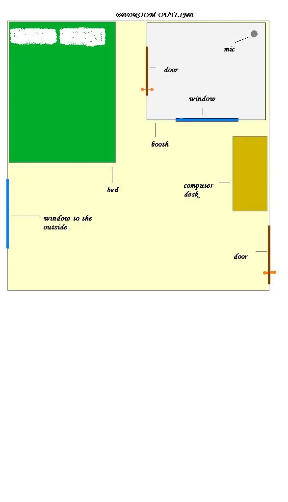

hey rick this is what im going for..i want the door and the window on the booth to be like that..i dont want a window on the door, just that one wall of the booth I put it on..so if we could do that it would be great..you can see how I want to keep the window facing to the computer desk so the vocalist can see the person on the computer and the other way around...thanks again..

Hello Shellshock and guys. Well, I've thought about this project for over a week, and this weekend I'll detail the drawings for Shellshock. But just to let you know where I'm coming from on this, let me outline the criteria for the design SOLUTION. That means, my choice of ASSEMBLY TYPE, material and construction.
Guys, I'm finally going to finish some drawings on some various type BOOTH designs. But its about time to DEMAND some damn "sticky" threads on this BBS.
Every other Studio type forum has them. I don't understand why the mods or owner of this BBS has flatly refused to add these to the forum. Frankly, I've grown tired of posting the same things over and over. No more. I'll post these series of drawings, and thats it for me unless we get some "stickys" :( :mad: :mad: :rolleyes:
Ok, heres the criteria for this design.
1. Isolation goal. To keep vocal sound from transmitting to neighbor below.
2. Due to the existing space being an apartment, this must be a "knock down" design.
3. Budget. Approx. $500 PERIOD.
4. Skill level. Virtually non existant. :( This demands SIMPLE construction/design
5. Tools. See #4
6. Space. Very little.
7. Material transportation. Limited time frame. Meaning imediatly.
8. Must have door/window. Well, I'm not so sure about the window but we'll see this weekend
9. Time frame. Immediate need :eek:
10. Special Hardware. Must be available at Home Depot, as well as materials.
EXCEPT for Rigid Fiberglass, unless Home Depot can order it(I think, we'll see)
11. Precision custom Cutting of materials..not available. Only general NOT PRECISION cutting of panels by Home Depot. ARRRRRRGGGGGGGG!!! Oh well, Shellshock is in for a crash course in woodworking/fabrication. This means detailing ALL the parts so HE can perform this machining/assembly himself. Good greif. :D
12. Maybe more. We'll see.
Well guys, MY goal is to design and post this by Sunday night. :eek: :p
Shellshock, I'm going to send you a list of questions tomorrow morning. I want ALL of them answered by Saturday night. PLEASE.
Well, here goes. Later.
fitZ
